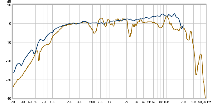

Here FF85WK verse 10F/8424 curves traced from datasheet:

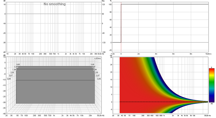

Perfect impulse DC to light speed that would be nice to have as speaker performance because output is then true to input:

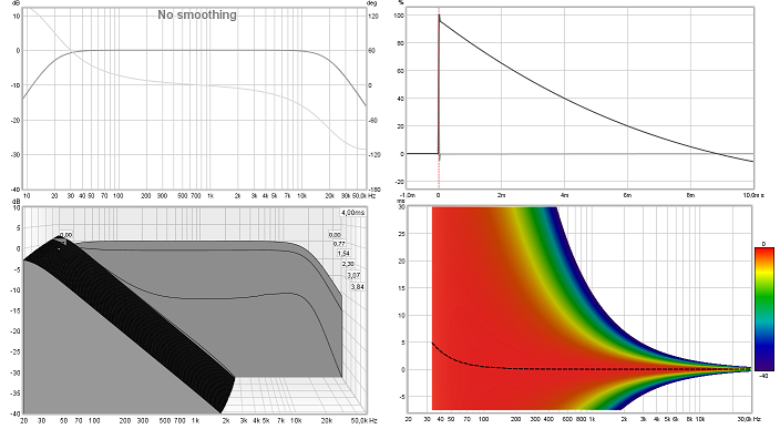

More realistic for speaker performance a perfect band pass with 2nd order stop bands at 20/20.000Hz:

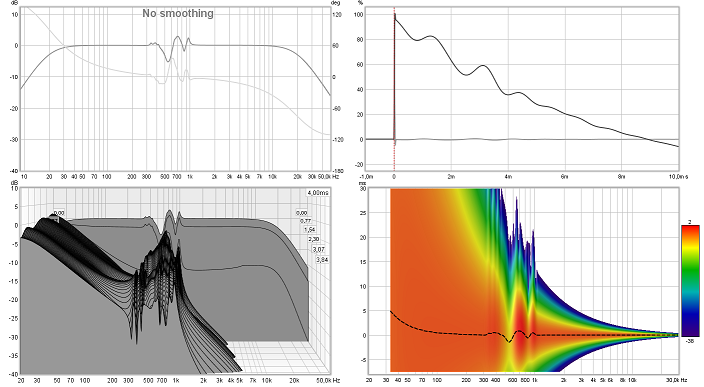

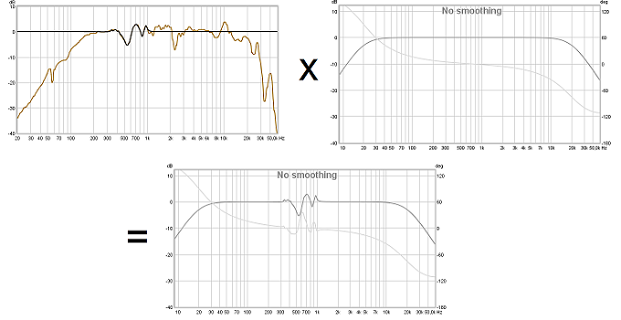

Replica of IRR (minimum phase) errors in area 300-1000Hz taken from FF85WK added to perfect 20-20.000Hz band pass:
Compare this to the perfect one above not only distortion in amplitude domain also time domain, error tails with time lag clear visible into waterfall and wavelet is good also show frq dependent time distortion that is advanced in time:
