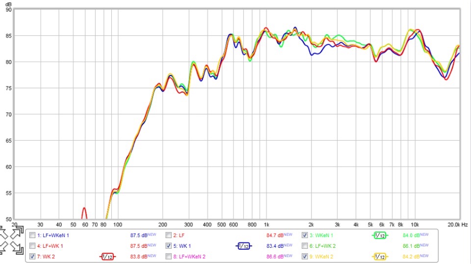

It is strange that making the cone heavier is not decreasing sensitivity. All else being the same, a heavier cone should result in lower sensitivity, right? Can you measure your second pair of drivers also?

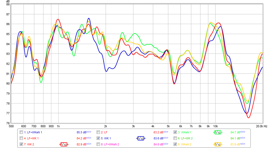

Also, you can see that many of the bumps and troughs are the same in all three drivers. These are not driver resonances, but reflections created due to the setup. For example, the series of bumps from about 1.4 kHz to 2 kHz, the dip at 5.5 kHz, etc. There are others. Note that the bump around 9 kHz is only in the two Fostex drivers, so that one is not setup related.
To my eyes, other than the shelf above about 2 kHz, there is almost no difference between the two Fostex drivers. But this difference will be audible and I'm not sure this pair of drivers lends itself to a good comparison of the effects of "enable."
I was originally under the impression that the only thing the "enabled" driver will have is the dots. If it has other mods, such as damping the cone, and doing things to the surround, frame, etc., then it is not considered simply "enabling" and in which case, we should ask whether it should be part of the test for the audibility of the "enable" method.
Thanks post think you have good points that most the difference is about the 2kHz shelve, much else looks particular baffle system setup related.

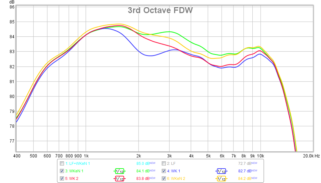

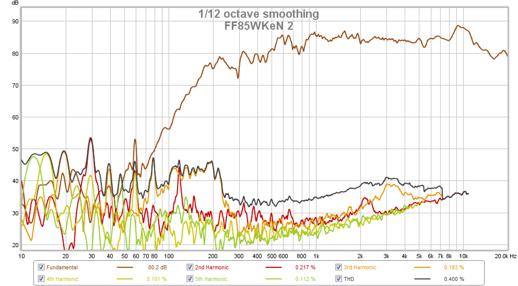

I discovered the cause of my anomalous step response measurements with the FAST setup. I recently switched to a new computer and the on-board DAC seems to have a huge bass boost EQ built in that I cannot get rid of. Using an external USB DAC solved it and the speaker measures very well now.

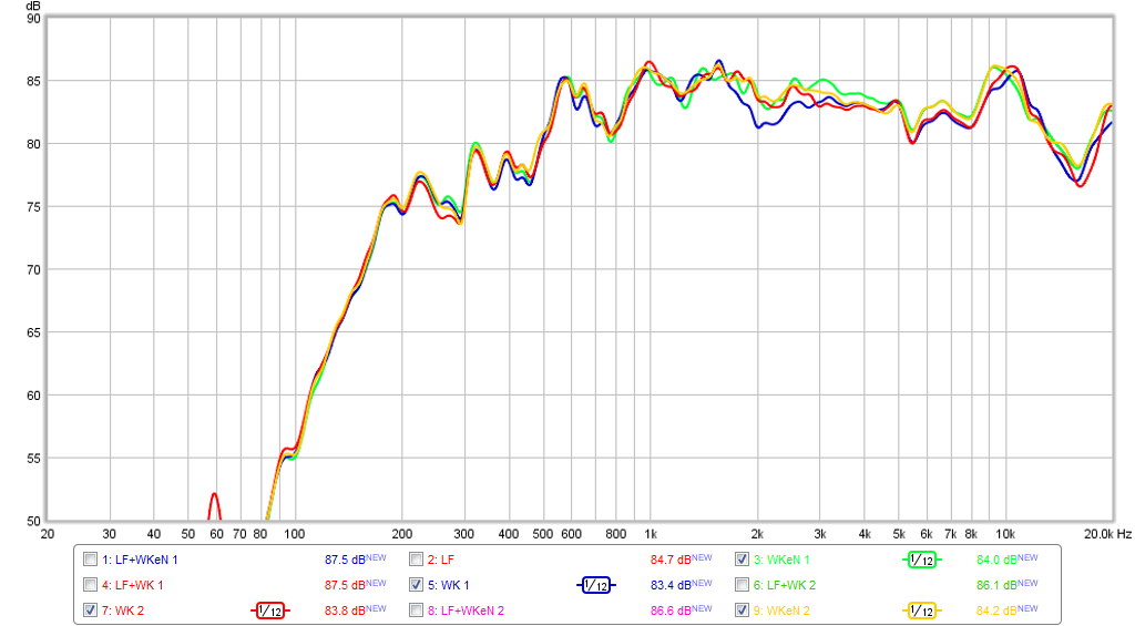

I switched to the UMIK-1 microphone and it seems to bring the HF response up a bit to match the factory curve better. Here is the comparison between both eN's and both stock pristine drivers. It seems the first one is a bit lower in sensitivity that the second. Overall, the Planet10 treated eN's are still a bit more sensitive and have a 10k peak that is shifted to the left.
Measurements taken at 0.5m, with 2.83v excitation from UCA202 DAC driving VFET+ class AB MOSFET amp fed with 300VA 45V linear power supply, passive XO, all taken in same session.
High Resolution (1dB vertical scale) comparison:
Lower resolution comparison over full range:

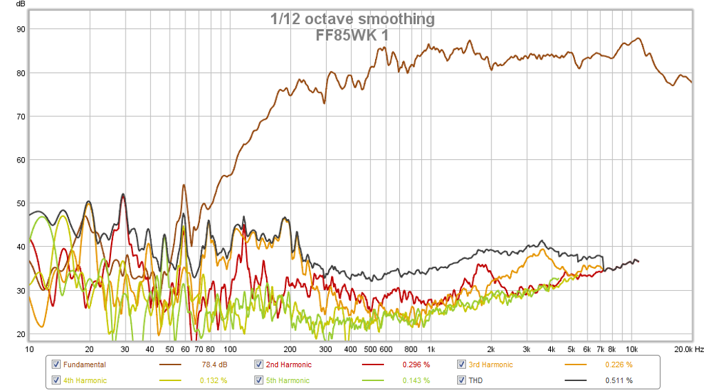

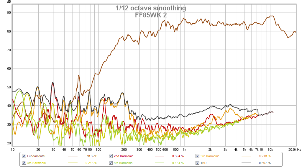

HD of Pristine 1:
HD of Pristine 2:

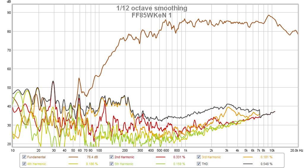

HD of eN 1:
HD of EN 2:

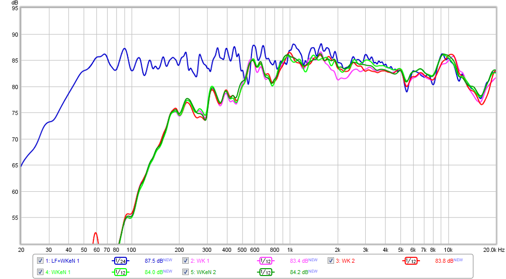

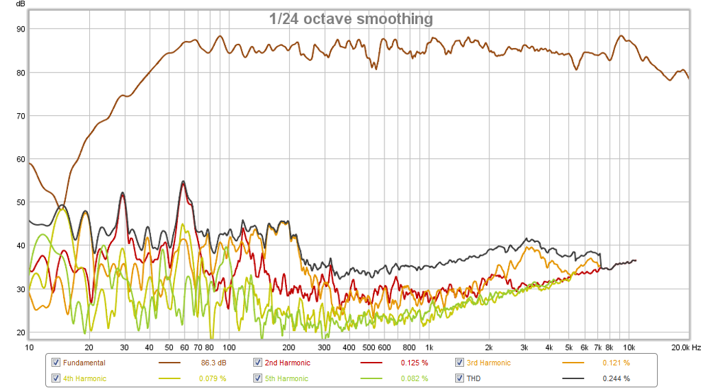

What it looks like with woofer:
What HD looks like with woofer:
HD of Pristine 1:
HD of Pristine 2:
HD of eN 1:
HD of EN 2:

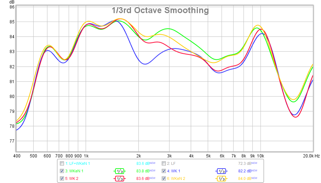

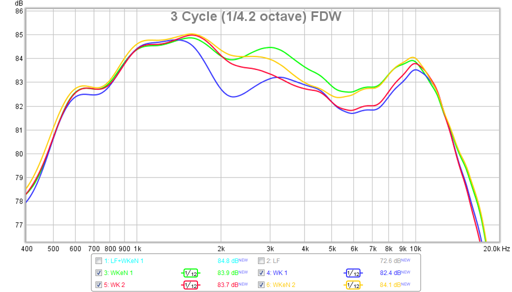

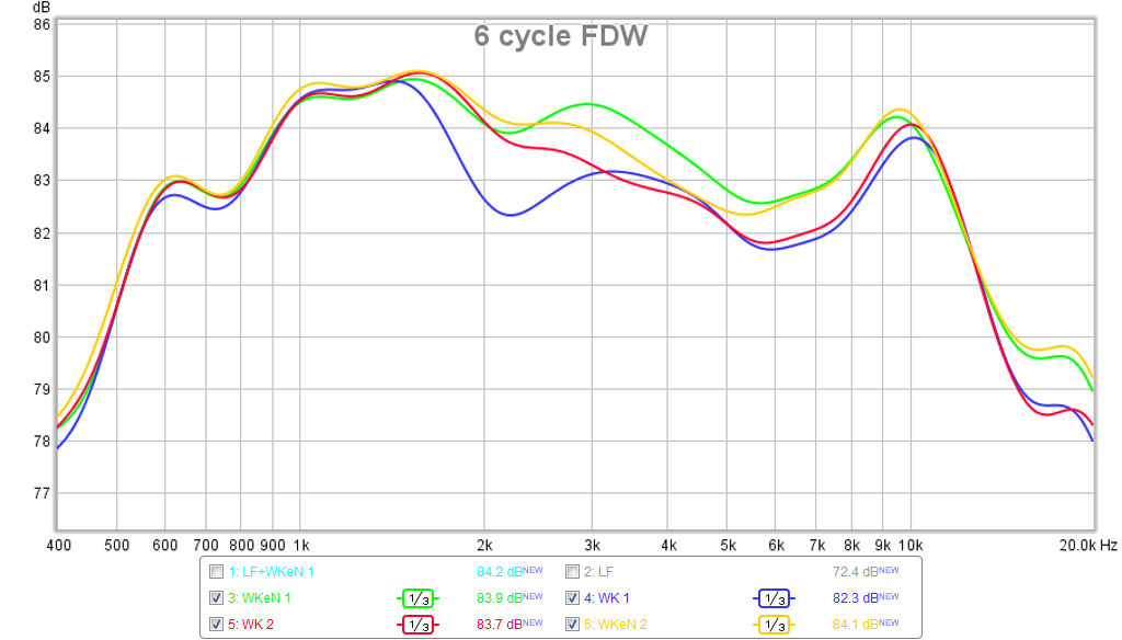

Here is data with 1/3rd octave smoothing, 3 cycle frequency dependent window (FDW), and 1/3rd octave FDW. The latter two involve a frequency dependent gating of the data to remove reflections that occur later in time. But I think the most instructive one is the 6 cycle FDW view as it represents a higher resolution of the effects happening at the driver and not the environment (that is, it can be corrected to some extent via passive filtering or EQ/DSP).
1/3 octave smoothing:
3 cycle FDW:
1/3rd oct FDW:
6-cycle FDW:
I generally use the above for making decisions about what DSP filter to apply. Although in this case it is purely passive, this could be used as the basis for designing the passive crossover without the effects of the room walls.
Looking at the above data, it appears that the first pristine driver is "out of family" with standard FF85WK in that it has a substantial 1.5dB dip at 2kHz. The other unit does not have this, nonetheless, the eNabled ones are about 1dB higher in sensitivity from about 3kHz on up.
