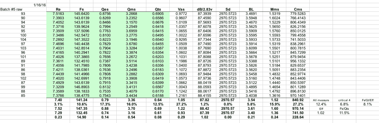

And interesting that your drivers are supposed to lose sensitivity. Do you have any data on the range of sensitivities or Thiele small parameters for the drivers you get in? 2 or 3 db seems pretty significant to be manufacturer tolerances...
Attached is the last batch of 20. Data is measured with S+L WT2. Each driver is measured twice in succession and the 2nd result used. This batch is closer then most (Fostex).
You can see that the range of sensitivities is just over 1 dB.
Sorted by sensitivity.

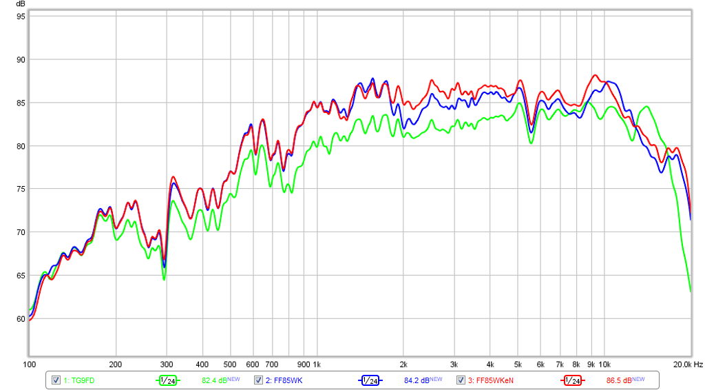

The TG9FD10-8 spec says 84.1dB at 2.83v. If we look at the measurement with all 3 we can see that the TG9FD10-8 indeed sits about 4-5dB below the FF85WK and eN from 1kHz to 1.7kHz. It would appear that above 1.7kHz is where the eN treatment really starts to lift the response up by 1.0dB to 1.5dB even. A significant change that would almost place it in the 90.5dB category sensitivity.
P10 said "The treatment decreases sensitivity by a small amount."
I think we all expected this to be the case but interestingly it was not. Could there be another reason for the lift?
Also note the hump at 10 kHz shifting down in frequency with the dots added.

Yes, interesting. Improved freq response in that freq range indicates to me that a wave reflection null from the impedance mismatch at the cone/surround interface has been reduced. That's my theory anyway, and it makes sense given that IIRC the basic rationale of enable dots is to improve wave termination at the edge of the cone.
were there any other cone treatments applied - i.e. some sticky stuff on backside of cone near surround ? was there a coating applied all over the cone ? - the dots pattern is only the last item usually from what I remember but Dave knows the details of what he did with those drivers.
With very small changes do you need a control sample, at least to see sample-to-sample variation, or variation with ambient humidity and temperature ?
The response from 1.4kHz - 11kHz is pretty flat for the treated driver. I want to know which tweak causes the beneficial lift in response from approx 2kHz upward.

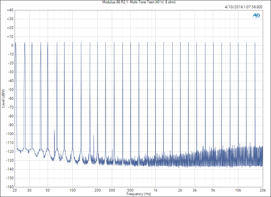

I'm not familiar with REW and don't really know what to expect from the IMD plot either. I'd run either a dual tone or a multi-tone (AP uses a 32-tone signal from 16 Hz to 20 kHz with tones spaced evenly on a log scale). You then look at the "grass" growing towards the higher end of the spectrum. I can email you a test tone if you're interested. You'd need an FFT or spectrum analyzer tool to measure the output.
Attached graph is from my Modulus-86 power amp. Just to give you an idea of what a Multitone measurement looks like.
Many argue that single-tone measurements aren't reflective of actual music signals. I think they have a valid point. A multi-tone IMD test is probably more likely to pick out differences between two systems. That's my rationale for using them anyway.

That's a really cool test! I'd actually been looking for something just like that multitone test to test the amp I'm building

There appears to be a measurable difference in increased sensitivity and smoothness with the eNabled one. This will obviously, be audible in my opinion.
It is strange that making the cone heavier is not decreasing sensitivity. All else being the same, a heavier cone should result in lower sensitivity, right? Can you measure your second pair of drivers also?
Also, you can see that many of the bumps and troughs are the same in all three drivers. These are not driver resonances, but reflections created due to the setup. For example, the series of bumps from about 1.4 kHz to 2 kHz, the dip at 5.5 kHz, etc. There are others. Note that the bump around 9 kHz is only in the two Fostex drivers, so that one is not setup related.
To my eyes, other than the shelf above about 2 kHz, there is almost no difference between the two Fostex drivers. But this difference will be audible and I'm not sure this pair of drivers lends itself to a good comparison of the effects of "enable."
I was originally under the impression that the only thing the "enabled" driver will have is the dots. If it has other mods, such as damping the cone, and doing things to the surround, frame, etc., then it is not considered simply "enabling" and in which case, we should ask whether it should be part of the test for the audibility of the "enable" method.
