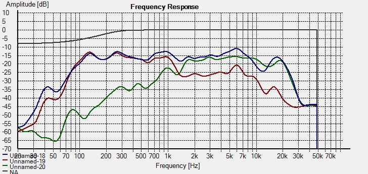

The ripples in the curves are caused from reflections of the nearby monitors and such on my desk and the two curves are just to different smoothing factors.
Basically they are extremely flat and I only used the shelving eq's on my mixer to act as a type of crossover system.
All else is pretty much flat and straight forward.
I have posted in a past thread of a more accurate curve of just the panels with no reflections mucking up the curve.

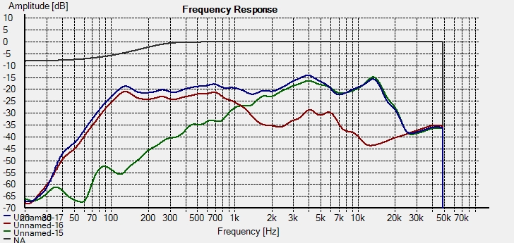

~~~~~~~~~"I found some FR charts today of the system.
The first chart just shows the overall response of the system in RED and the ESL in GREEN.
The next two charts are as follows,
The BLACK line represents the test signal and is set to drop the extreme lower frequency as the excursions with little woofer were quite large.
The BLUE line is the overall combined response.
The GREEN line is just the ESL.
And the RED line is the woofer by itself.
Had this test been in a more open area the FR curve would have been ruler flat.

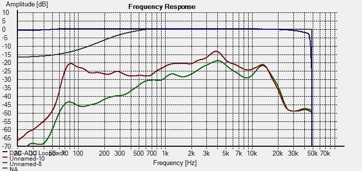

The test was done the HOLMImpulse and a Dayton measurement microphone through a Mackie32-8 mixer and a Gina24 sound card.
The last chart was done with a Peavey PVM520TN.
It is a large diagphram dynamic microphone an has seen its days of use but it is still very flat but does roll off at about 15Khz.
I mostly use it for Bass and high SPL measurements.
