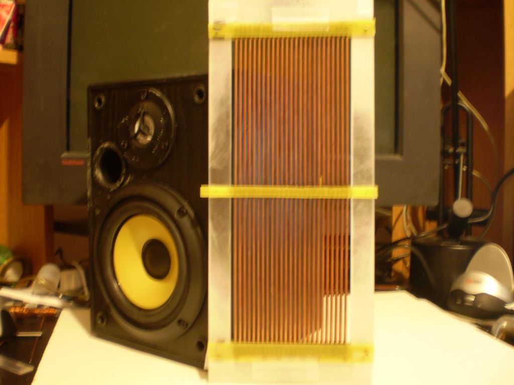

Wire stators are another cost effective method (sometimes) and will allow you to very easily employ electrical segmentation for a wider horizontal dispersion.
Building the frames to keep the wire perfectly straight is quite labor intensive but it is not that hard to do.
I got around this on my latest design by using some Steel TIG welding wire.
I used a .0625" wire as it was all I could find when I got it 10 years ago but there are thinner gauges available now.
Just make sure that they are straight to begin with should you choose to use this type of material

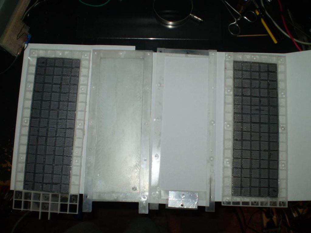

The First and far most important thing is to have a proper stator coating thickness on your panels!!!
This I believe is the main down fall of the ole' 57's as they weren't designed to accommodate today's higher power amplifiers with voltage swings much over 20V to 25Vrms.
Not having enough stator coating is the most common issue that beginning ESL builders have.
There was one DIYer here that followed the same basic dimensions of the 57's but only much taller and they turned out very very nice!!

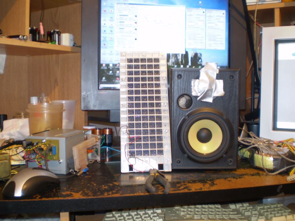

You may have seen these but here are a few pictures of my little panel designs.
Cheers!!
jer :)

To this day I favor my smaller panels more because of their wider dispersion due to their smaller width.

I have also built an electrostatic speaker. 6 cm x 14 cm diaphragm area. I was amassed how well it went. The next experiment may have a diaphragm area of 5 cm x 6 cm. And I can recommend building electrostatic speakers.
I have yet to even approach the problems solved by Quad in the ESL 57 or ESL 63, namely making the electrostatic near full range, (70Hz-18KHz) without it being extremely directional, and the ESL 57 is still quiet directional, but I bet many DIY designs are more so. The ESL 57 has a tweeter/midrange and the two bass panels integrate very well but not perfectly, but the ESL 57 Bass panels are almost indestructible, The Bass panels are fully protected from shorting even if the diaphragm hits the stators but it does not sound nice (You need a greater than 30W amplifier to do this). The smaller tweeter/midrange overcomes some of the directional issues in the ESL 57. The ESL 63 is far more complex, with compression for signals above 10V and hard protection above 50V so making the ESL 63 much harder to damage, but sonicly geraldfryjr's approach to segmenting stators vertically while Quad does this in circles. The newer Quad speakers try to enhance the ESL 63's attempt at analogue delay.
