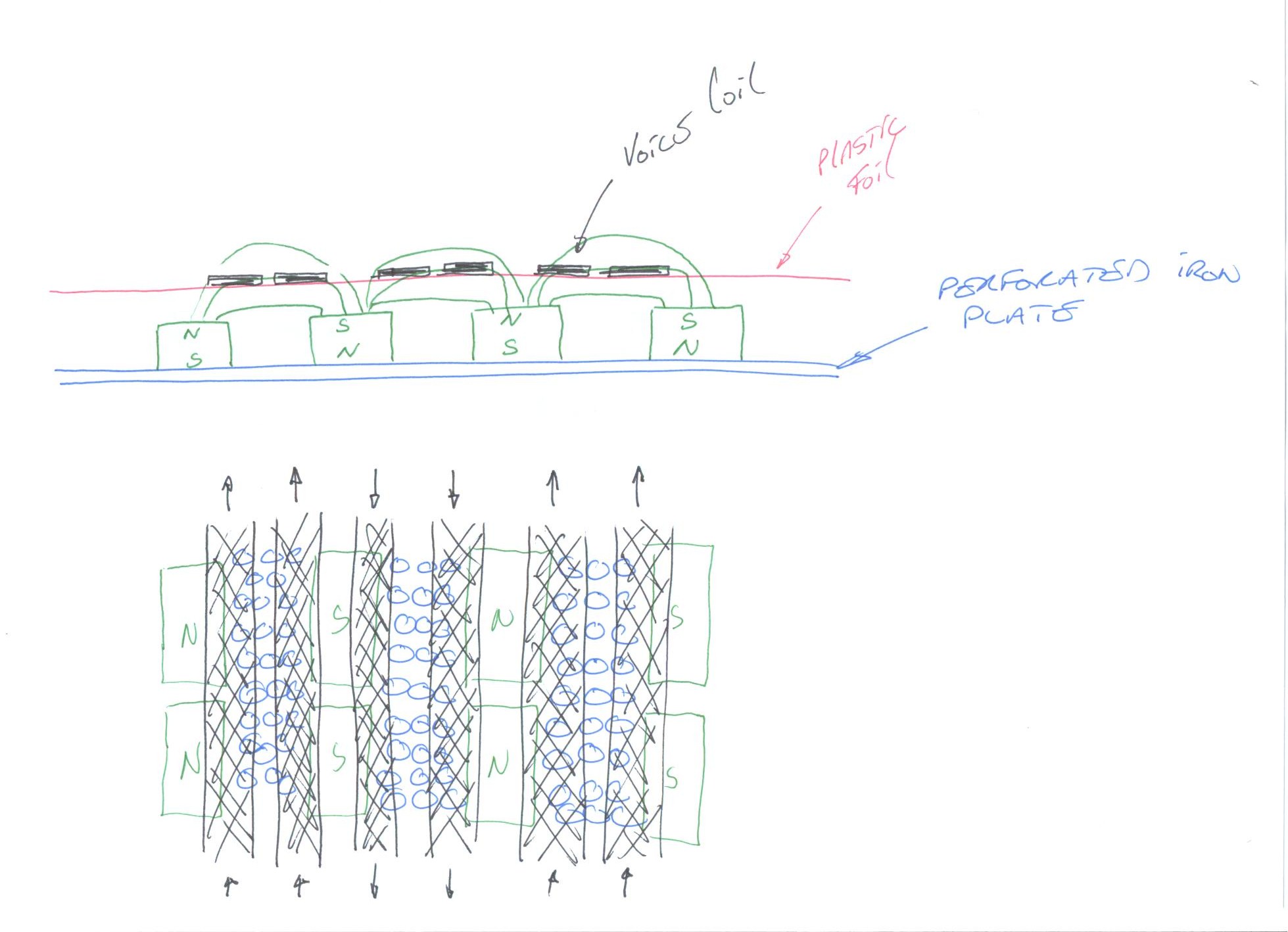

I don't agree with your summation, and to prove the point I have turned the right side speaker around so the back is facing the front . Have also reversed the leads so they are in phase.Both sides are of equal volume so it still is a dipole. So I don't think I have to space the magnets. Unless I am missing something due to my lack of technical nohow. I only use my ears, as this is the only measuring equipment I have!!
you would probably lose sensitivity with a bigger gap as you would have either cut down the number of magnets or make the cut out larger.I shall have to try it with the magnets I have removed from the push pull designs I am rebuilding as single membrane dipoles. As I have found out that there is hardly any difference in the sensitivity, between single membrane dipoles than push pull dipoles. Certainly not worth doubling the magnet count. Even with the 2 membranes.
Look here: http://i.imgur.com/VycM7.jpg
A bit more gap between magnets shouldn't be totally wrong...
Ahh .... no that is not right .....
Placing the magnets NS right next to eachother, will loose big amounts of field "energy" where you would have wanted it ... if you make a FEMM sim I'm sure you'll be able to see that. The field will sort of be creeping from one magnet to the other very low over the magnet surface, and not where the voice "coil" is ....
The amount of neo magnets you use, should make up an enormous sensitivity, but I would gess it does not.
Yes it will be working like a dipole, as there is actually some air flowing to the other side, but the unblocked area to blocked area ratio is quite small.
Henry try to do it like the attached drawing suggest ..... I'm sure you will get an improved result 😉
/Baldin
