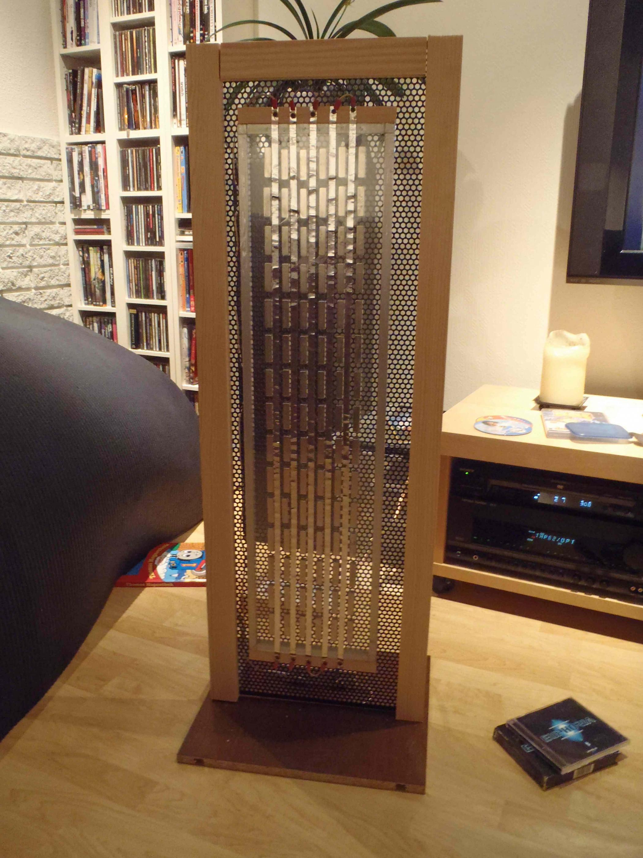

I actually completed one of my planars tonight and listen to it just now!

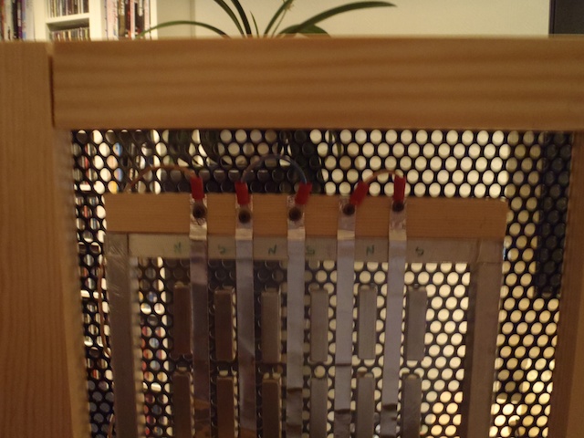

I used the CPC tape, 5 lengths of 800mm length. The resistance is 4,3 ohm in total.
I designed the speaker to use 2mm diaphragm-magnet distance, but during the built the distance was increased to 4mm (doubled the layer of VHB tape)
The frame is a mock-up at the moment, it will be precision made and "self bearing" and used as the frame for the grille cloth.
The speaker sounds quite OK, high/middle range is fine but it lacks a bit in the bottom.
I used 6 times 15 neo-magnets 10X10X40 mm
If I am ever to to build a different speaker, I will use magnets that are "flat" so they won´t try to turn when fixing them to the perforated steel plate.
50 mm long, 10mm wide and 3mm thick would be a better solution for building I think
I will try to measure frequency response tomorrow and post on the forum.

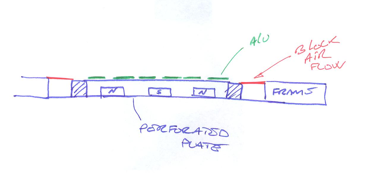

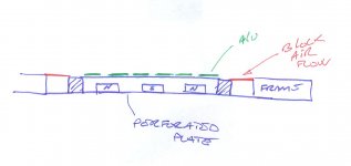

Hi bentl
Looks really good. Congratulations. :up:
Two comments.
1. I think you can get more out of your magnets, and have a more uniform drive on the entire diaphragm. Let the alu foil go over to the middle of the magnets. Either run two alu strips between each pair of magnets, or use more magnets and more strips. This will give higher sensitivity, higher resistance and better drive.
2. To get more and better bass, block the airflow between the outer frame and the diaphragm. You might as well get the most out of the overall size you are using 😉
