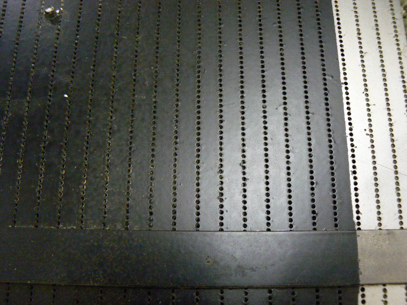

Hello Few,I wouldn't have said that 10% open area is typical based on photos I've seen of planar magnetic systems but I haven't done a careful study. I'm surprised to hear that's what you saw, in fact. I was planning on much more open area (50% or a bit more) and then trying some felt or wool or one of the other usual suspects to absorb some of the high frequencies in the back wave and damp some of the cavity resonances. The openings in Bohlender-Graebener drivers look larger than the ones you've described
In any case, I realize you're talking about high frequency drivers.

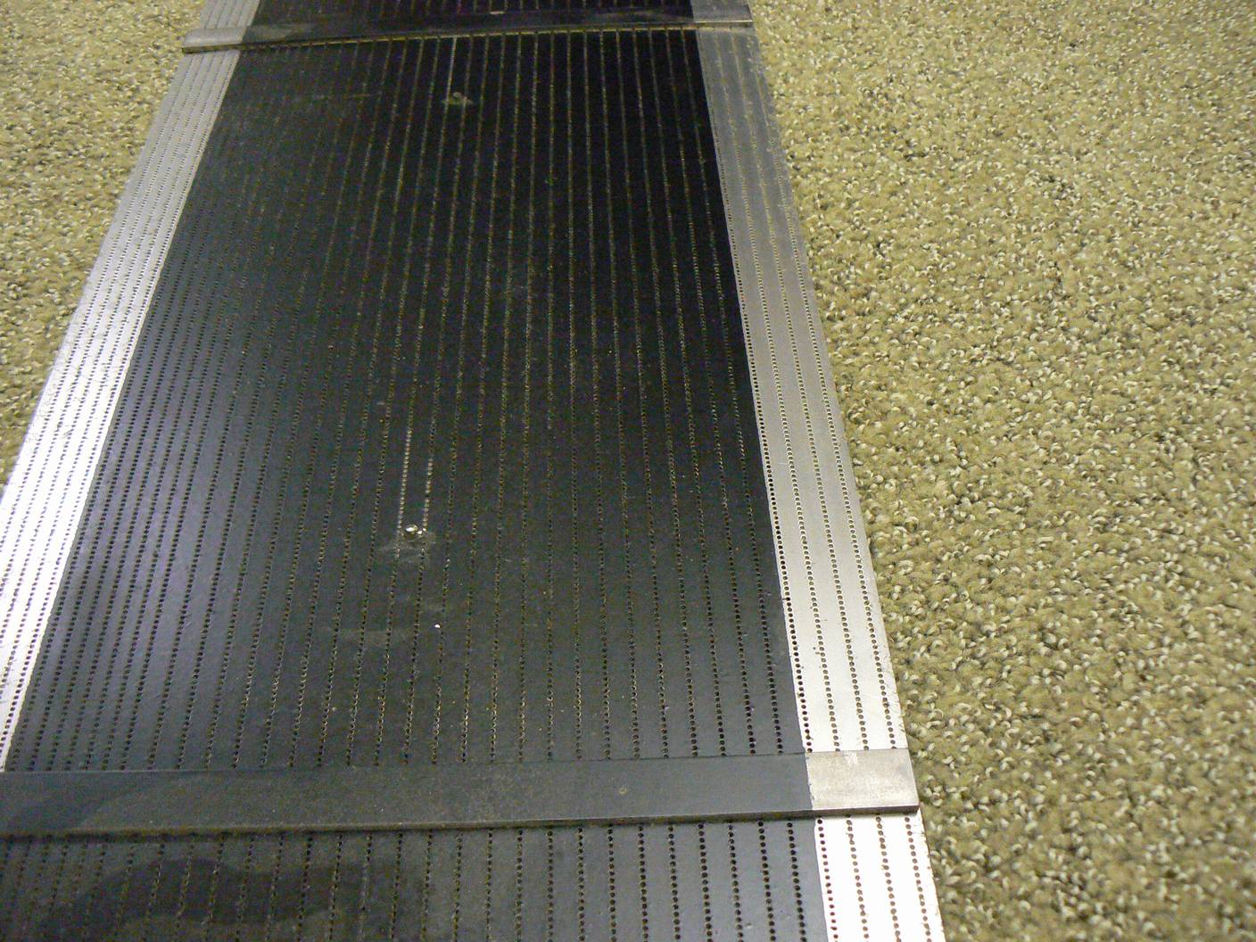

I'm not talking about HF drivers, but single ended LF Magnepan drivers like what you want to use.
I did find my pics and notes from the MMG I repaired.
Calculated open area was right at 10%.
See attached pics.
I also found a DIY post with a pic of a Magnepan Tympani bass panel.
Holding calipers to my screen and a little math gave open area of about 20%.

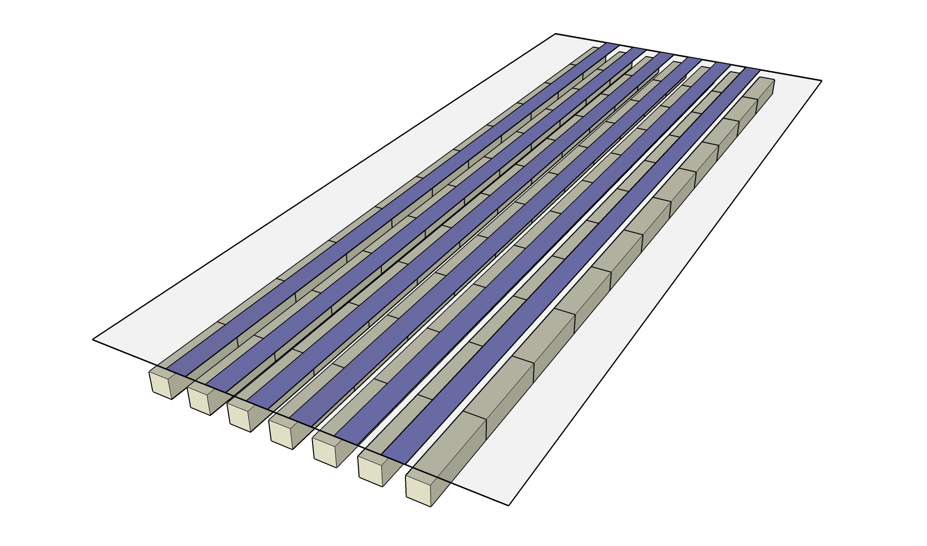

Here are the starting points for my design:
1) NdFeB ("neodymium") magnets: 1" long by 0.25" x 0.25" cross-section, polarized across a 0.25" dimension.
2) Conductors cut out of foil that is 1.5" wide and 5.5 microns thick. I have a large roll of the stuff, and plan to use a rotary cutter and my mat cutter (for making mats for pictures) to cut uniform width strips. It seemed to work well on my first attempt.
3) Perforated steel backing to support the magnets and provide a bit of a pole piece.
My calculations suggest that the foil will yield a resistance of 1 ohm if cut into strips 10 mm wide and 2 m long (10 ohms for 1 mm wide and 2 m long). The driver will likely be slightly less than 2 m tall (roughly 5') so I plan to use some combination of series and parallel connections to get the overall resistance to around 4 ohms. The physical arrangement I'm starting with is shown in the attached figure. It shows 0.25" wide foil strips glued to a mylar diaphragm, suspended above columns of magnets. I haven't shown the perforated steel support. The magnets will be arranged in the usual N-S-N-S- pattern going column-to-column.
I'd like to keep the magnet cost to the $300 territory for each driver, and the magnets are about $1 each. I'm still trying to decide how wide to make each driver (somewhere between 4 and 6 conductors wide) and of course have to decide how much height to give up to achieve the target width and stay within budget. I think I'll start with 0.25" wide conductors to match the 0.25" magnet widths. Some FEMM calculations showed that 0.25" spacing between columns of 0.25" wide magnets is a good starting point.
If I ignore any midrange/tweeter distinction for the moment and consider a widerange design, I could go for four foil conductors run in series, each 0.25" wide and 5' long, and reach the 4 ohm target. This would yield a radiating area that is a bit over 2" wide.
My gut says it would be nice to go for six such conductors instead of four but I'd either need to give up some driver height or start selling cookies to make the budget work. I haven't done any simulations to gain insights into what is gained or lost when giving up height for width, or vice versa. Advice would be welcome.
If I want to do the central tweeter thing I may need to use narrower conductors for that section so that I can reach a reasonable resistance with a smaller number of conductors (to achieve the narrow width necessary for a tweeter). Or, I could try to mimic Magneplanar's "true" ribbon tweeter. I think my foil is about twice as thick as what I'd want for that, though. I think they use about 2 micron thick foil, which would make sense if you want a practical resistance from a 2 m long ribbon of reasonable width.

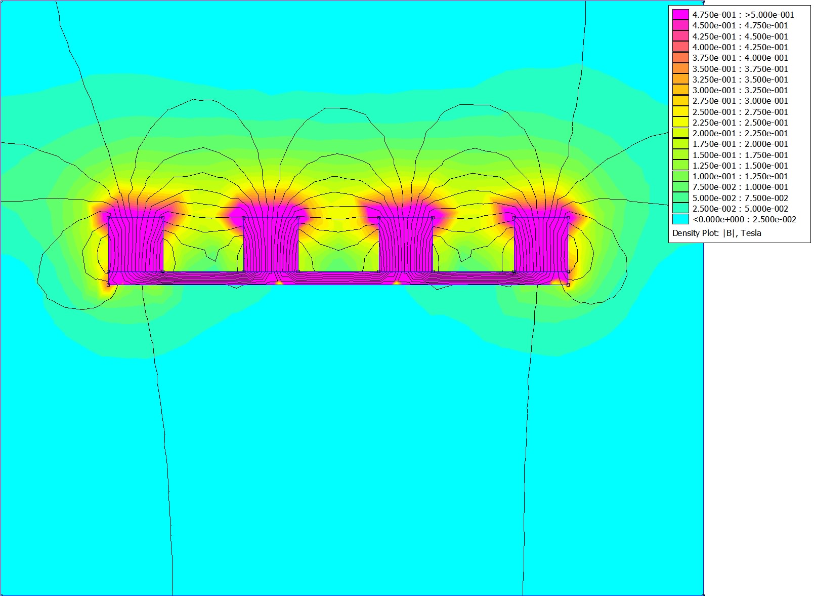

Following up on gootee's concern about the magnetic field lines, here's a FEMM simulation of 0.25" x 0.25" magnets on a steel plate, with a 0.375" gap between rows of magnets. If the conductors were placed about 1/8" above the upper plane of the magnets they would be in a region where there is significant curvature of the field lines, which implies the force wouldn't be in the desired direction.
On the other hand, those following the thread about the Analysis Epsilon repair will notice that the conductors in those speakers are not restricted to the region between magnets. The diaphragm seems nearly covered with conductors, most of which will sit directly above the magnets' faces, not over the gaps between the magnets.
Perhaps the fact that the diaphragm is clamped at the edges means you don't have to worry too much about forces parallel to the plane of the diaphragm because motion in that direction is constrained. Anybody happen to know how important it is to restrict the conductors to regions of space where the field lines run parallel to the diaphragm?

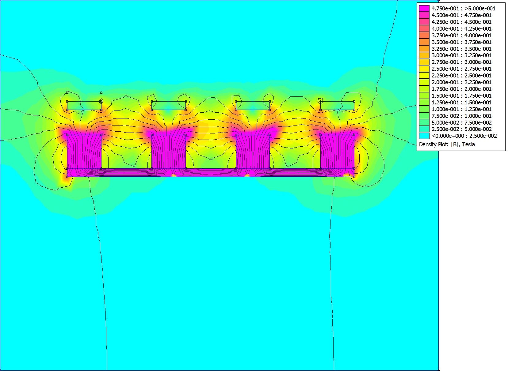

Here's an attempt to find out if thin opposing magnets mounted above the primary magnets can help straighten the field lines without breaking the bank or obstructing the sound too much.
Left: 1/4" x 1/4" primary magnets and no opposing magnets.
Right: 1/4" x 1/16" magnets positioned 3/16" above the primary magnets.
The opposing magnets flatten the field lines. Does this matter and is it worth the extra cost and complexity? Several well regarded manufacturers use purely single-sided designs so that suggests things can be made to work well with a simpler system. The results with the opposing magnets look enticing, though.
