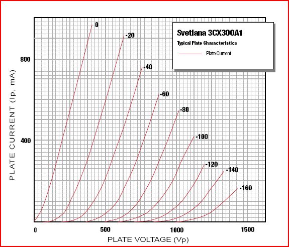

3cx300
3CX300 is a mu~=7 planar triode adapted for audio use.
300W dissipation, if you use forced air cooling, gets you up in the linear part of the curves.
It's rated for 30W using convection cooling (not sure how they do this as Eimac insists on cooling air for their metal tubes even if only the heater is powered)
Also the 3CX400 (8874) is a high-mu planar triode that would work for audio in a local feedback circuit ala Schade.
