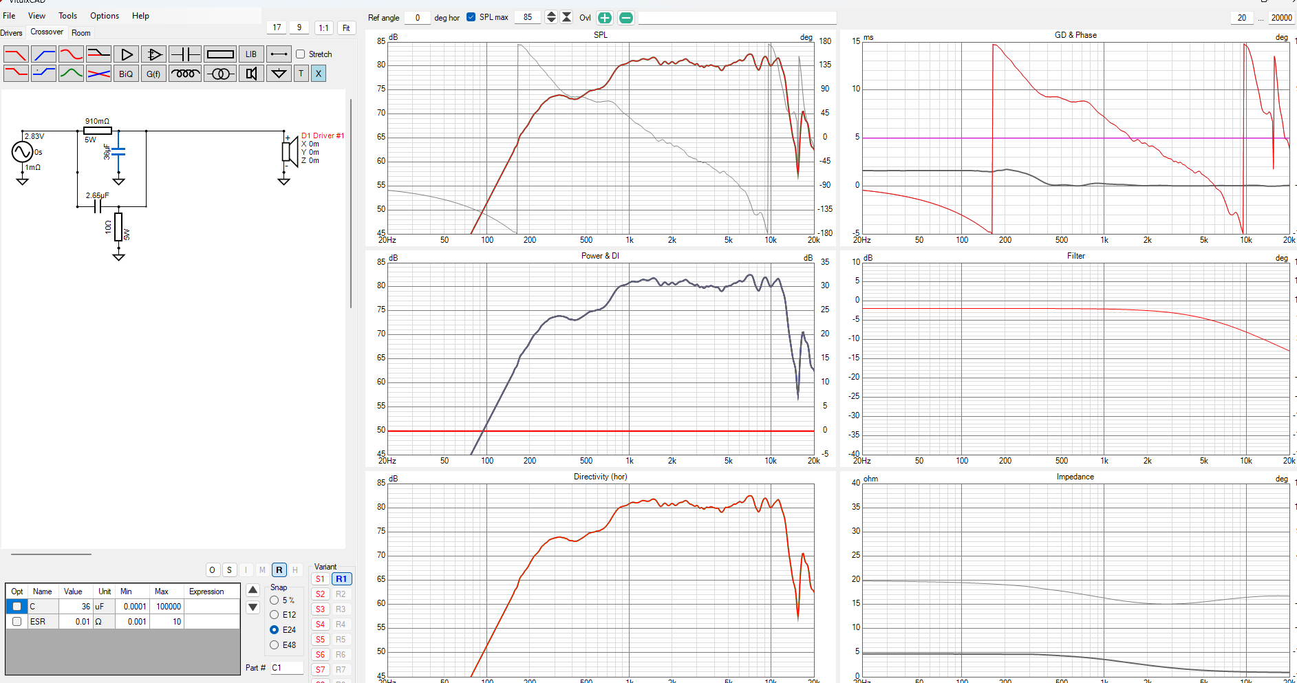

Can you explain, or point me to something that explains, driver phase relationship in VituixCad?I have an example of using an asymmetric crossover to compensate for delay (the part on group delay was part of the other discussion).

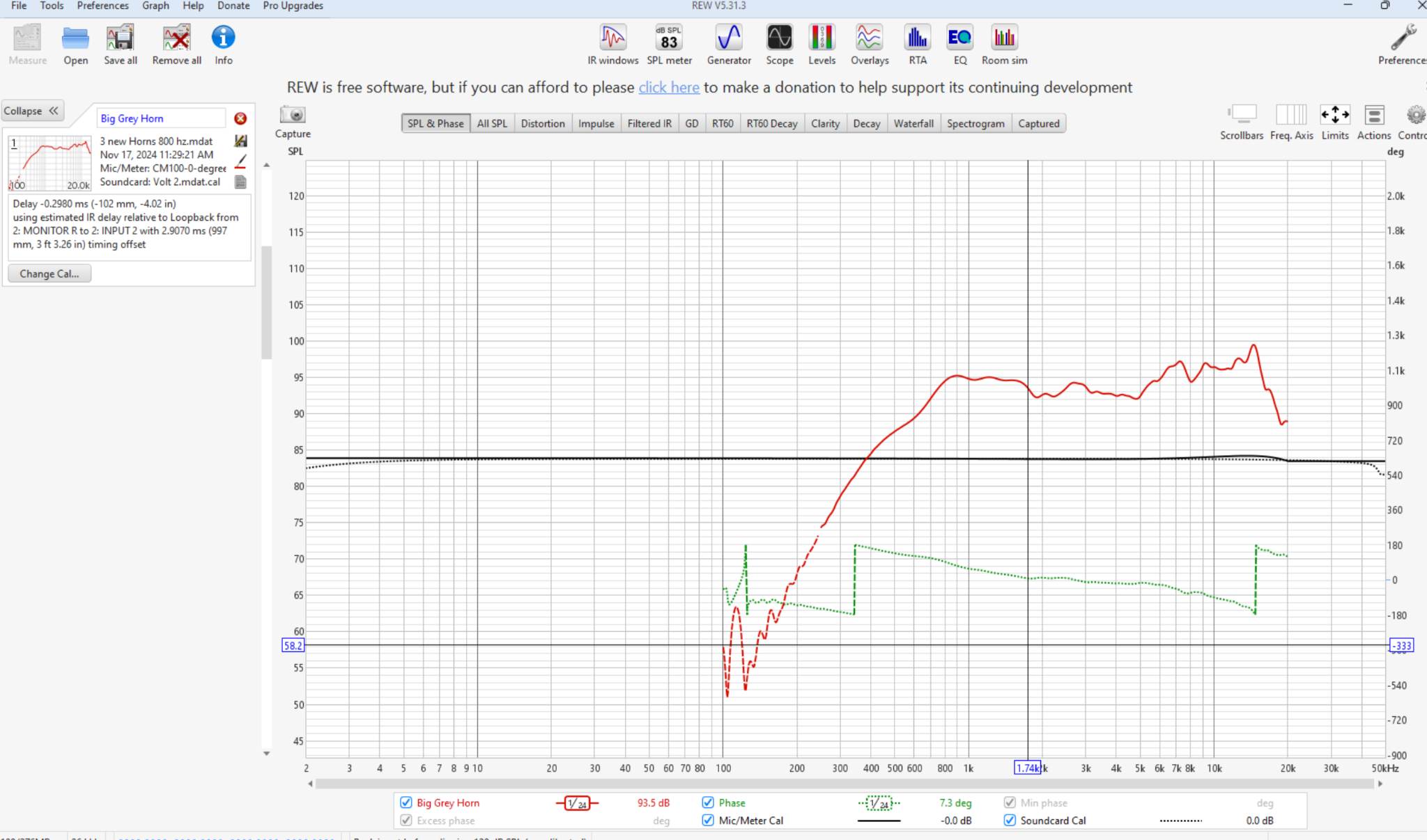

I'm not gonna lie, I don't really understand the phase graph. I do understand what phase is, how it affects the crossover, and how it affects imaging. I plan to keep this nearfield monitor for a long time so I'd like to get the phase right for imaging purposes.
If you cannot read my mouse writing I can actually put text in. I am just lazy and do this all the time at work. Its all engineers so everyone can read everyone else's engineering chicken scratch
Interesting! I understand the 'physics of the situation', yet the measurements don't seem right to me.
Phase between adjoining drivers should normally follow each other. They can be together or separated by a fixed amount, but together is OK for a one measurement per driver crossover. 10 or 20 degrees either way is OK. They only need to do this while both drivers are within roughly 20dB of each other.
The following plots are all showing phase.
Here's an example of a 1kHz second order Linkwitz Riley low pass filter for a woofer (lower trace), then bring the woofer forward by 1/4 wavelength (upper trace, delay added)..

I just don't understand the graph is what I was trying to sayInteresting! I understand the 'physics of the situation', yet the measurements don't seem right to me.![]()
Thanks for explaining. I see now.Phase between adjoining drivers should normally follow each other. They can be together or separated by a fixed amount, but together is OK for a one measurement per driver crossover. 10 or 20 degrees either way is OK. They only need to do this while both drivers are within roughly 20dB of each other.

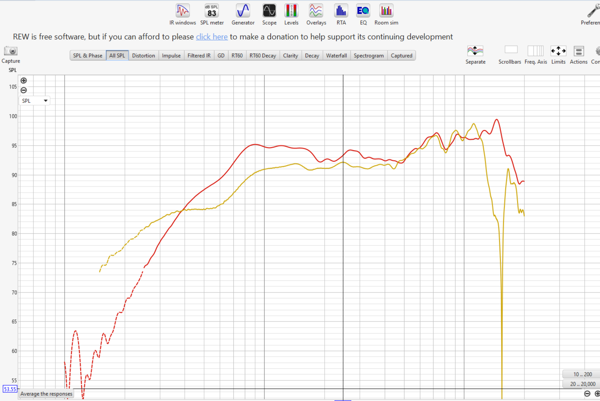

One other question. Here are two graphs. The blue measurement is a total system compiled of 3 drivers and 1 port. I see 4 phase shift lines where they cross over. This makes total sense to me.
The yellow one is a measurement I took of a Zaph 5" driver. I see what seems to be 2 phase shifts. Why is this? This does not make sense to me.
The crossing over you point to with the arrows is nothing. It just means the graph ran out of space and started again at the other side. You can attempt to remove some of this by applying delay.

Yes but not nothing nothing, it's a phase rotation, on a phase graph. It doesn't mean anything other than that the driver does not have a flat response, which of course it doesn't.The crossing over you point to with the arrows is nothing. It just means the graph ran out of space and started again at the other side. You can attempt to remove some of this by applying delay.
