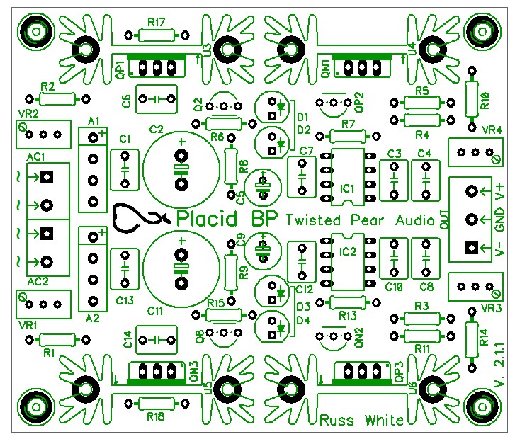

Hey folks here is the schematic and 100% scale PDF for those planning case space etc.
The cct is not very complicated, but very effective. 🙂

To confirm that my system/printer did not scale it (I unchecked those options) The board is ~ 3" x 3.5"?
I think I can fit that in. I'll leave a little extra room around the LCBPS 😀
The Placid (kit) uses FJP5200/FJP1943 devices (80W, 230V, 15A). The only other limiting part are the caps, but they are >=50V. I think you should be fine.

The placid BP is 3" x 3.5" 🙂
The Placid is 2.85" x 2.35". I tried to make it as compact as practical thus the odd size.

p.s. Is it me or is the QP2 in the wrong way round? Hard to see from the picture but looking at the board layout posted earlier, it appears to be the opposite way to the the others, but not in the picture. Could just be the picture of course... or my eyes...

Can't they be soldered underneath the board, the FJPs I mean, and mounted with their backs against the metal floor of the box, or on a thick aluminum plate? That would avoid sinks up to a generous enough current and keep it almost flat for height?
We oriented the power transistors specifically to accommodate enclosure mounting as an option.
The kit will come with 1.5" heatsinks which will be good for 90% of applications. They are a standard part, so changing to 1" or 2" is easily accomplished.

I would wager that this is the part Brian is using:
http://www.aavidthermalloy.com/cgi-bin/stdisp_print.pl?Pnum=531102b02500g
They can be found in heights from 1" to 2.5". The 2" seems to be the sweet spot for lowest thermal resistance.
