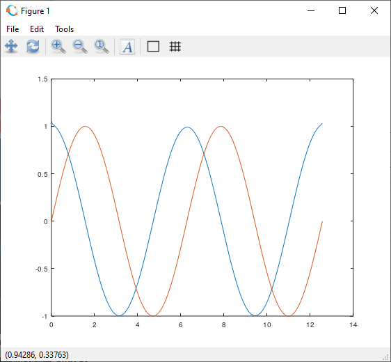

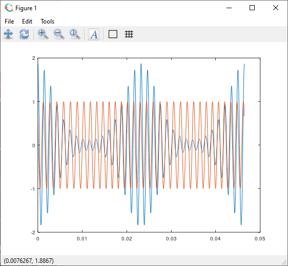

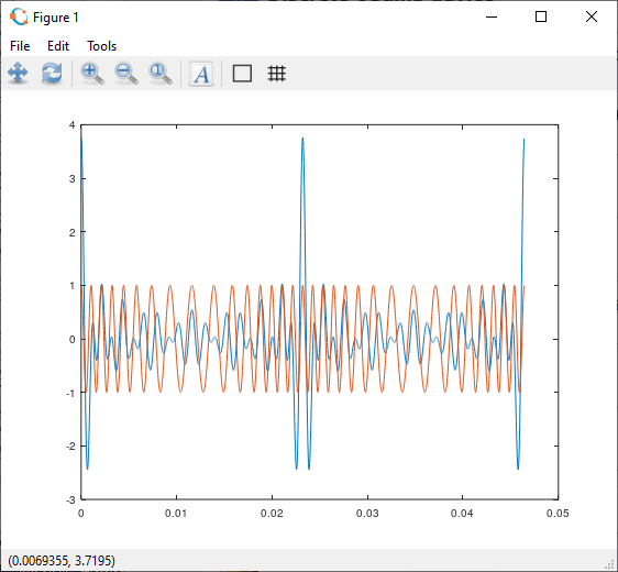

Now that Lars provided the Matlab script for generating the files I took a closer look at the issue. BTW I have not used Matlab in more than 30 years
As some members already pointed out the resulting "AM" file is not simply amplitude modulation between 1.38kHz and 43Hz as after inverse FFT of the phase modulated file there are some harmonics. This can be clearly seen if the modulation index of the phase modulation is increased (3x in this case):
(Red is PM and blue is AM).
So the blog claim "One is a pure amplitude modulated signal, the other is its purely phase modulated counterpart. The carrier frequency is 1.38kHz, the modulation frequency is 43Hz." is simply misleading. As a minor nag the blog nonchalantly calls the phase modulated file "Pure FM modulation".

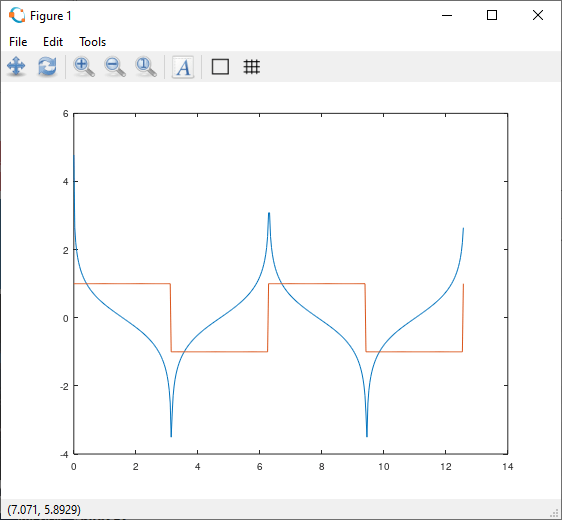

The more interesting bit is the claim that only phase differs. The Matlab script shows that what was actually done is inverse FFT on the magnitude of the phase modulated signal. This is the same as rotating the phase 90 degrees in the frequency domain.
This is what this phase rotation of 90 degrees in the frequency domain does to a sine wave:
Yes, only the phase has changed.
This is what happens to square wave:
B-b-b-but I only changed the phase
My signal processing skills have long faded due to lack of practice so I leave further analysis to others.

As the script clearly shows : on the phase differs. This is of course reflected in the tone domain waveform as well. no surprise there. same for your examples.
pure AM means that there is no FM component. Mathematically this means that the instantaneous frequency (look it up) is constant. A pure FM signal has a constant envelope (instantaneous amplitude) but time varying instantaneous frequency. These concepts are exact mathematical definitions not up for debate.
claim of misleading statement: the FM process adds harmonics side bands as easily seen. the AM counterpart is the AM modulation of a 43Hz cosine with a series of harmonics, this is why the envelope is not purely sinusoidal. We also call a 43Hz square wave for a 43Hz signal despite it’s heavy content of harmonics. The harmonics are introduced as consequence of keeping the amplitude spectrum the same for the two signals. All of this has been discussed about 100 posts back. We could add this explanation of the math facts but that is trivial for people skilled in math and signal analysis but confusing for the rest.
At least we think is was interesting that two signals with the same amplitude spectrum seems to sound different (what does masking theory say here?). That the time domain waveforms are very different is trivially true.
