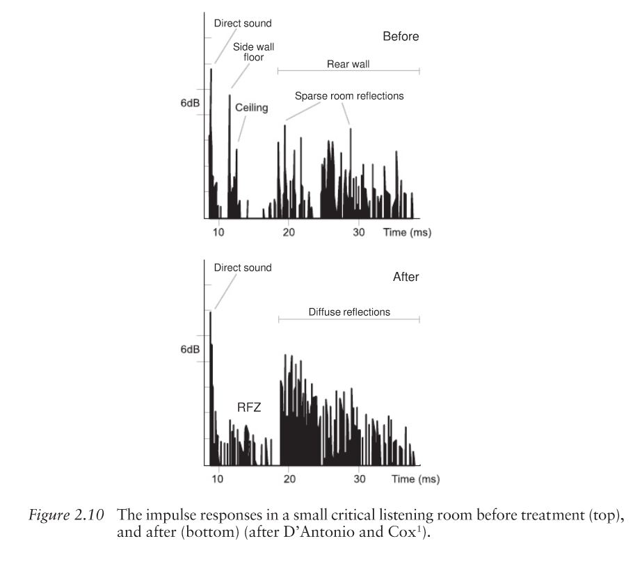

Hi Omholt, can you share more details on how to treat according to ETC graph? Is it by identifying specific reflection (floor, sidewall) based on the time delay in ETC?
Correct, based on time delay. Which can be identified more accurately in several ways, but in easy way is simply to find the reflection points with a mirror, place treatment there and look at the ETC graph again.
How should those specular reflections be treated? By absorption or diffusion? Or scattering in this case?
Scattering is never a really good option. Whether absorption or diffusion should be used depends on desired acoustics design, and geometry and size of room. There's no quick answer here. I personally prefer attenuation early arriving reflection with either absorption or redirection and diffuse late arrival energy. The ETC will than look something like this after graph:
attachment.php
Without looking at an RTx curve, how does one determine if there is sufficient treatment at a particular frequency band? Or if the treatment is balanced across the frequency range? Eg too much mid - high absorption and not enough bass absorption, a common beginner problem?
By using broadband treatment. The knowledge of this is sufficient in avoiding alterering the spectral content. The ETC will show if there's still remaining unwanted high gain reflections. And the cumulative spectrum decay will show room resonances at low frequencies. It's also possible to use a bandlimited ETC to check closer, but it's not really necessary if the treatment one has applied is broadband. A common mistake is using too thin absorption panels and placed at surfaces that doesn't create specular reflections (random placement) at listening position, and have little or no bass trapping. Basically you never can get too much low frequency absorption.
This is a quick reply. There's much more that could be said.

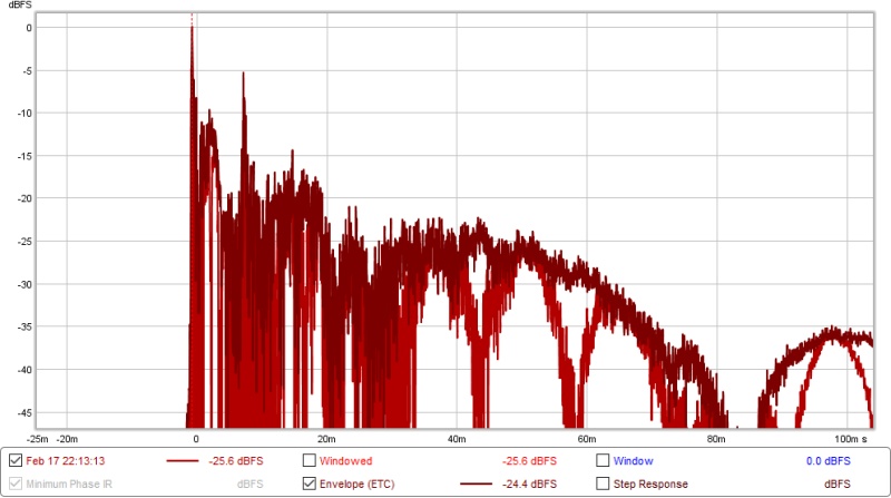

Addition to Omholts good reply; if you add broadband absorbtion it needs a certain width on the reflecting surface, not only thickness. A decorative litlle pillow isn't enough. If you figure out the "offending" frequency with REWs bandlimited ETC, make the width at least 2 wavelengths versus frequency so it covers a wider sweet spot. (At the same time frequencies a bit lower with longer wavelengths get some treatment.) If re-directing with a flat panel/angled wall towards the back wall, I would make that 2 x wavelength also.
Plasnu; I believe it does. You wish to decrease the amplitude of the reflection enough. If the new ETC (after absorbtion / re-direction) shows low enough amplitude at the same time i ms, you are "home" for that reflection. You also get an indication of how thick the absorber needs to be, if you know the offending frequency. If you have info on its air flow resistivity, you can enter this in a spread sheet / calculator and calculate backwards for required thickness. Often the manufacurer has absortion coefficients for various thicknesses too. (OK, these are usually measured from many angles in a reverberant chamber and not from one specific oblique angle, but you get an indication at least.)
