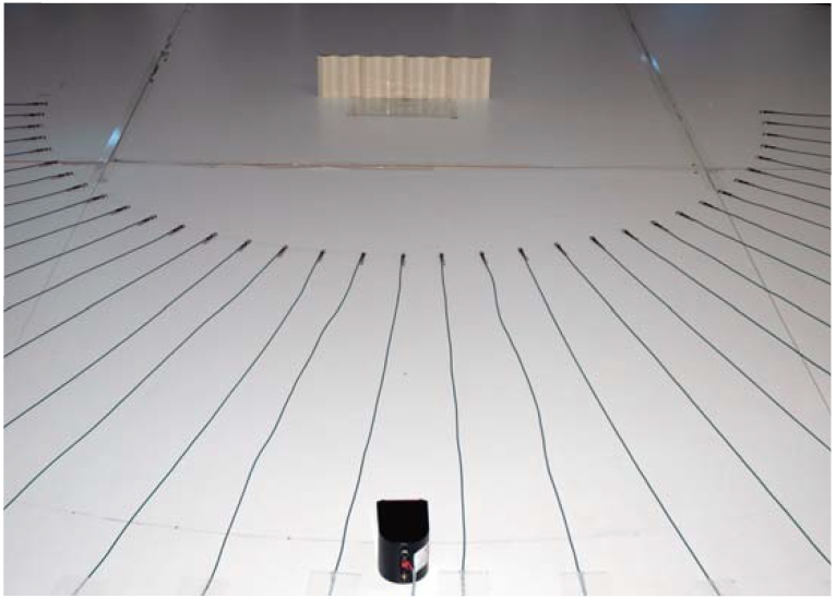

There's a difference between scattering and diffusion. Scattering simply implies that the energy is distributed in a non-specular direction, but the energy isn't evenly distributed and will focus certain frequencies in certain direction.earlier you commented where these diffusors may scatter more than diffuse. can you explain that more
Auralex Acoustics | T’Fusor? 3D Sound Diffusor
Diffusion on the other hand is a uniform distribution of the energy, which which will color the sound far less.
There really should be measurements of both and a diffusor shouldn't be measured alone but with several units together. Like what you see in the picture below.
A product like the T’Fusor with a surface that changes with wells in different directions is very unlikely to offer any proper diffusion. Also, the depth of the wells in the diffusor will imply how low in frequency the diffusor operates. Shallow products, like this one, is incapable of offering scattering or diffusion low in frequency. Thus it will be very bandlimited, hence change the spectral content to a greater degree.
