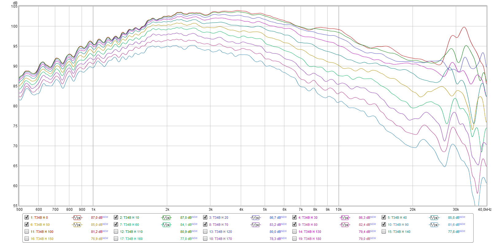

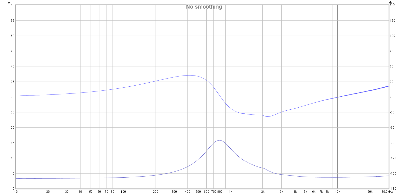

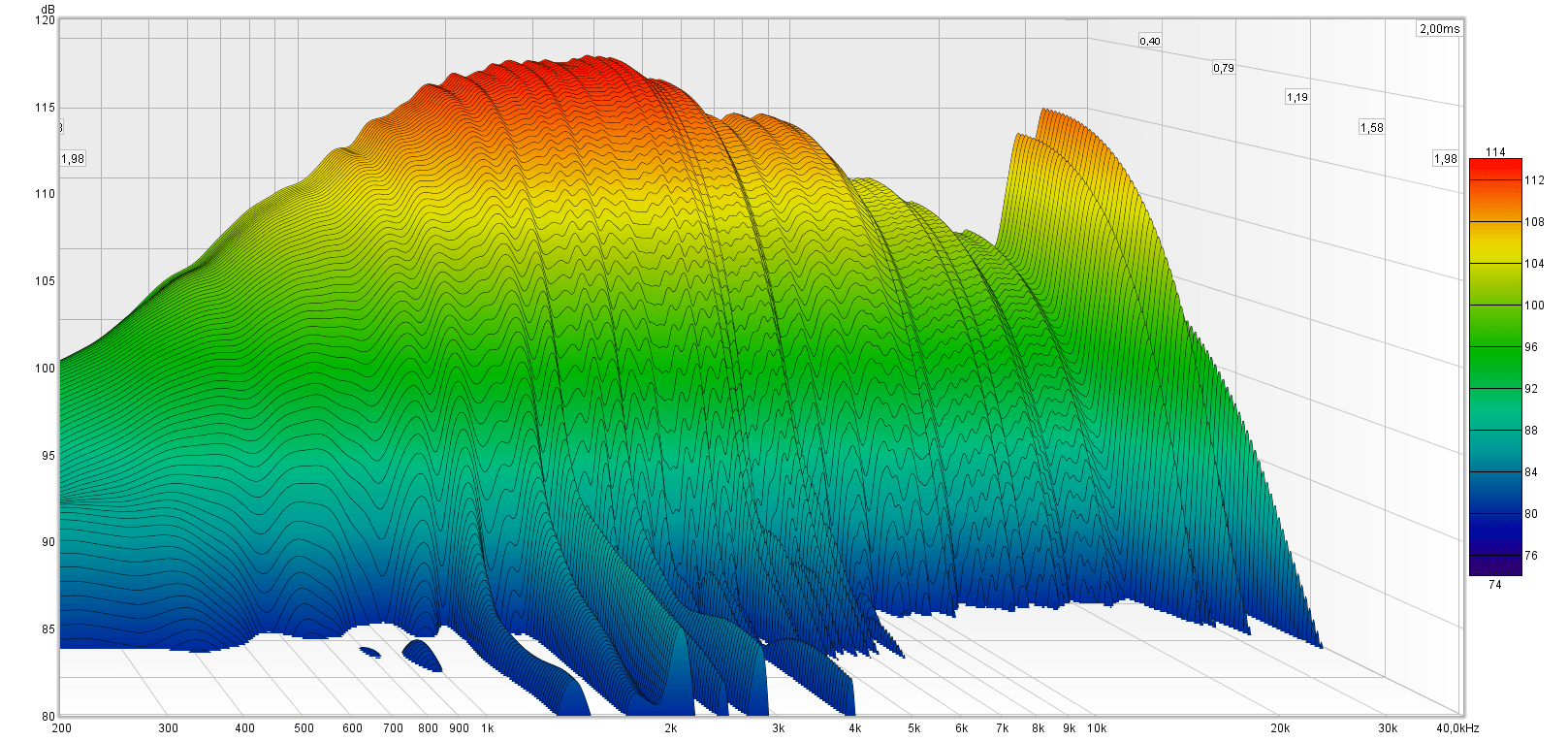

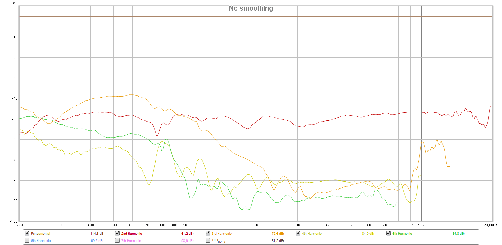

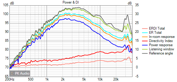

From time to time I get request for the details of this waveguide so I created this thread to share the details, and to see the experiences and measurements from those who used this WG.
I can share STL/STEP files for 3D printers via email on request.
This WG was used with Bliesma T34B, all measurements are in the attachment. Measurements were taken in actual baffle of Ellips-A project.
