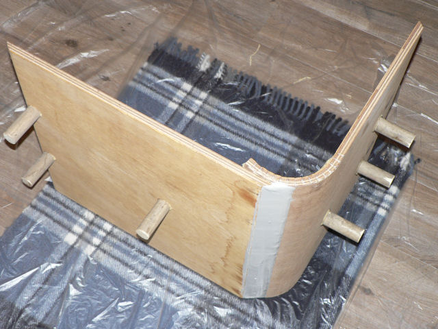

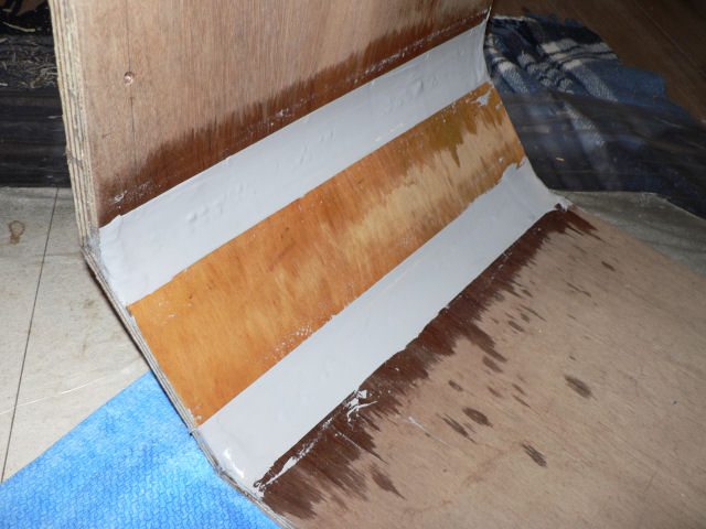

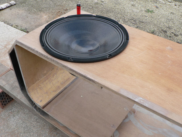

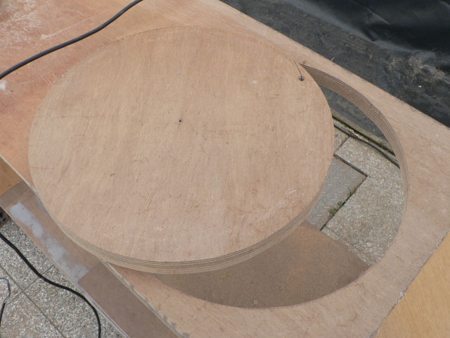

Did the rounded port now, had to start over 4 times trying to get it right!
You can see at the short side of the bend, it didn't pull close.
Elastic band isn't working good here either.
The darker color is from wetting the wood for an hour, to get it flexible.
Inner radius is 110mm (4.33")
Four times trying again later:
Pulling from under a strong piece of aluminum helped a lot, this way the pulling is about equal at both sides of the bend.
Not perfect but I left it like this. Tomorrow I'll see how it holds up...

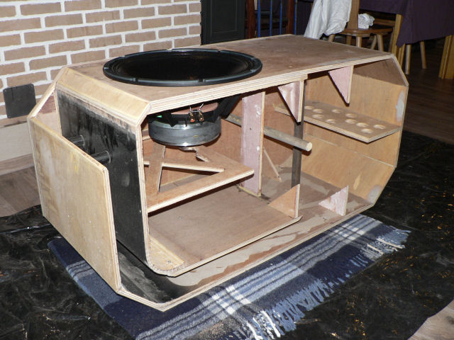

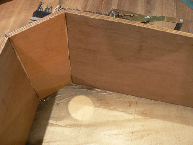

Just had a look and thinking that this is a 'test box' it's pretty complicated...
Placed the port in the box and it doesn't come out very well.
If I place it at the 75mm distance then between the curve and the 45° angle there are only 65mm.
The back wall is about 88mm from the curve.
It's also 'over curved' (more then a quarter circle) Guess I thought it might return a bit to it's original state but no, it didn't move a bit when releasing the five bands.
hmmm, I'll have to find a fix for that.
It was to be expected that a diy curve wouldn't be perfectly round.

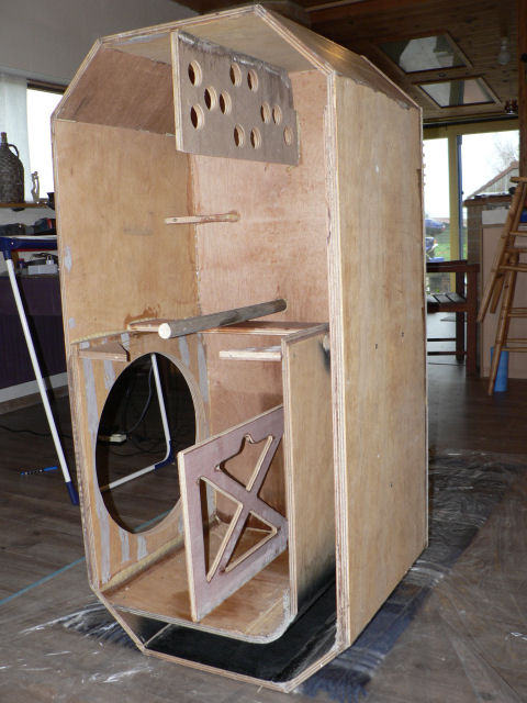

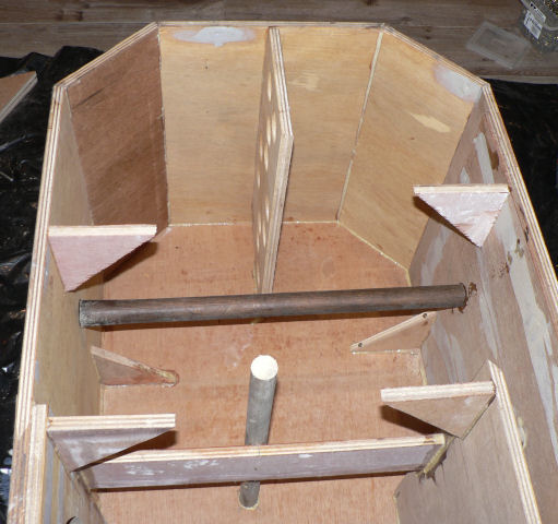

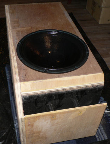

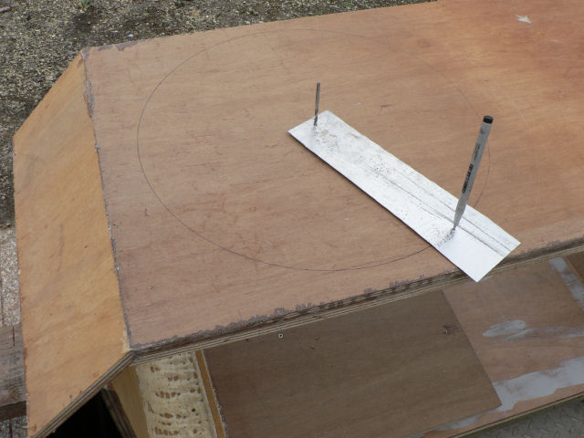

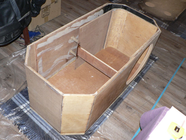

Had a few other things first so this is not progressing as wanted but almost there.
The port needs to be opened and a few extra braces here and there from leftover sheet.
Before I close up the box forever, input is most welcome! Probably will glue the table top on Tuesday.
Idea's on the finishing tough of the box? I would like it to look not too heavy, blend a bit with the floor or surroundings and maybe even difficult to see that it's a sub.

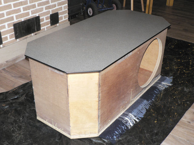

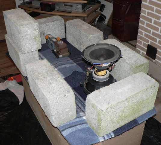

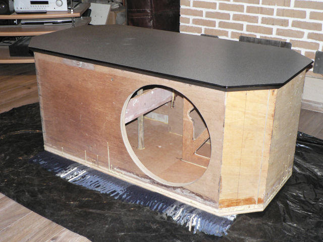

Everything is glued. Weighed the top down with about 300 pounds concrete blocks and a few other things.
I hope to put in the woofer today and throw in a cable through the BR duct to have a quick listen/feel.
For the finishing of the outside I would like to use some sort of paint that covers small irregularities and sticks very well, because I would use it to glue fiberglass wallpaper at the same time.
Then paint it mat black. What do you think about this?
Connection will be at the bottom, there will be shallow feet with felt to protect the floor somewhat.
SUb works now, have it hooked up to a 100W amp.
Will have to experiment and do a quick measurement on impedance for my own peace of mind.
to be continued...
to be continued...
Honestly?... a bit on the thin side, I guess the amp should be bridged to put out 600W in to 8Ω. Now I'm using one channel so only 100W @ 8Ω
Bridging involves opening the amp and change a few things/wires. Have to dig out the plan, it's a DIY amp from Velleman.
I wouldn't say I'm disappointed because there is no tweaking/tuning what so ever but I thought I would have been pleasantly surprised...
If I listen closer to the woofer it sounds very powerful, effortless. The port doesn't put out much sound at all so I guess the tuning is indeed lower then most music puts out, that's a good sign.
Haven't had much time yet to test/experiment.
Any pointers?...
