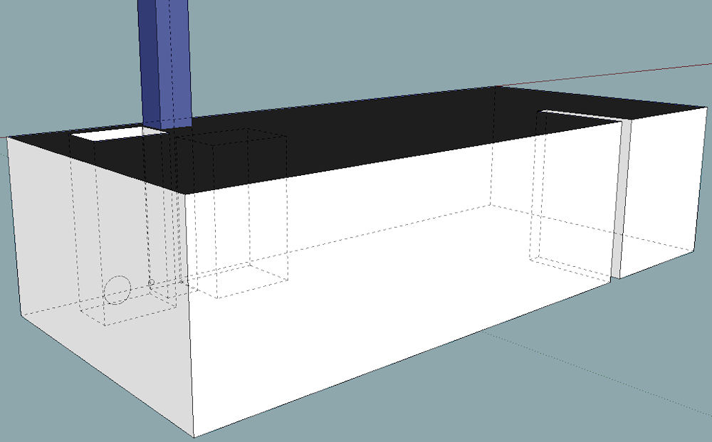

Pivoting TV-stand/HT-sub/stealth corner
Did an impedance measurement.
tuning is at 17,5hz
A bit lowish for this driver. I might put something in the box to lower the volume and so up the tuning...

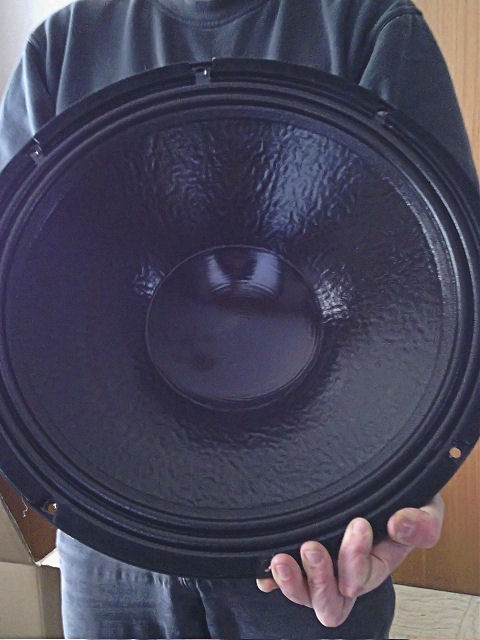

In the mean time the driver played music for a few hours.
At first the sound was thin and a lot of upper bass because I set the amp at +4dB (sub in the center of the room)
Gradually I had to turn down the sub. It's now at -6dB! And the upper bass is much more in line with the rest of the sound.
Didn't know the break in would be so drastic. Is this common?

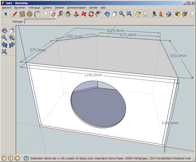

A bit more experimenting will be done (time permitting) before I add more bracing, to reduce volume. This to change the tuning to 19hz.
