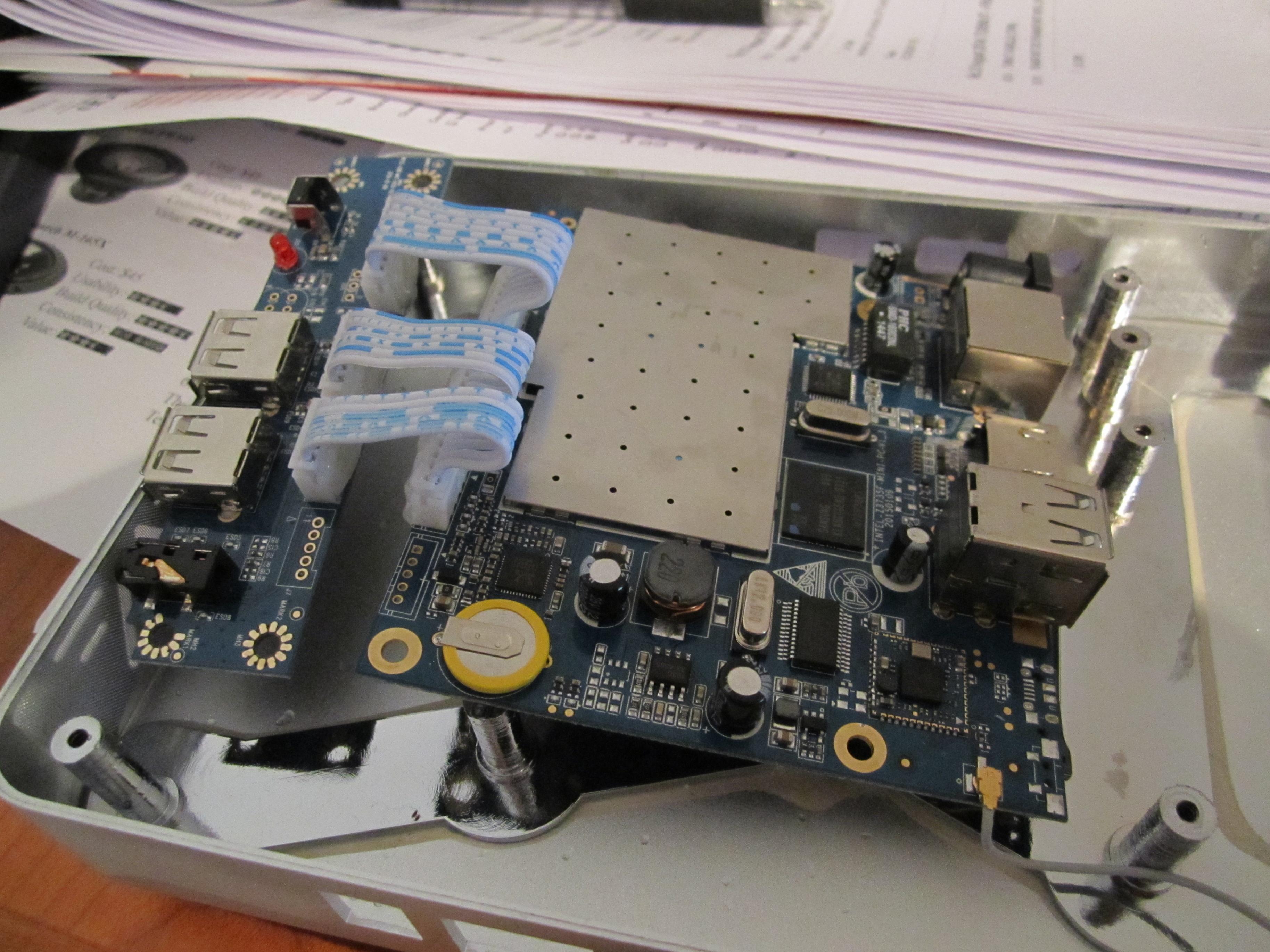

Problem is that the cpu tends to get hot. I reach 80 C during normal use and i guess this is too much for reliability.
I am attaching a picture of the board (the cpu is under an aluminum lid without heatsink).
The space between the board and the top cover is very limited.
Any idea about how to cool this cpu down a little ? possibly with a passive system ?

Looks like they're using the black thing as a thermal interface to use the entire chassis as the heatsink, which is a smart choice. However then the 80 degrees would not make sense as a good contact between CPU and case would result in the case reaching 80 degrees too which is not safe. There is some contact problem somewhere, fix that first.
Hi and first of all thanks a lot for the kind and helfpul reply.
Yes, that would have been a smart choice if the thermal pad were in contact with the aluminum chassis, but it is not. There is about 1.5 cm gap above the thermal pad and the actual chassis.
Moreover the board is mounted on a plastic frame (of course not conductive) glued to the top cover.
No thermal contact at all between the hot parts and the metal box !!!
Let's say that the thermal aspect has not been treated with the due diligence.
And the cpu Temperature shows clearly.

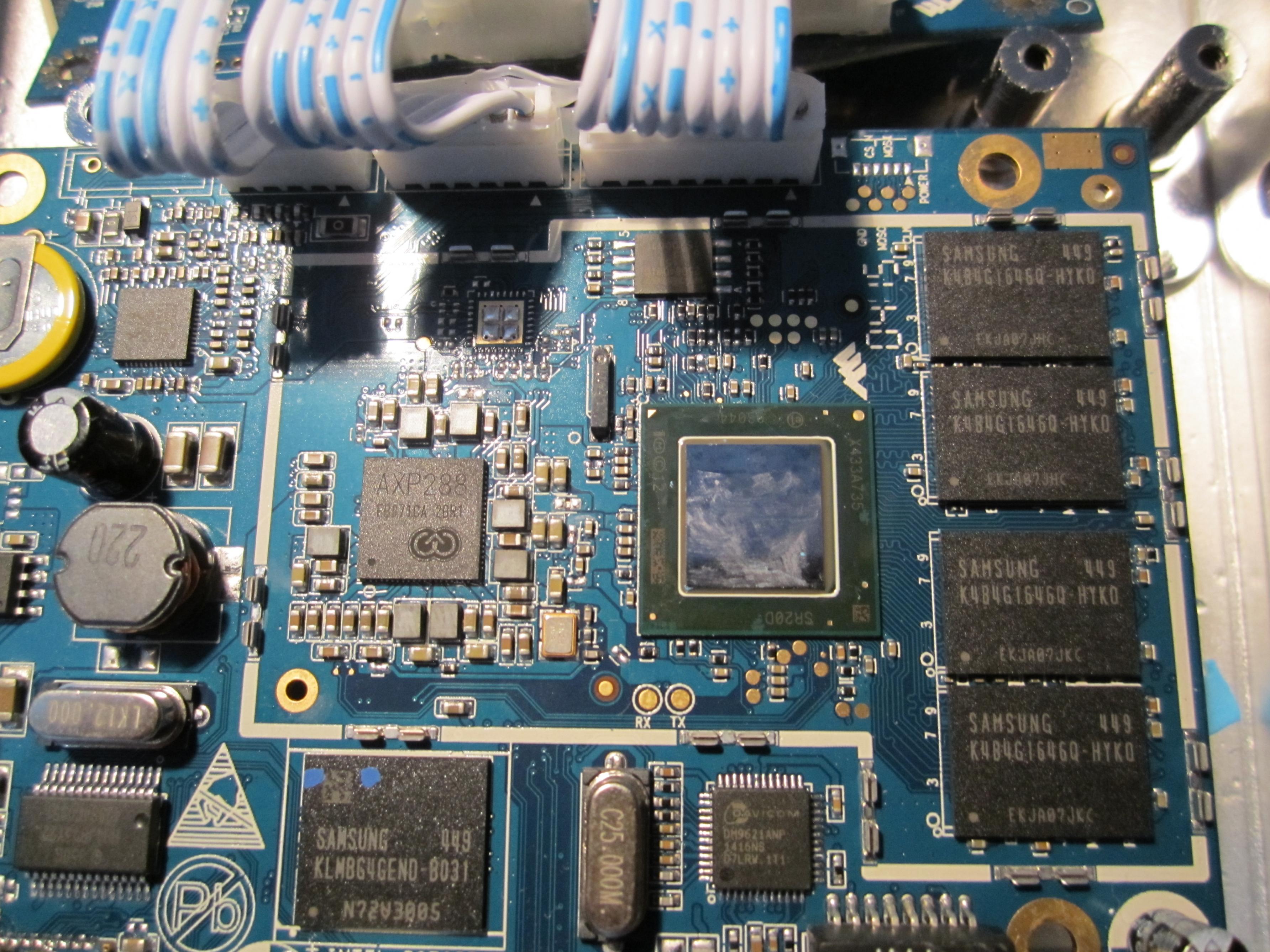

Maybe a rectangular cut in the case and then a bigger radiator will solve the problem.
Hi i have actually done something similar.
I bought some low profile (5 mm) copper heatsinks adhesive on one side.
these ones here ... as a 1st try.
8x Copper Adhesive Heat Sink Cooler for CPU GPU PC Laptop RAM DDR Cool MC 200 | eBay
better than nothing i hope.
These heatsinks will go on the aluminum metal plate in the picture attached below
I will check the core Ts with CPUID HWMonitor that i have been told is quite reliable.
If i will be able to keep cpu cores Ts around 60 C it should be enough for system longevity, i hope. 😱
Thanks again, gino 😀

I think in this case you just need some thermal pads. At my old workplace we had some extremely thick pads meant for use with power supplies, not easily available on ebay it seems.
So, get as thick thermal pads you can find, and find a block of metal - can be anything including a southbridge heatsink - sandwich the metal block between the two pads then sandwich that combination between the CPU and the chassis.
Hi and thanks for the valuable advice. But now i have bought these heatsinks. I will put them only above the cpu.
I will try to place them in order to keep some internal ventilation.
I have already made a simple support to place the pc vertically.
But this solution has no impact on T ... they stay as high as with the unit horizontal.
Thick thermal pads would stop air circulation inside the unit completely.
However i understand that using pads the aim is to use the Al case as heatsink.
I think i will try these heatsinks first. And check Ts ...

I should receive some heatsinks soon to try to cool it down.
But i am skeptical. The contact surface on the cpu is just 11x11 mm !!! and this honestly i do not understand.
This make the passive cooling a big challenge.
I understand that this cpu was designed with tablet and cell phones in mind.
The only positive outcome is the experience with 8.1 ... extremely positive.
Great sounding OS indeed.
Good luck !
gino
