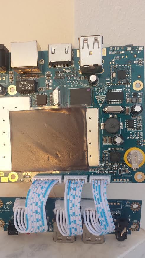

I noticed that my Pipo X7 has a slightly different pcb then yours, see attached picture. It is marked 20150109 and have more components, just above the battery and closed to the inductor. Maybe this is an improvement regarding temperature?
Regards, Ulf

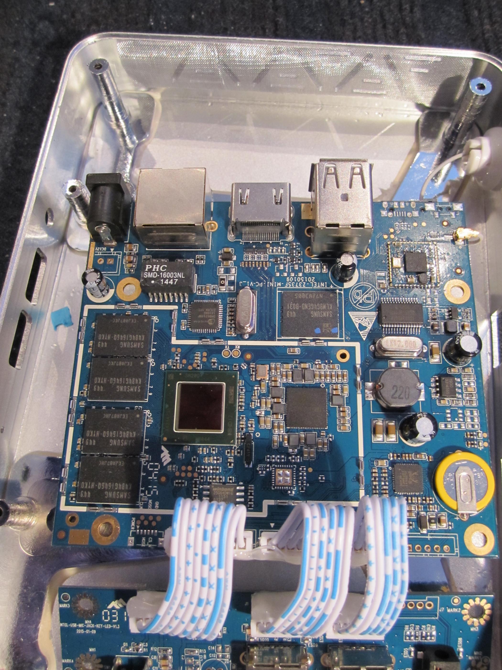

Hi Ulf !
i am attaching a picture of mine, it does not look very different.
Have you performed any mods on yours ?
I am waiting for some pads and heatsinks ... i am not set yet on a specific solution ... i am still thinking.
Thanks again, gino

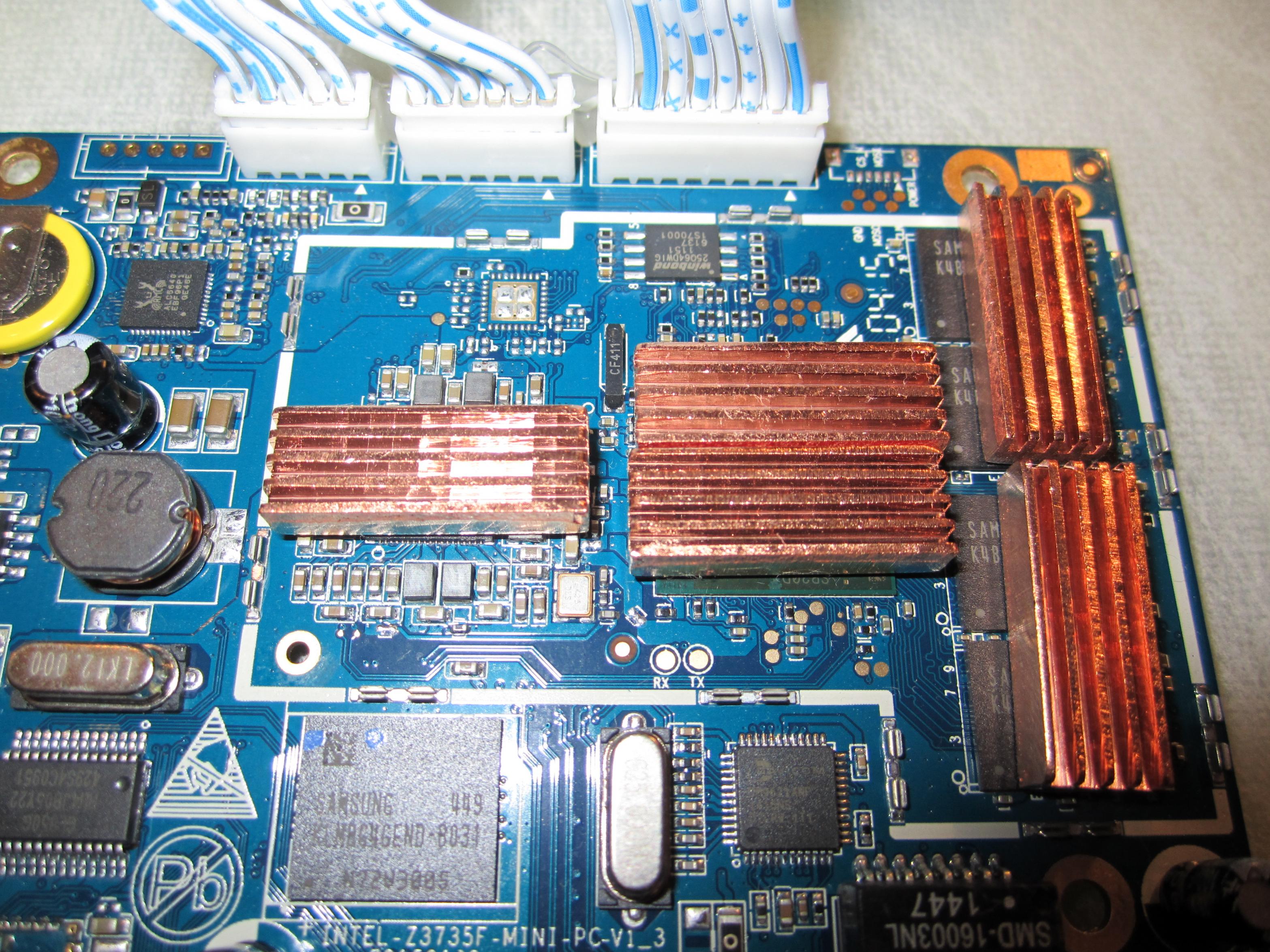

In the meantime i have tried some very small copper heatsinks on the cpu and ram (see picture attached).
I have reached easily 80 C just with the unit idling ... 😱
Now i am waiting for some other parts more promising
I intend to test it open and then if the T stays reasonably put again the circuit in the case
Thanks again, gino
