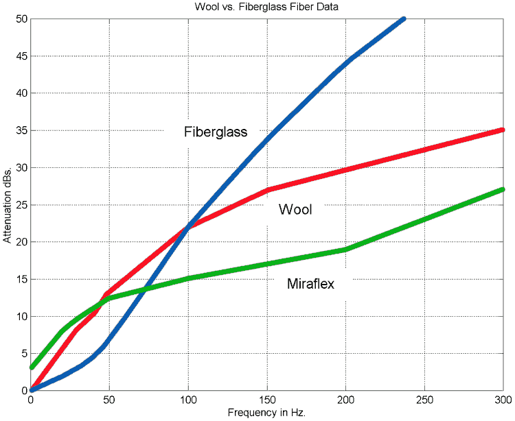

I used 3 1/2" thick fibreglass and peeled off the paper backing. I then glued the sheets on the back and all four sides with Gorilla Glue.
I left a cavity around the port area so the tube could do it's resonating thing. I also covered the cavity area with polyester batting to help keep the fibreglass particles from being thrown out into the room.
Depending on the size of the box thinner sheets of fibreglass could be used. Mine was a pretty big box.
Before I added fibreglass I could definately hear midrange and vocals coming out of the port. Very annoying. After I added the fibreglass it was almost dead quite inside. Only the bass could be heard. I crossed over at 80 hz 12db and yes there was midrange in the box.
Thanks for the heads up Dave, I removed the graphic and replaced it with the bookmarks to those sites.
I was wondering where I got that graph. I think it was from a Miraflex discussion many months ago.
Thanks again for the links. That is quite an article on stuffing!!!!
