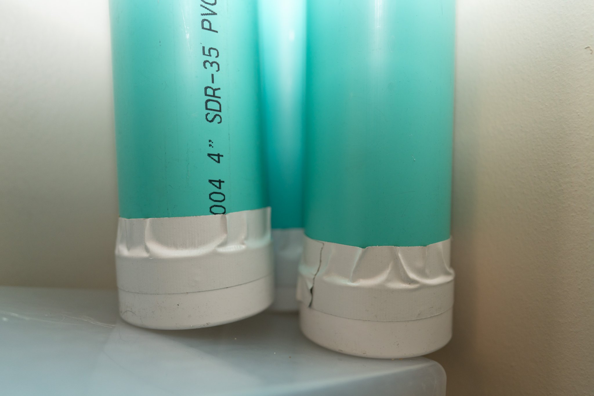

Pipe Dreams … 50hz Helmholtz resonator out of PVC pipe. Bass trap or money trap?

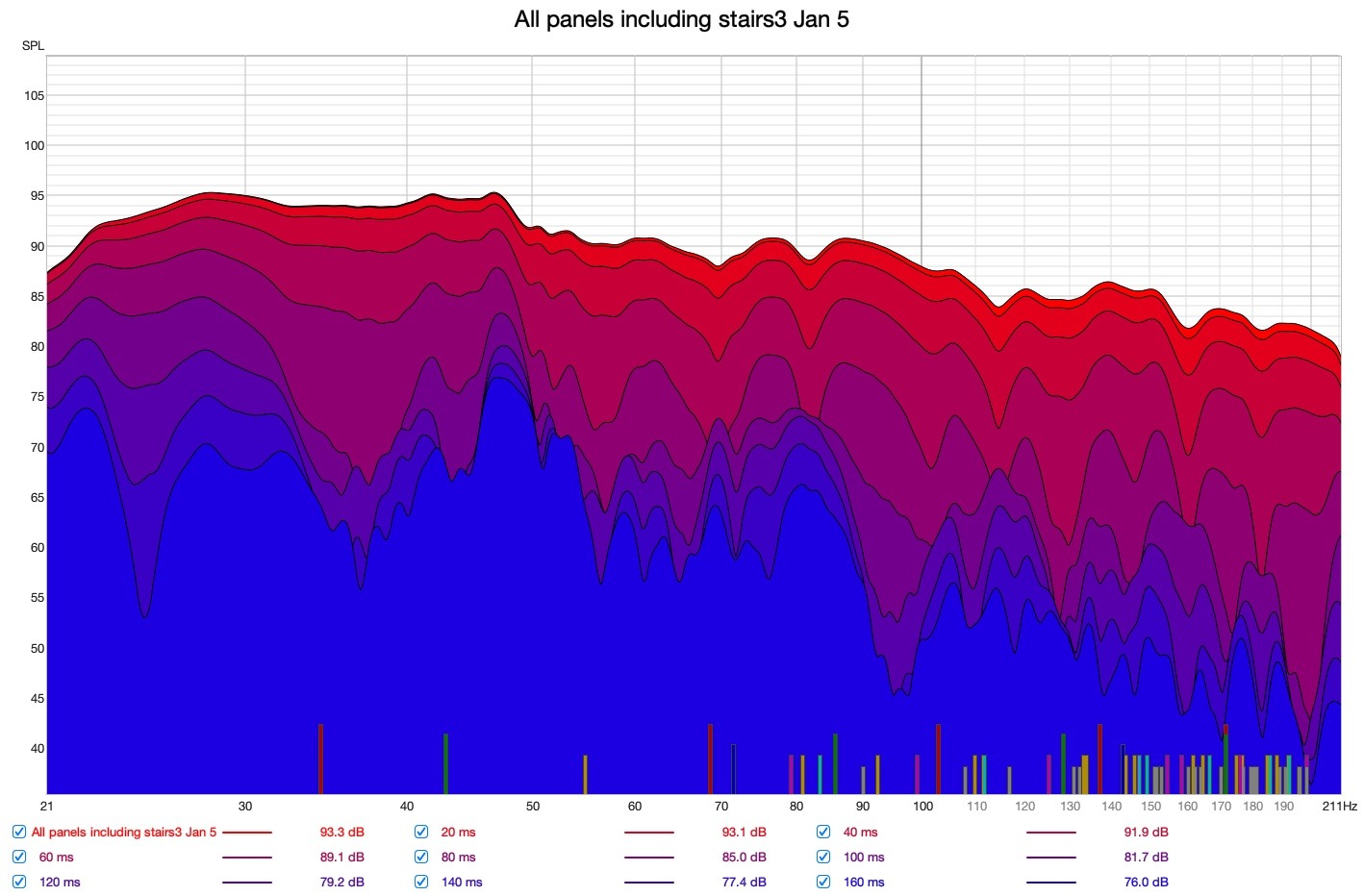

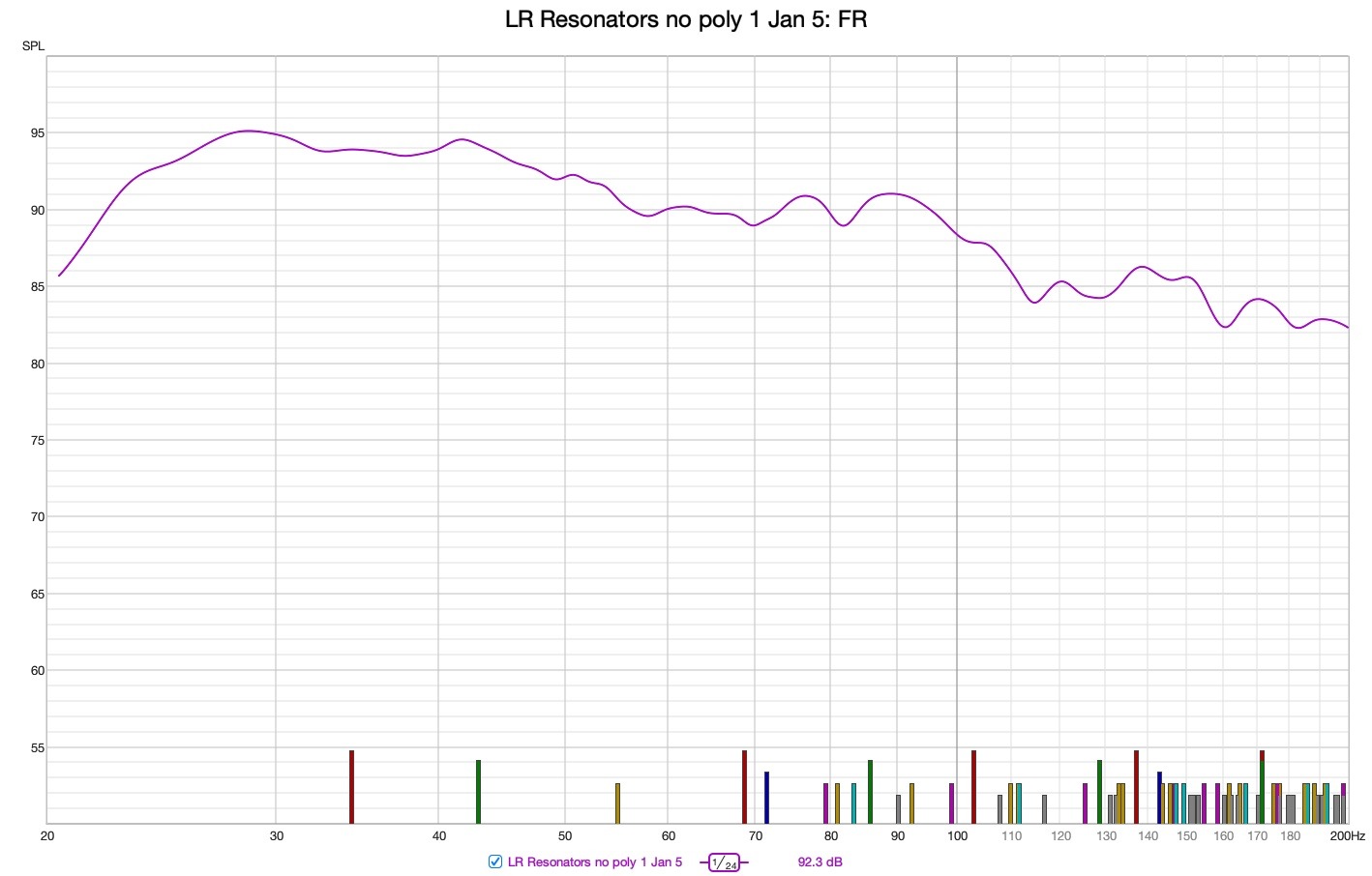

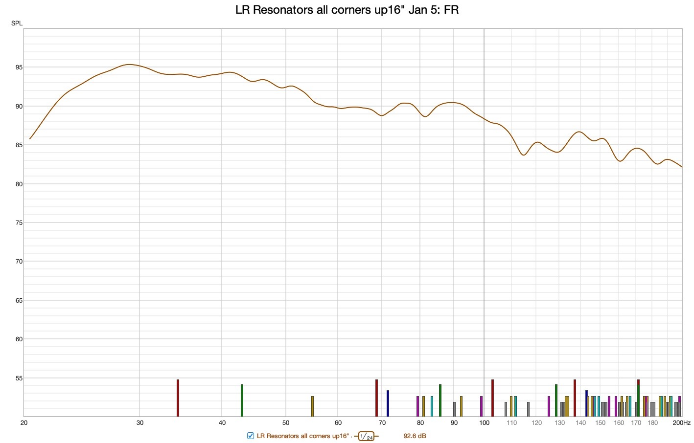

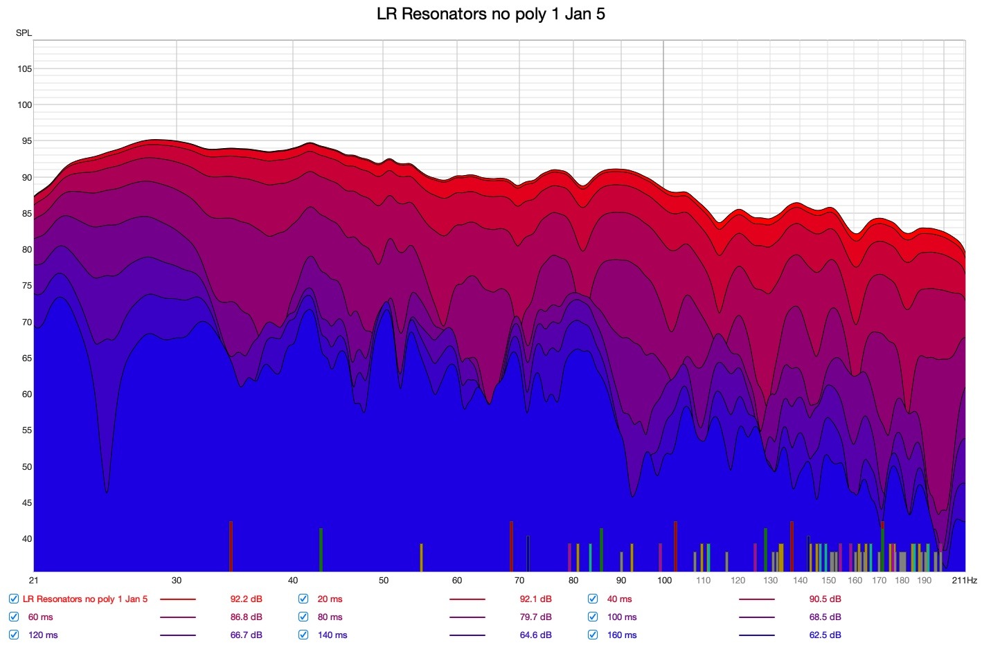

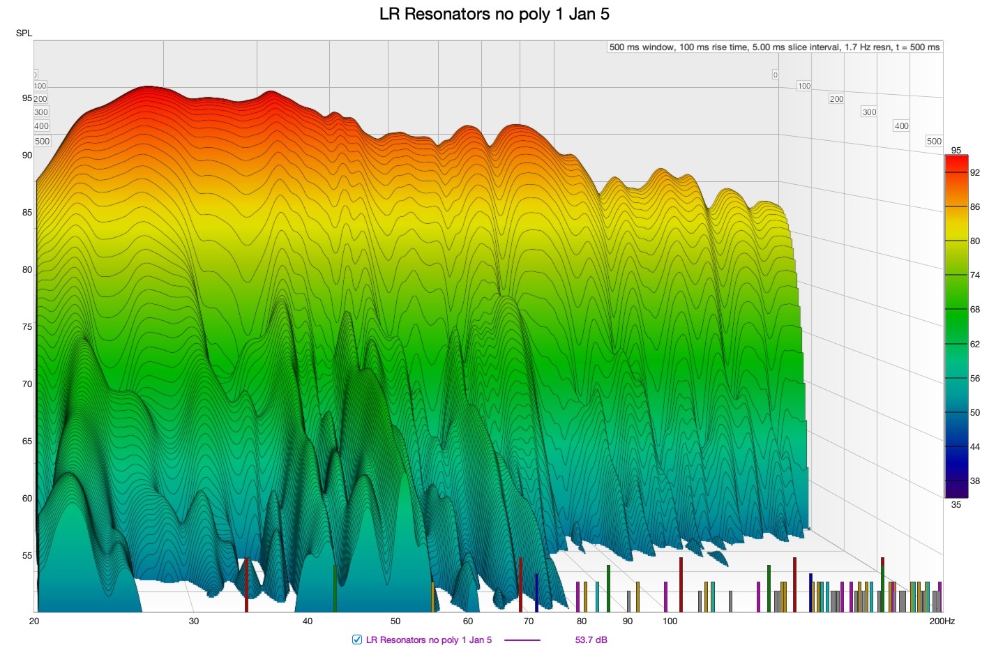

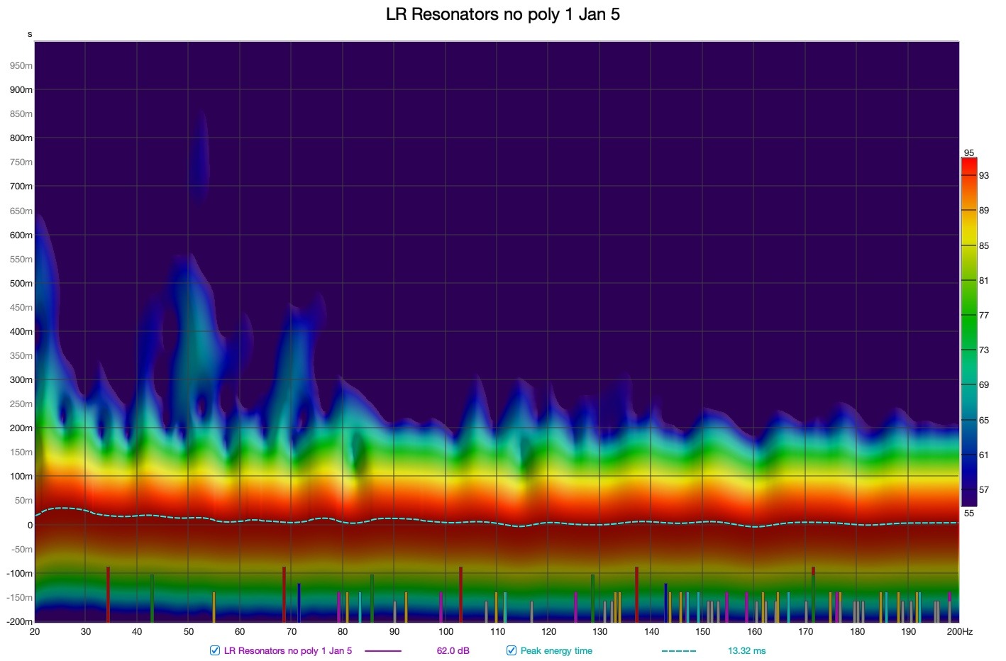

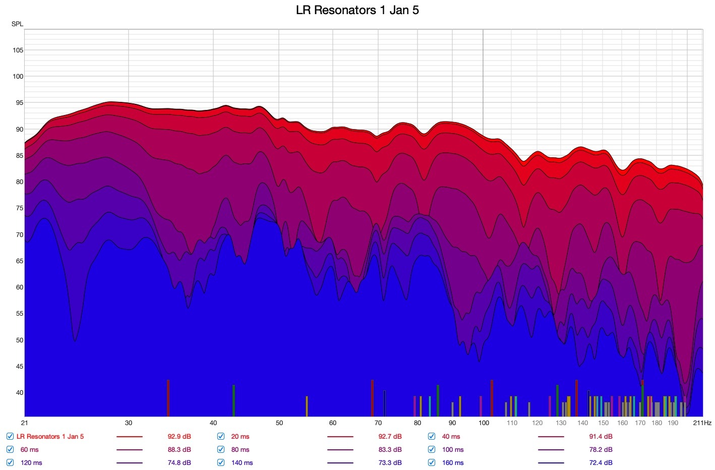

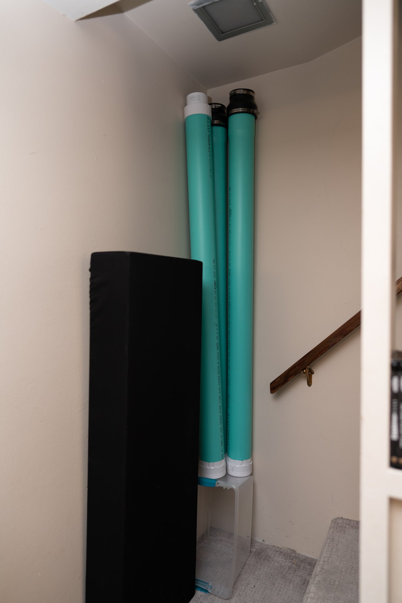

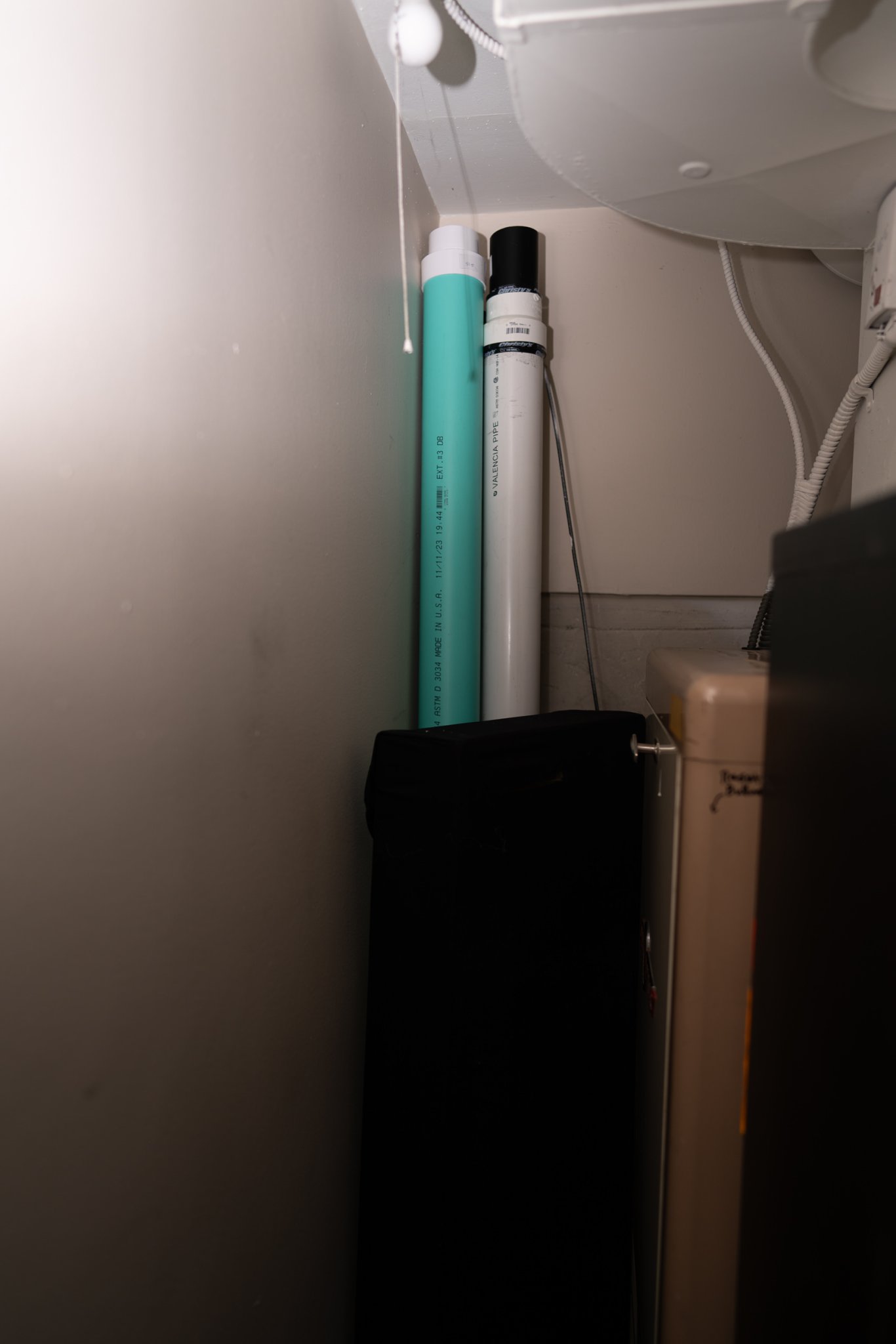

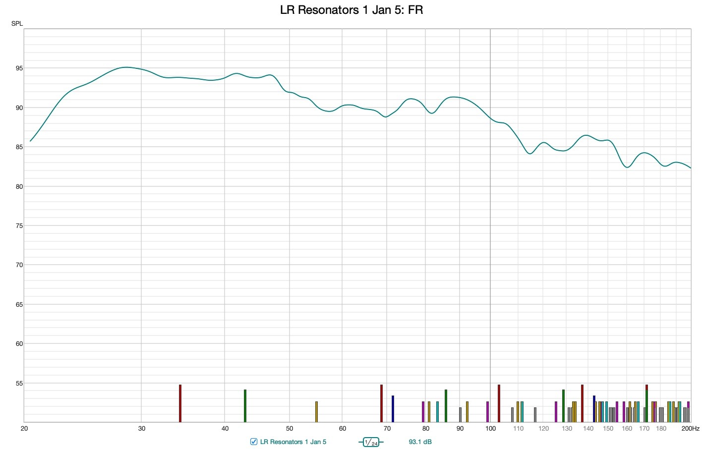

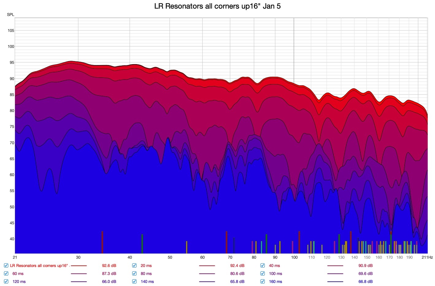

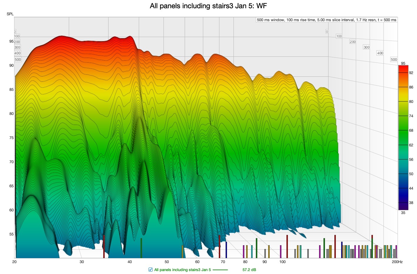

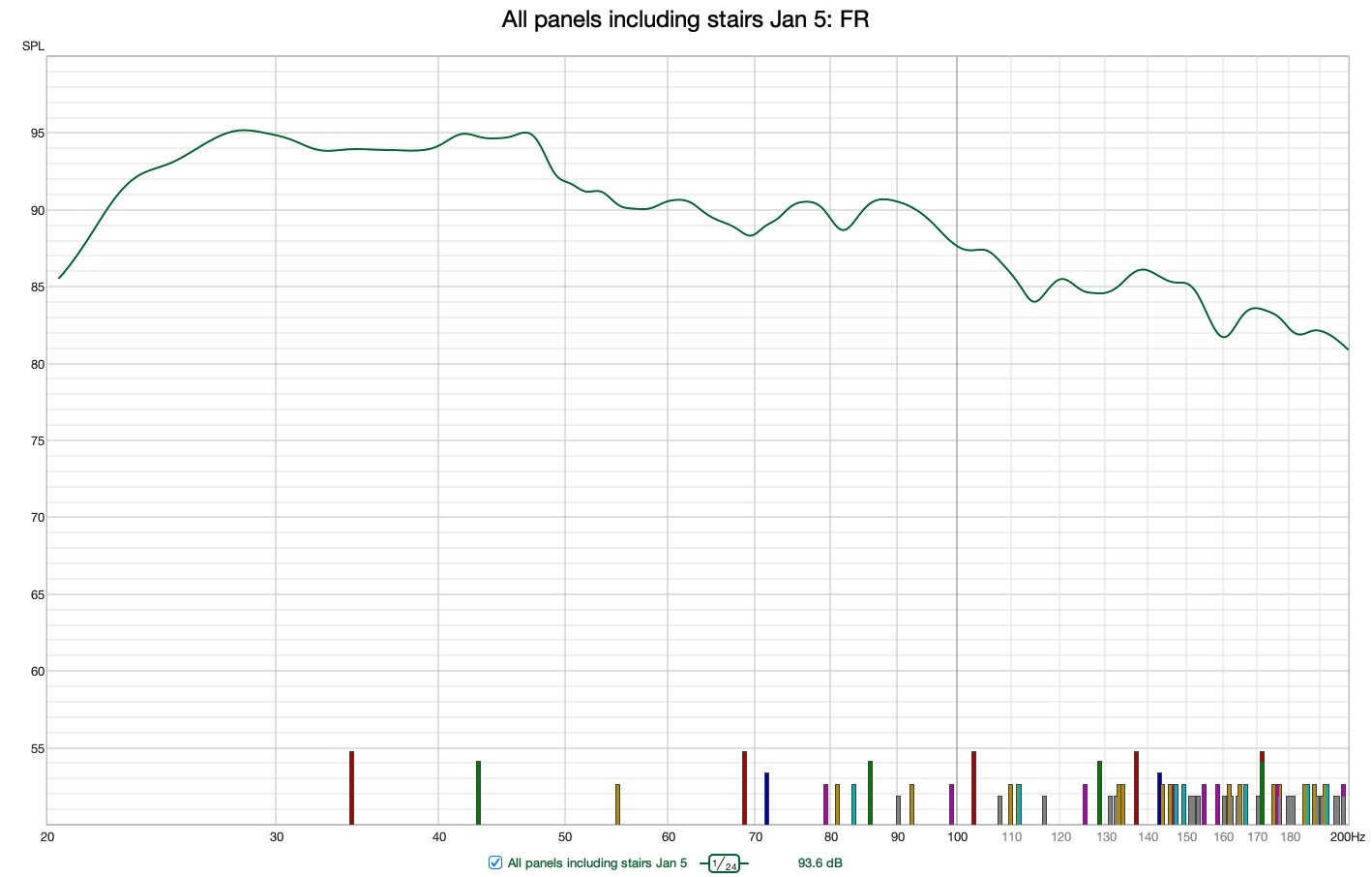

Ok, I took measurements before adding the tubes at all, then with tubes with polyfill in the neck (fistful), then with no polyfill in the neck, and then with all the tubes raised closer to the ceiling/corner of the wall and ceiling (about 16 inches higher and about 5 inches from the ceiling. Frequency response shows ver little change but the decay time show much more of a difference

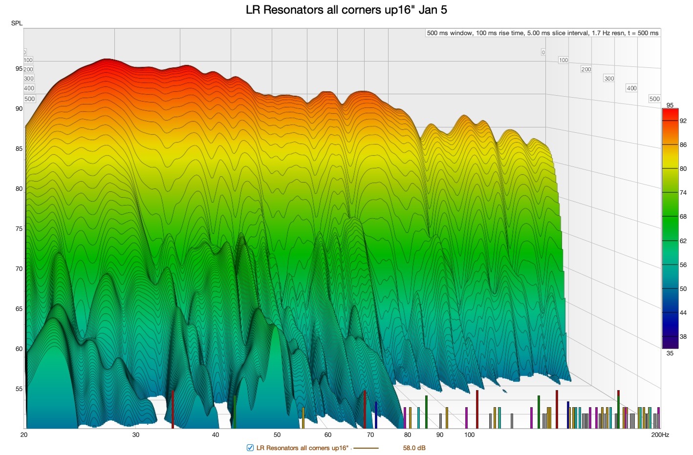

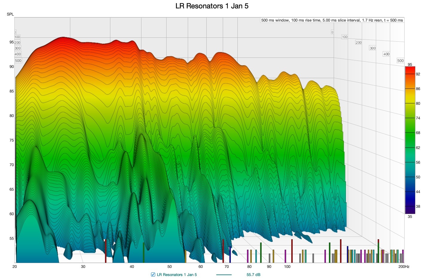

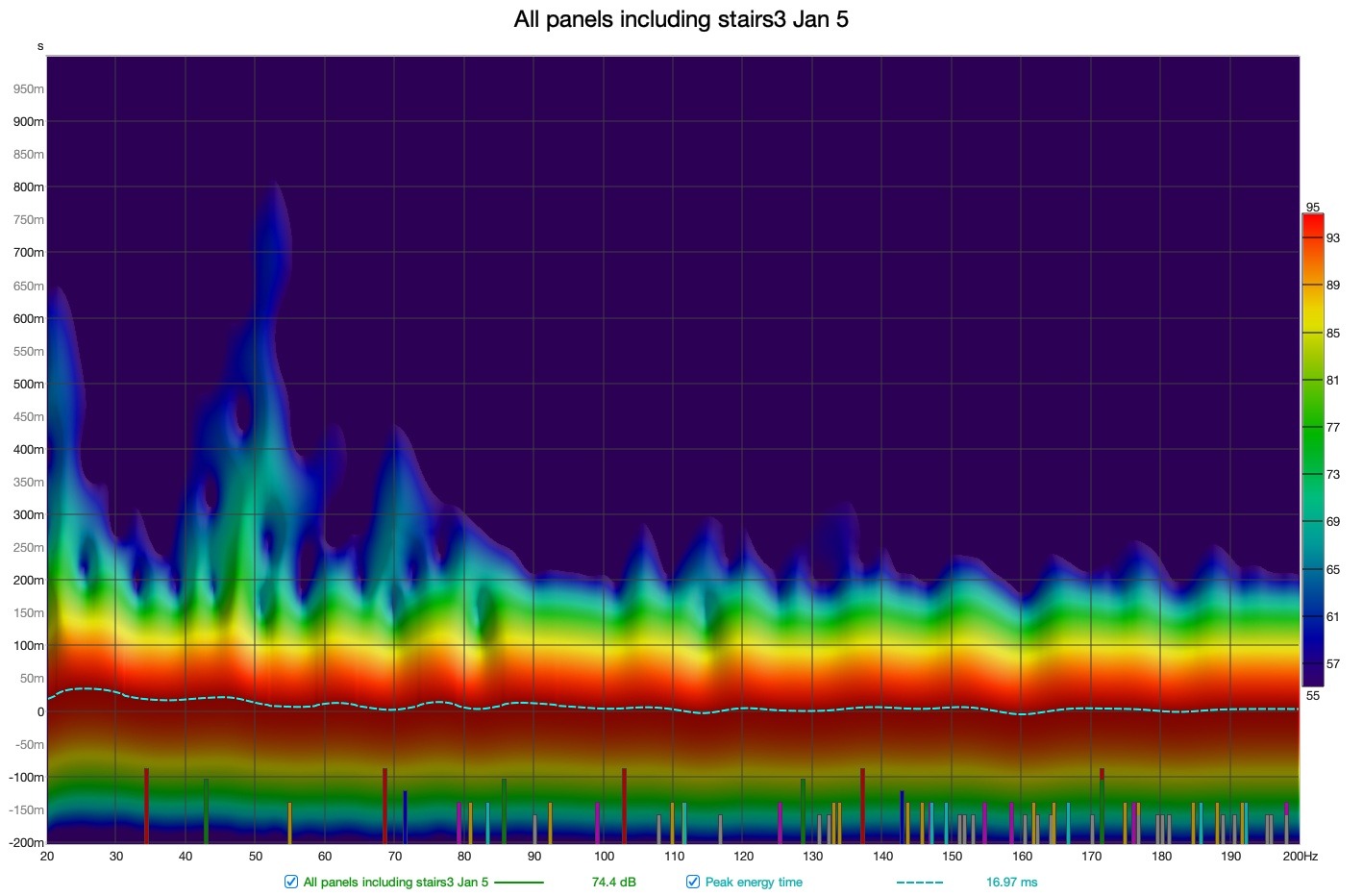

Here's the Waterfall

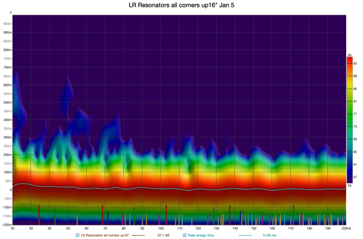

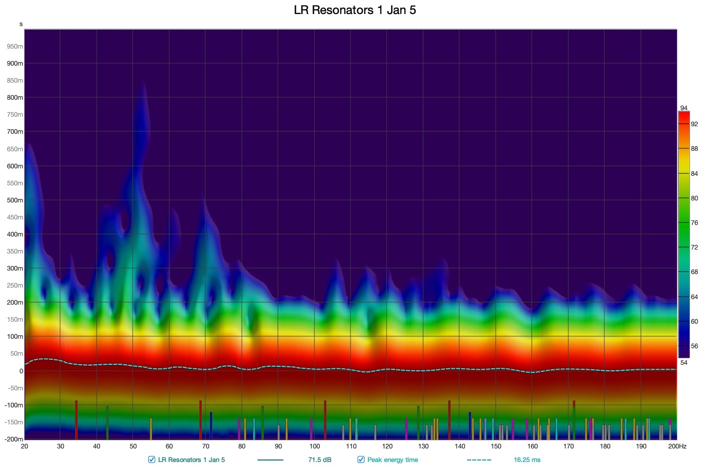

Finally, Decay.
Oh, I have some problem to interpret correctly those diagrams - by lack of knowledge 🙄 - but I'd say that the best compromise seems to be the N°4, at the extreme right, if I only rely on the frequency response curve already... Right ? 🤔
Yes, but the differences lie more with the time domain vs the frequency domain. Look at the 50hz region in all the other graphs.
Reactions: tubelectron
Ah, OK - I see now : the 50Hz is correlatively minored with the FR curve, but it's much more obvious in the time-domain graphs, that's right. So you must notice a positive difference, I guess - even if it may not be so easy, because A/B-ing is impossible in this case !

Basically chasing graph porn at this point because like you said it’s impossible to A/B the difference. Our audio memory is about three seconds long…maybe I could enlist in three people per corner in my room to rest their hands over the mouth of the resonators, lol!

I have to imagine it’s helping my bass as you can see the decay drops much faster right in the key area for things like kick drums, etc.
I might do 12 more when I have some time to measure again.

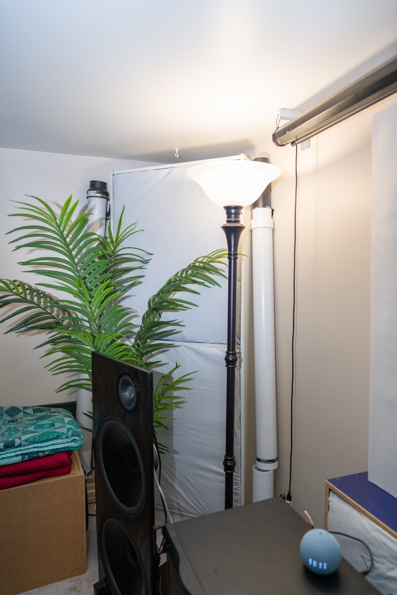

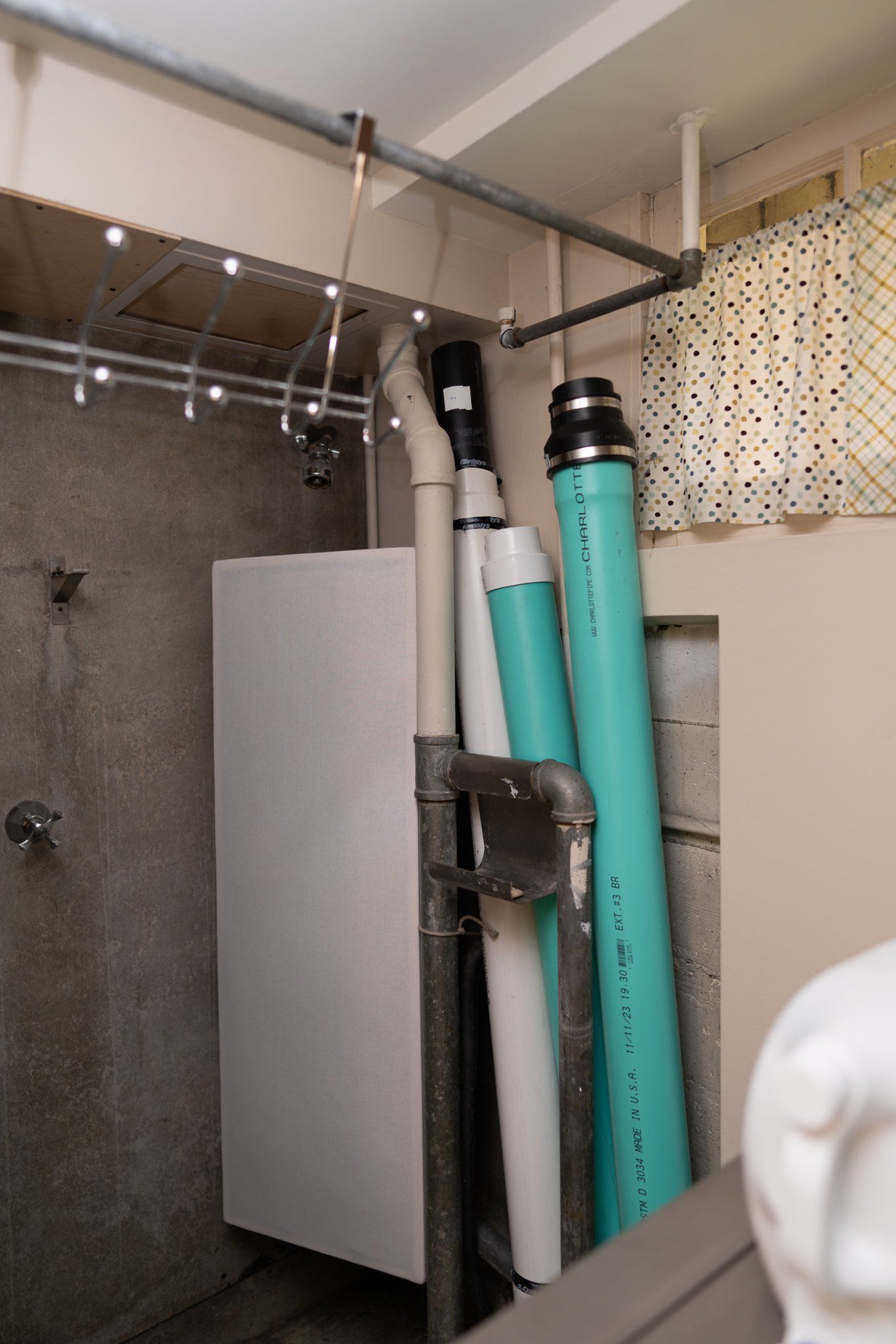

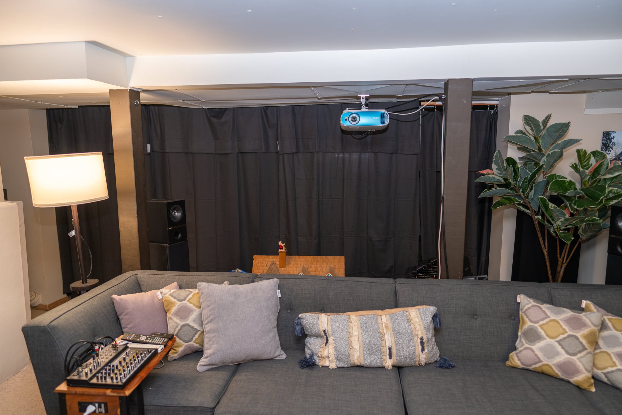

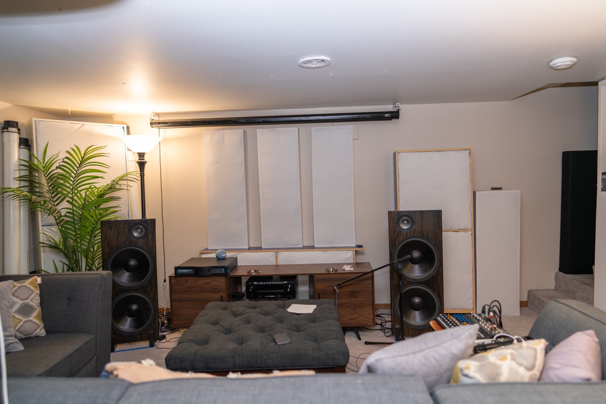

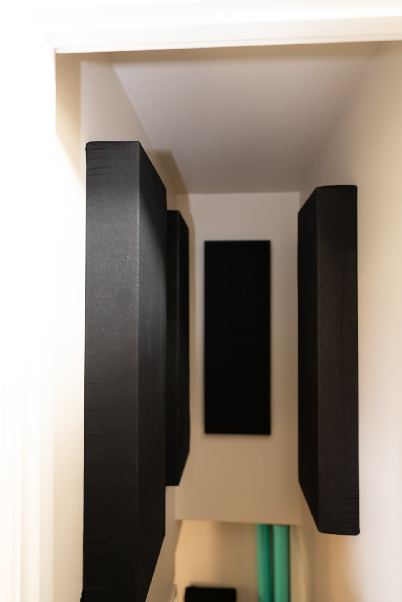

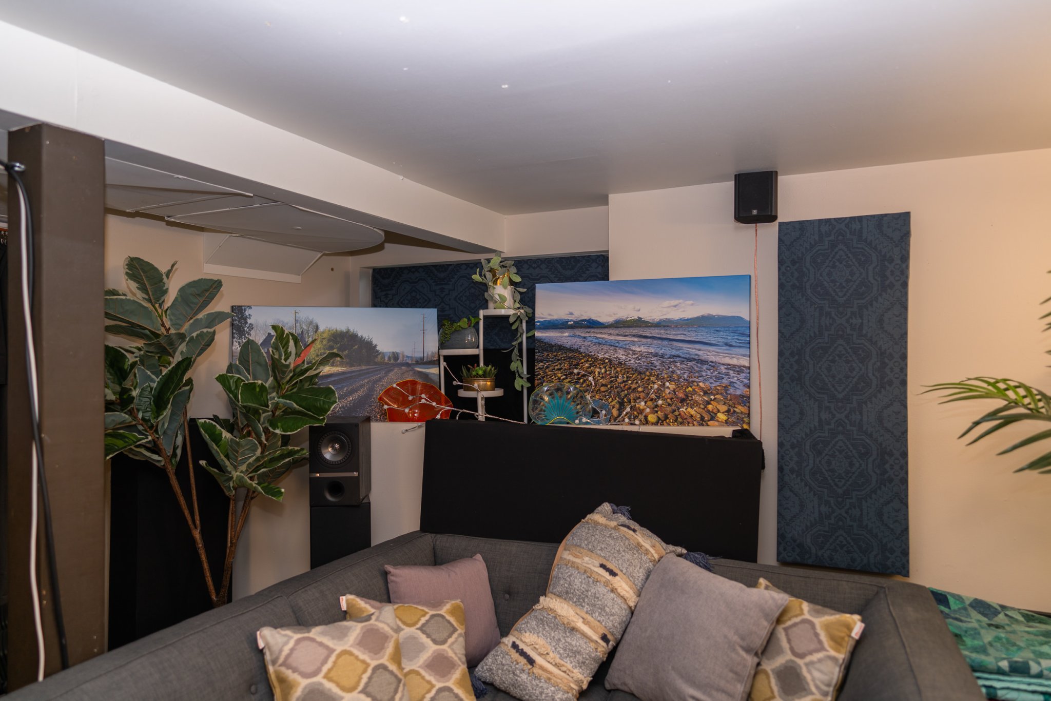

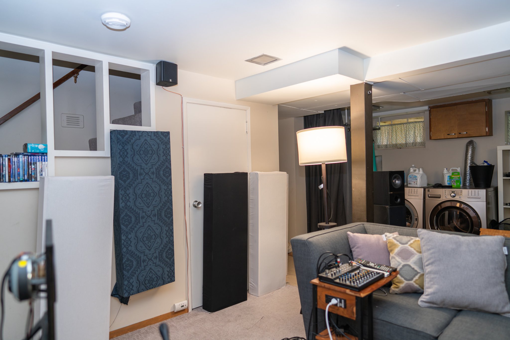

OH it's not pretty!!! The next phase will be trying to make this look much better. It's functional though. LR are open baffles I built with KEF Q100 drivers and GRS 15" woofers, all active.

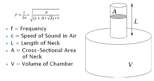

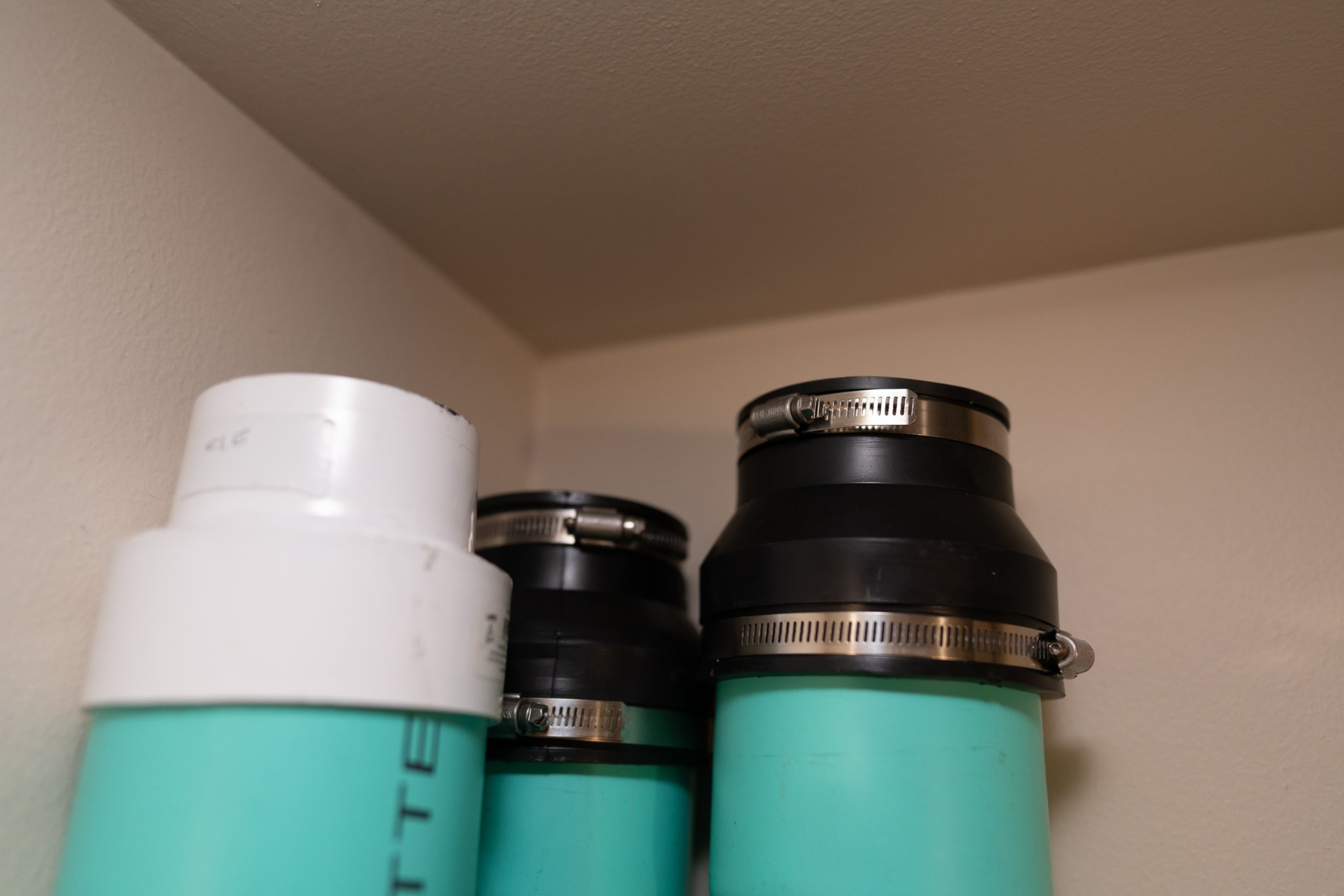

The nozzle is critical to the design. As I commented earlier somewhere the nozzle is the most important part, more important than the volume because both diameter of the nozzle and the length are parts of the Helmholtz resonator equation, which I also posted earlier.
I think I remember reading in the paper that you sent me that the shorter nozzles worked better. What I'm curious about is the diameter but not just the diameter but the ratio between the body of the resonator and the neck. There is very little difference in this pvc design. 4" vs the 3 in" nozzle. I'm also very curious what would happen if the nozzle was cut at an angle. That would make the face or surface area of the nozzle opening quite a bit larger and perhaps give me more efficiency.
Yeah, this is all about the frequency created not the change in efficiency of the resonator. I read this and might try to drill some holes int he nozzles as this is supposed to add effeciency without me having to change anything else. It also seems to be a good idea to colocate the resonators as they become more effecient than the some of their parts if they are together. The paper didn't actually say anything about if they were tuned to the same frequency, however.
