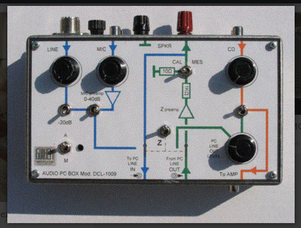

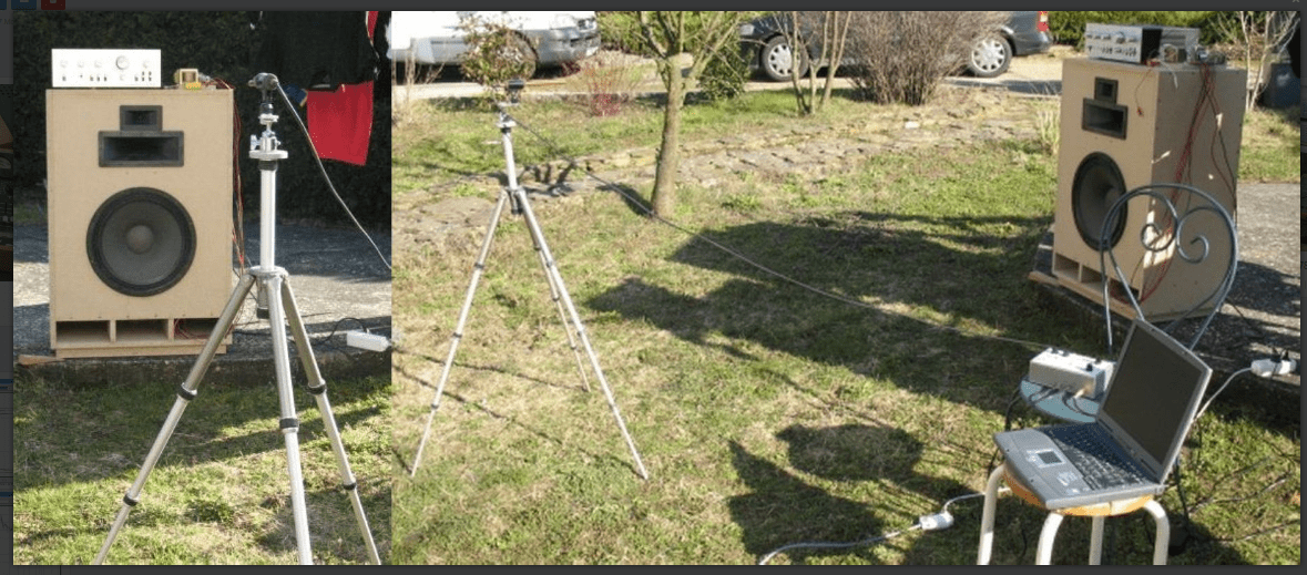

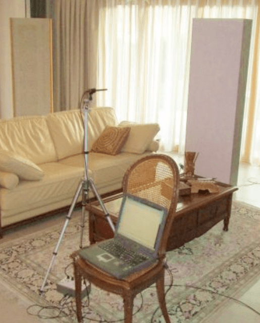

Now that I have a new computer, my audio softwares are all obsolete now, and don't want to operate on an emulated machine either... I have an ARTA license, an external soundcard, still my old analogue measurement acquisition box (to be modified for a new setup with the new machine), two measurement microphones, a level calibrator, plus there's new interesting softwares like REW and many other...
I will have to reinvest time to learn to set up all that stuff again, and its quite long, and I am lazy ... I shouldn't !!!
Pictures of the past...
