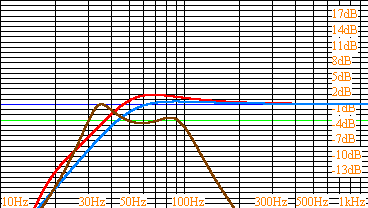

I wrote your numbers for the Pioneer into WinISD, which did not have them on the database.
Arbitrarily, I decided to give all boxes a volume of 2 cubic feet, for equal comparison puroses.
Red: Vented, tuned to 28 Hz. A lttle hump, but still a good response. Improvement over sealed.
Blue: Sealed, with a volume of 2 cubic feet.
Brown. Bandpass with the following parameters.
Front chamber, (in front of woofer): .9 cu ft.
Rear chamber: 1.1 cu ft-no vent in rear chamber
Tuning: 52 Hz. A 3" diameter port, 8.5" long.
The bandpass is a little less output over 45 Hz, but some people just have to have substantial output down to 30 Hz.
Anyway, the choice is yours.
Of course, the box does not have to be 2 cu ft. Let me know what you are thinking size-wise. I just wanted to illustrate that a 2 cu ft box has 3 usable possibilites.
