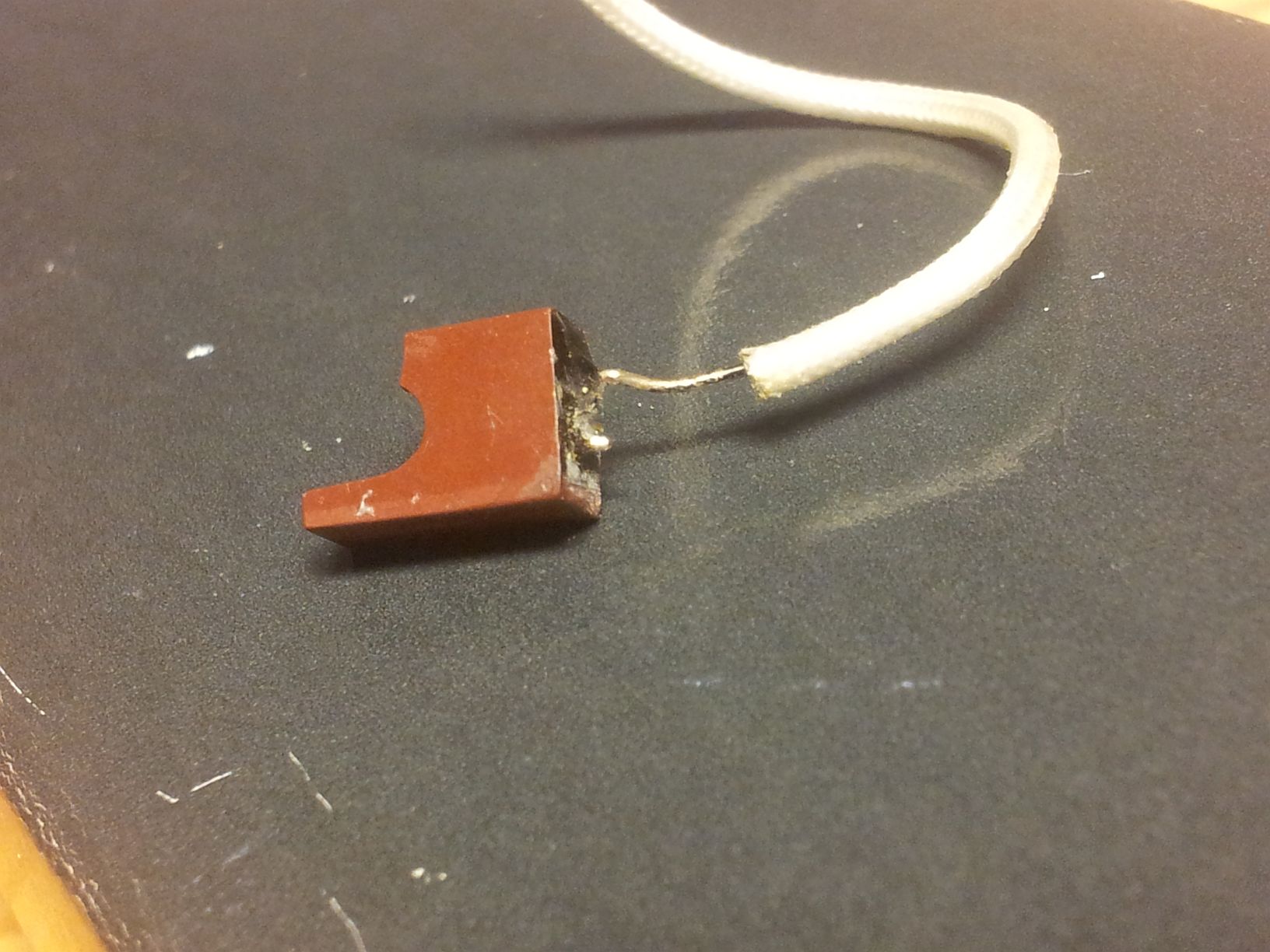

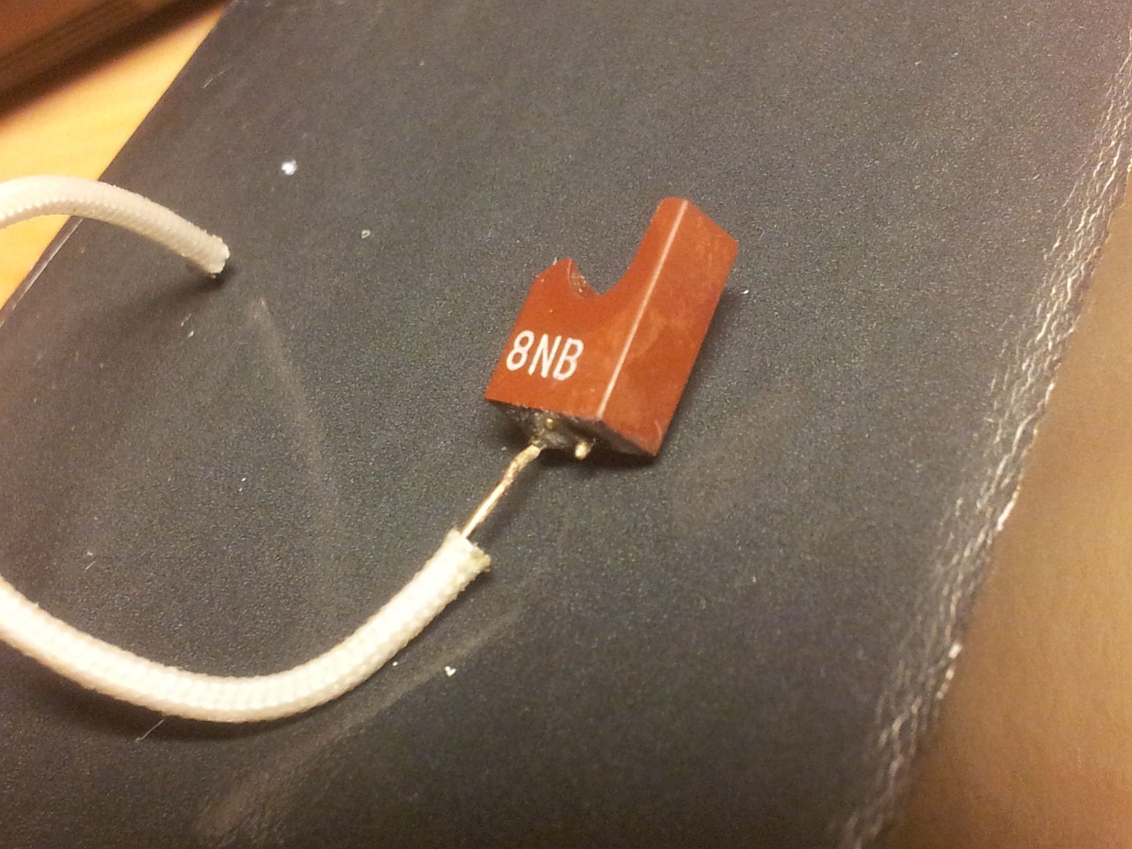

And whadda you know - I already have an issue 🙁 - the repaired STV4H (D5) broke off the wire again - I post a photo after this.
I hope it can take another repair, but I would like to hear if you have any experience with such problem, more of how deep can one dig into it to free more solder-wire. It seems the epoxy melts when I solder on the wire stub.
Also I consider - once I (hopefully) fix it, to apply some stabilizing cast on - perhaps some epoxy or the melted plastic of a glue gun?
Do you have an opinion on this?

Ummmf... this is a difficult one 🙂
Those diode combos were used by Pioneer widely, but I think not in production any more ((
I'm not sure how deep you can dig into it, well, probably a millimeter or two. Putting some compound or glue would be good, I think - just let it fully dry before you use it. Also a plastic pipe, that shrinks, when exposed to temperature, normally gives a good additional protection, keeping the whole assembly under certain tension (after it shrinks)...
Yes, not a good situation. I'll see if one of the solder specialists at work can save it. It would be unbearable if it can't be fixed at this point.
Well, probably it would be possible to substitute - need to read a bit more about its parameters... I'll think about it... in parallel with you trying to fix it 😉

The difference between STV4 and STV3 is actually the number of diodes inside the combo - 4 and 3 diodes respectively. We need 4.
From what I read so far, it looks like UF1004 behaves pretty similar to those Pioneer combos. I think UF1004 is not easy to buy these days, but UF4004 is easy to buy and thermally it is the same. So, as a solution - take 4 x UF4004, place side by side, connect them serially and seal with some electrically neutral compound - you get STV4-H equivalent.
