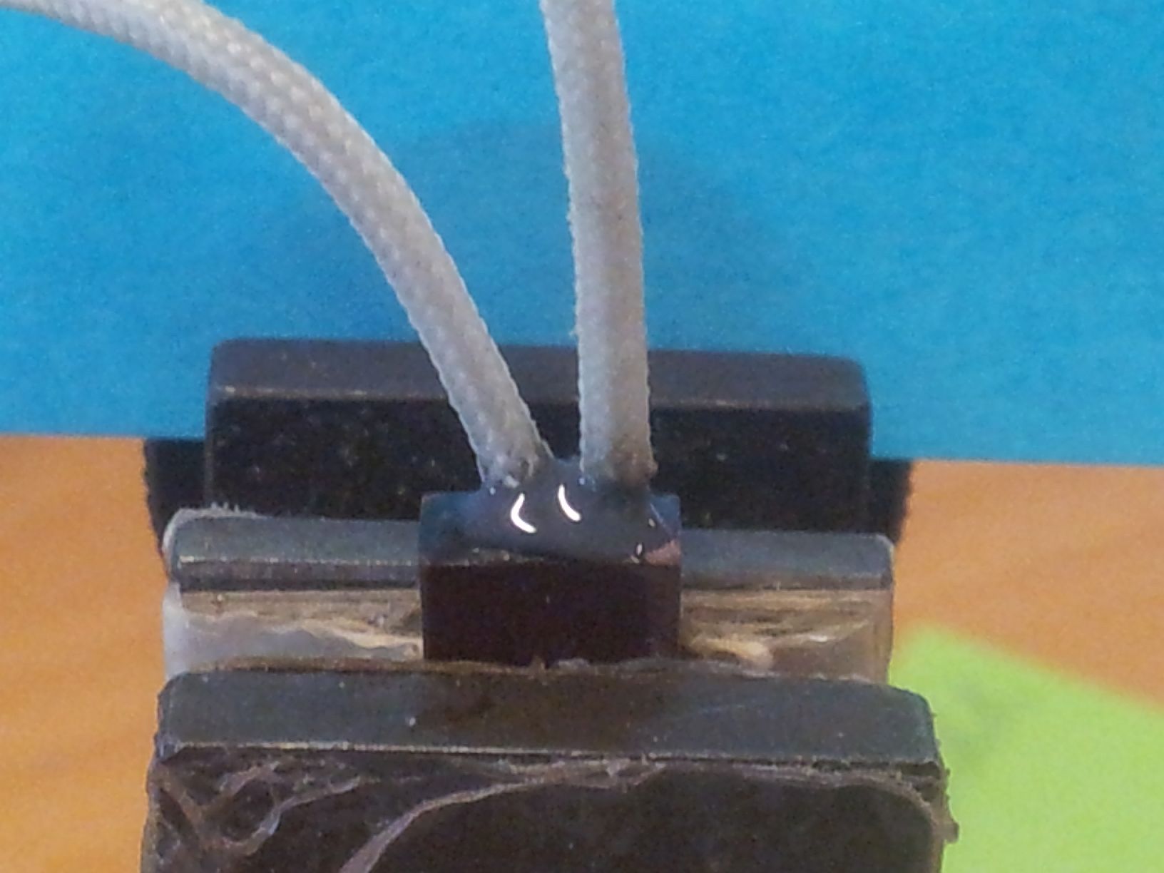

I got fixed by my dear colleague - a certified solderer 🙂
Sealed with Aerospace 3M 2216 3M aerospace and aircraft product catalog ? 3M US:Aerospace OEM:3M? Scotch-Weld? Epoxy Adhesive 2216 Gray Part B/A, 2 fl oz Kit, 6 per case
It will rest on my table for 24 hours - can't wait to finish 😀
Looks very good. 3M glue and sealing products are excellent. I use some of them for gluing the video camera mounting plates to the helmet. After that you can remove it only together with a piece of helmet 😀
