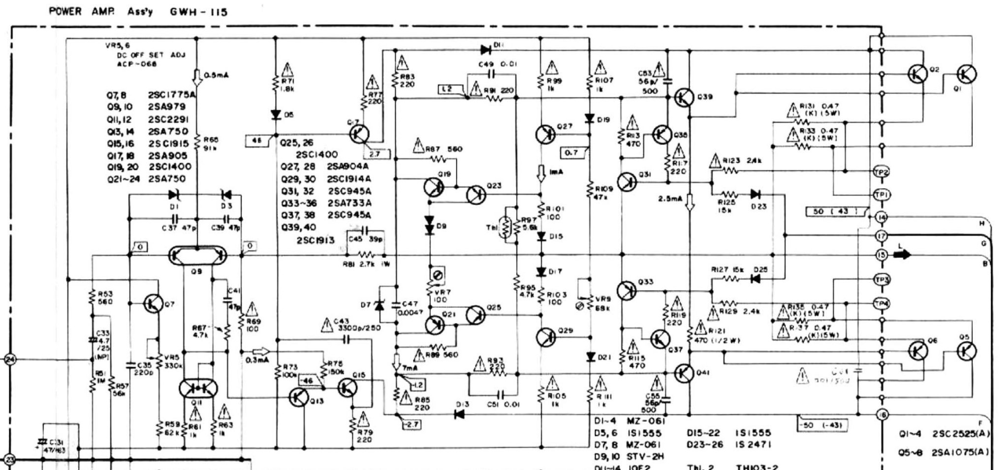

I rebuilt this amp and am now getting high frequency oscillation at the highest frequency well above the audible range. I have to have my 60MHz scope on the highest frequency setting to see it. It is in both channels but worse on one side. And the unit has to warm up for ~10 or so minutes before the issue starts.

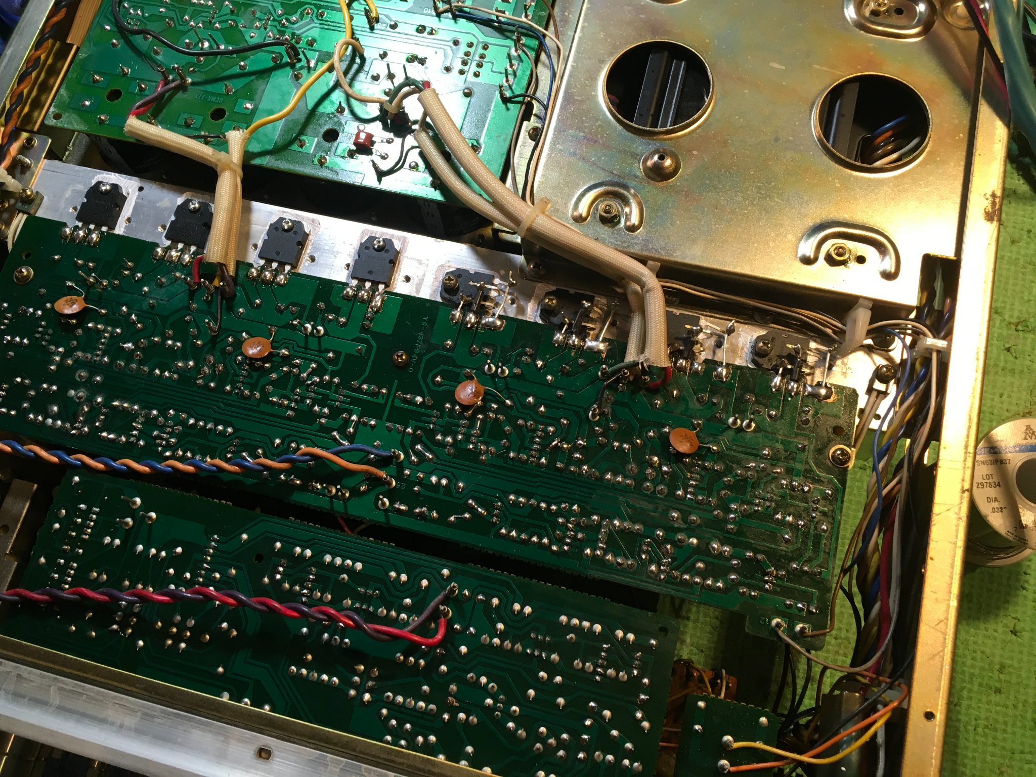

Output transistors were replaced with 2SC5200/compliment. I had to mount the outputs for one channel sideways and use leads to connect them to the board. Not the sort of thing I like to do, but I couldn't find any alternative. The original batwing outputs are obsolete and the transformer plate is in the way of installing the TO-3P straight.
Driver transistors are original. I replaced the input transistors with KSC1845s and 992s.
I also replaced the 10ohm resistors in the stability network (R1/R2 on PS/protect board), as one was damaged. I replaced the associated 0.082uF caps as well.
Any ideas? I'm regretting taking this job on now. These are finnicky circuits and the original outputs are unique.

Try removing both C49 and C51. If that makes it stable, just leave them out.
If that does not help, try readjusting the R67 and C41 network across the output of the input stage.
Would you be able to share with us what the purpose of these capacitors purpose is, why you suspect them to be causing issue, and your steps to arrive there? Perhaps the same for the latter recommendation.
To my knowledge, C49 and C51 are actually there to prevent oscillations by acting as a high pass filter for frequencies that would cause issues, shunting out the resistor for those currents that are present at such high frequency.
C49 and C51 are "peaking capacitors" which attempt to compensate for the following load capacitance.
This approach was very popular in older ss and tube designs, until it wasn't. They were tuned to the devices used.
Also be sure the replaced output Zobel has low inductance parts, or its function will be impaired.
For a amp circuit with such a non-standard topology , I would simulate it. Check phase margin/ gain.
You seem to have a close gain/Ft match for your new outputs.
Input pairs might be different , play around with (lag - C41 + R67 470R) , up C41 to 220-330p. You might have too much OLG now.
just a guess , build it in LTspice.
Edit - most stages are similar to my sonance 260 lag... C41-300p , R67 -470R .... lead comp. C45 = 15p That gives about 600Khz UG
with at least 50 deg. margin (stable).

I changed C41 to 330pF and R67 to 470ohm. It seems to be happy now. Should I change C45 to 15pF as well?
This thing has a two stage bias adjustment. The first adjustment sets the bias to 56mV then the second one sets it to 70. With the new parts, the bias is at 70 with the second control all the way down. Is this an issue? Does only the final bias matter, or do both stages need to be set correctly?
Can I tweak the circuit to compensate?
