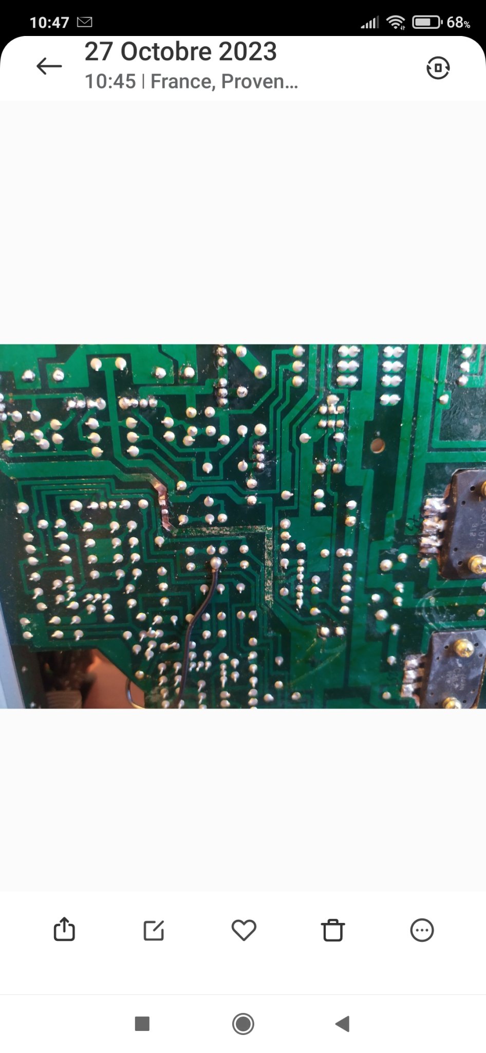

This is a burned ground trace.
Does the amp play with the lamp?
Measure output DC before connecting speakers.
If there is a large output DC, don't connect speakers, other parts will be broken.
Measure R601 and R602 (1.5k). If they are broken, the display won't work.

What voltage do you measure at collectors of Q1 and Q2 (output transistors) with respect to the white wire on the secundary of the transformer?
With lamp attached.

OK, so you do have + and -46V without the lamp and with the trace repaired.
Do you measure DC at the output, without lamp? How much, left and right channel?

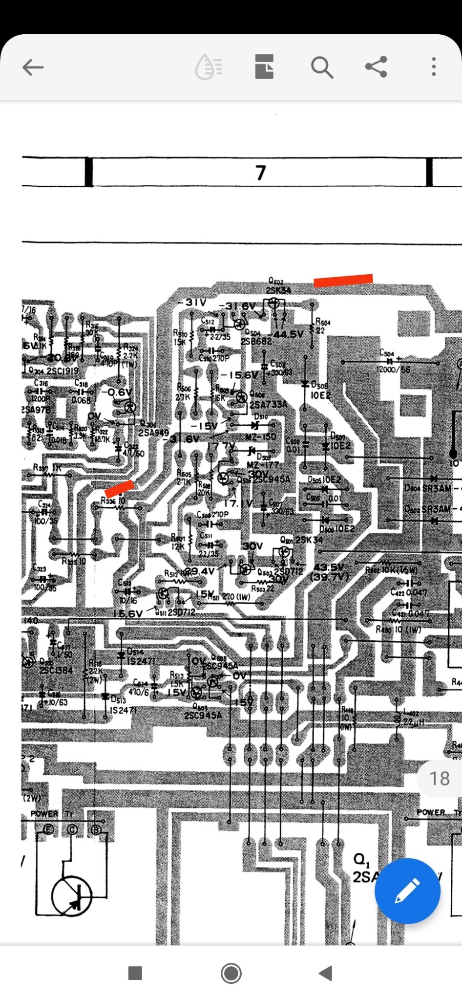

Completely follow the trace and measure every component that is connected to it, especially the diodes (D509, D510, D416,...), but also the resistors and capacitors.
Somewhere there has to be a shorted component.

I think you mean Q502?Q602 dead

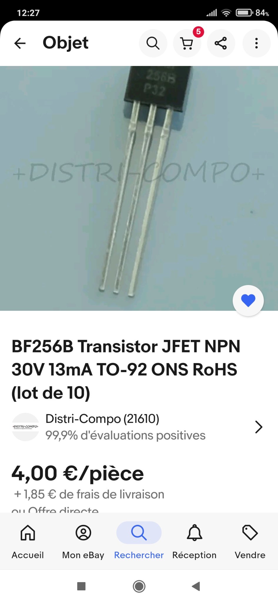

2SK34 could be replaced with BF245 but is also hard to find...
