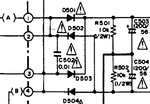

Hello.
Pioneer SA 708.
Problem no -46v on diod bridge .
+46v ok.
Transformer ok on 2 red wires 30v AC.
All 4 diodes 501......504 are ok.
Dessoldered and tested.
No bad soldering or damaged parts.
Need help.
Regards

I think the voltages are just fine but there is a little misunderstanding in the way they are measured.
You need to put the black negative wire of your meter in-between the resistors and keep it there.
That is the ground connection, the thick black line in the picture,
With the red wire you will measure +46.5VDC on top of R501 and moving it to the bottom of R502
you will measure -46.5VDC.

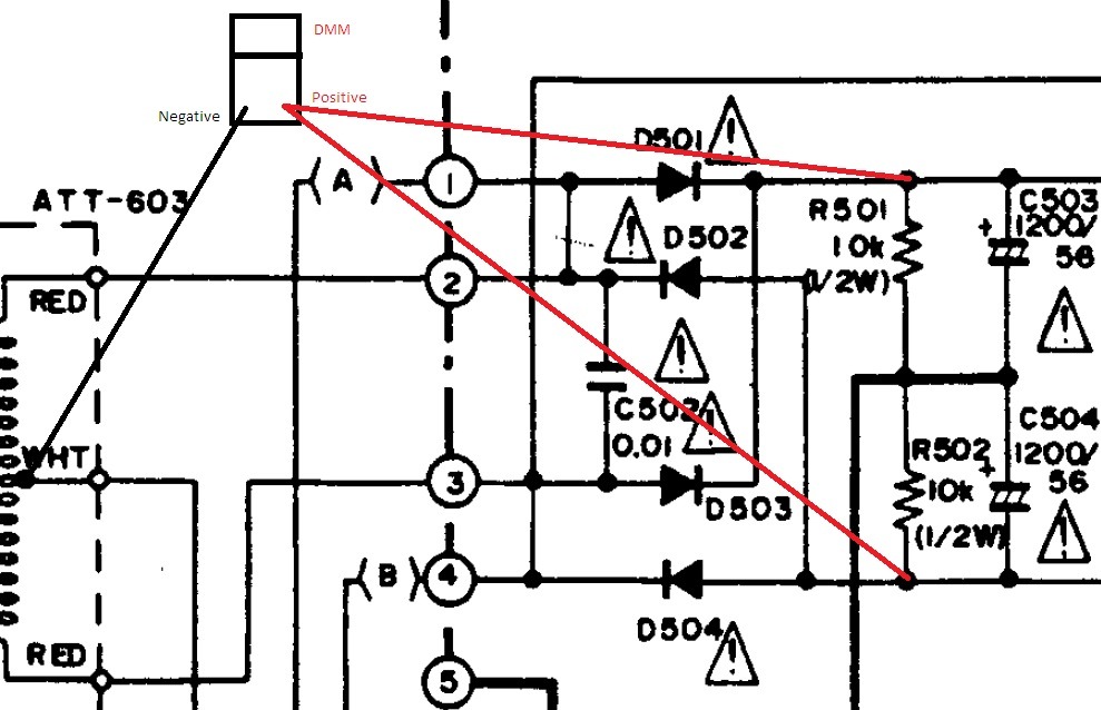

Have you measured as the drawing shows?
Top of R501 will read +46.5VDC
Bottom of R502 will read -46.5VDC.
Hugo

You measured 93VDC in post #8. This is twice 46.5V. This means the total voltage is present.
Bad solder joints or broken leads could be the problem, as WhiteDragon said.
But then, it would be intermittent.
Can you take a picture with both resistors clearly visible?
Hugo
