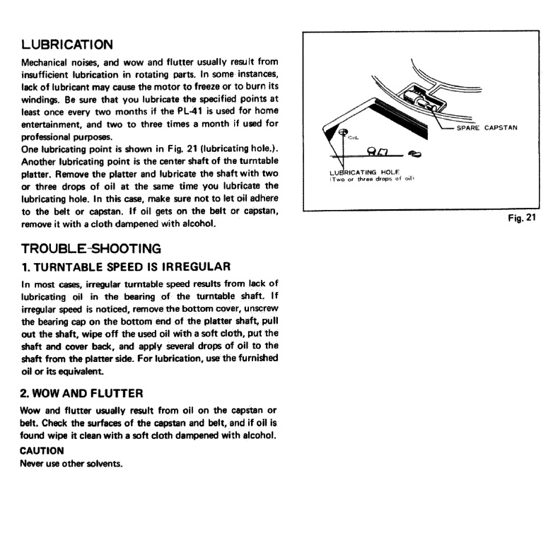

PL-41 manual
The PL-41 manual can be found here:
http://www.vinylengine.com/library/pioneer/pl-41.shtml
