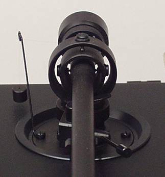

I also had lead in groove issues, what I did was rebuild the arm Q mechanism using 300,000 cst silicone all was good then.
I also cleaned and reset the arm bearings for little to no play, I have no tracking problems whatsoever now.
One thing im looking into is removing the old arm and q'ing and replacing it with a Rega RB 250 or RB300 arm. the geometry is on the money just enlargine the arm mount hole will do the job.
