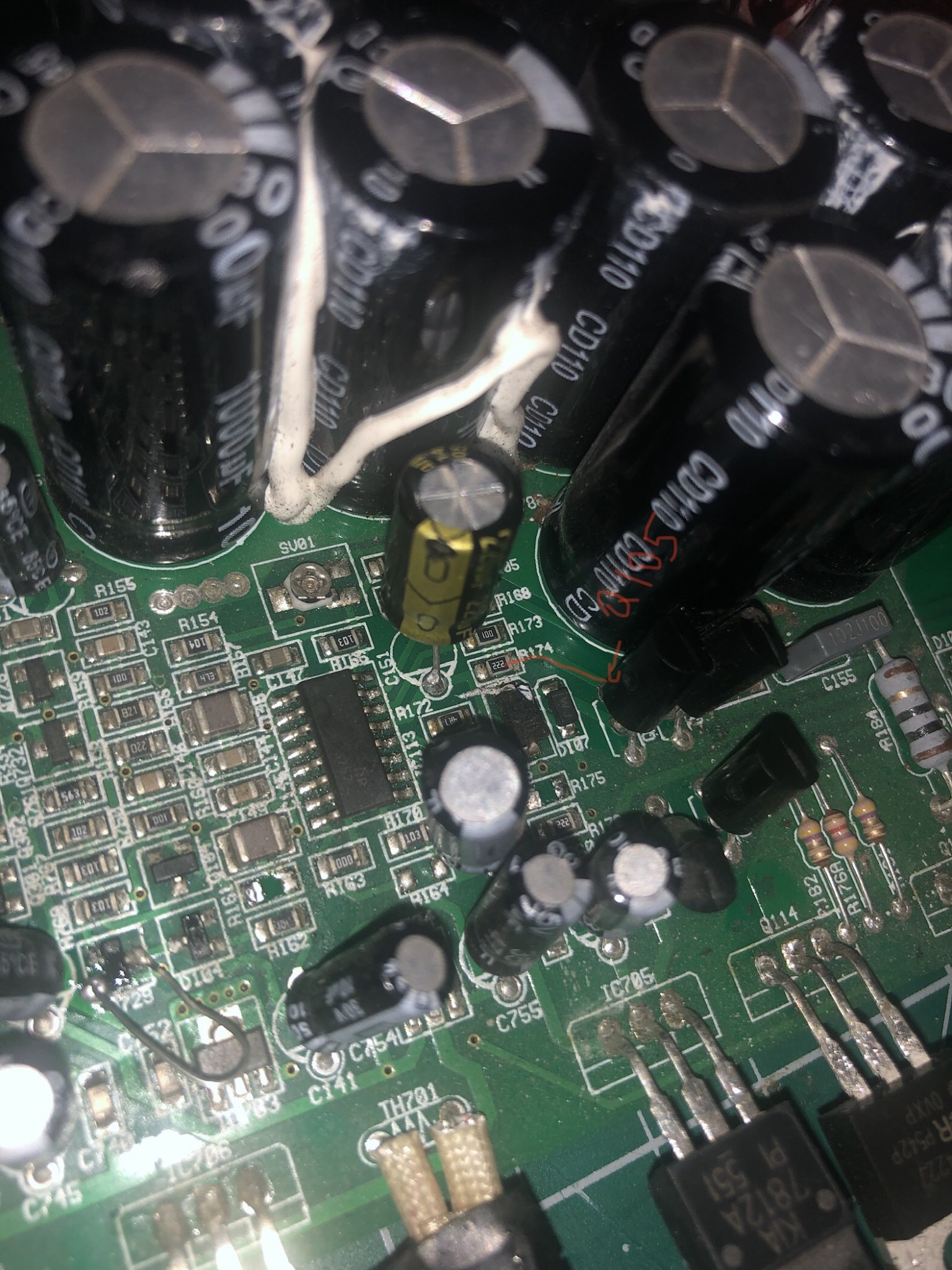

For transistors Q105- Q108, measuring from base to collector for each transistor, what's the lowest reading you get?
What value do you read from the base of Q105 to pin 14 of the 2092?
Remove R175 and measure the resistance from pin 10 to pin 11 again.
The 2092 appears to be defective assuming R176 is within tolerance.
Reading from the base of Q105 to the collector of Q105 should have read approximately the same as test #4 above. Do you still read 20 ohms from pin 14 to pin 15?
Look at the diagram you posted. The collector of Q105 connects directly to pin 15. Does your boar differ?
R173 appears to be out of tolerance.
As far as I can see it’s the same, when I was looking for capacitor and resistor values everything looked the same. I used other models as reference and layout is different.
Carefully follow the trace from Q105 collector to pin 15, checking every possible connection. Do you see any break?
Are you looking at the driver that's closest to the IC? almost touching D107.
Check R175. It looks like it has a hole in it.
R175 is missing (as we removed) before that there is hole in pcb.
And yes I’m looking at the one that’s close to D107.
