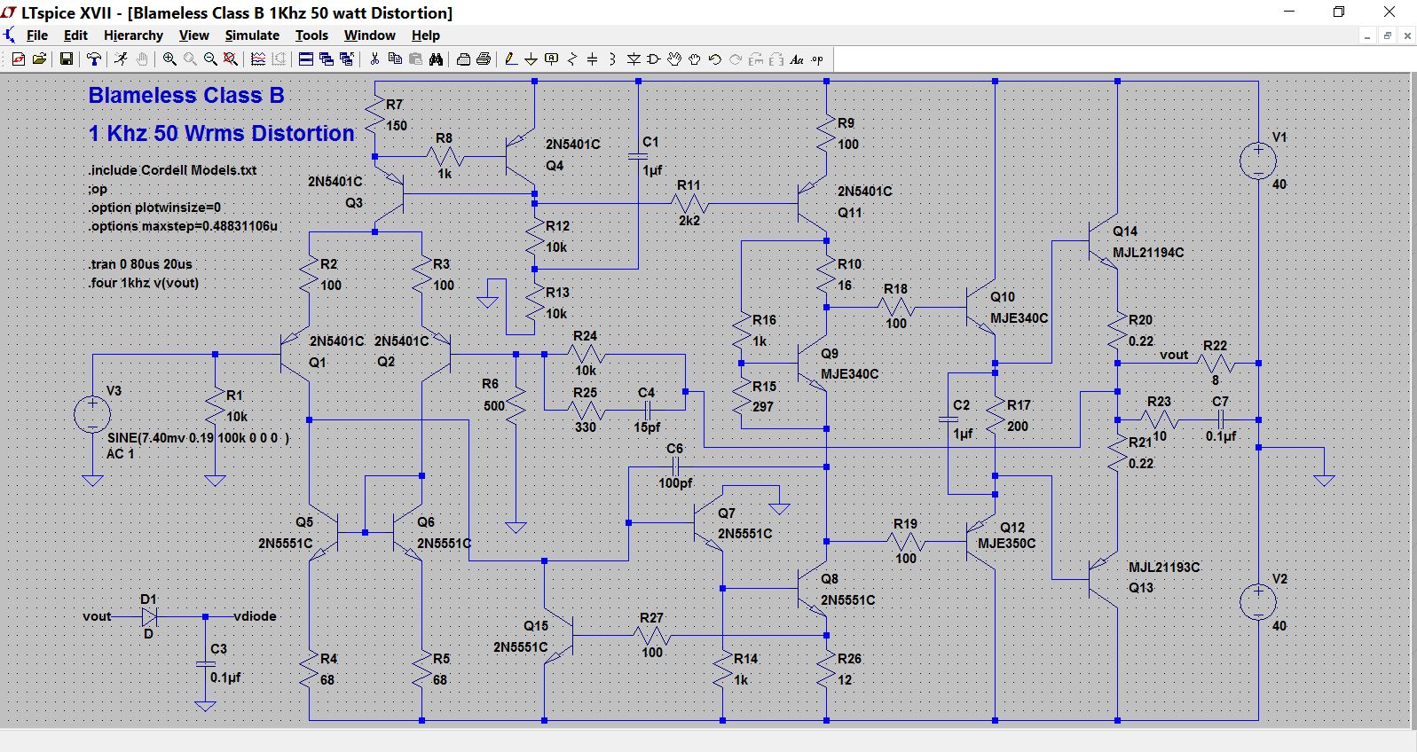

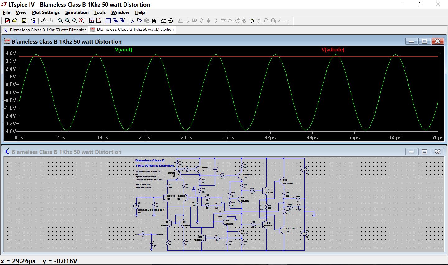

That looks OK. If there were significant AC present then the caps would have a voltage across them. The small voltage you see will be a consequence of the meter being effectively 'floating' because the diode is non conducting.
Look at the bottom left of the circuit here. The output of the amplifier is 4 volts peak to peak, the cap voltage is 4 volts less the forward vdrop of the diode. So any problem below that diode threshold would not register. Having said that, even if there were a low amplitude instability, it almost certainly wouldn't cause noticeable heating.

The diagram is just a poweramp outputting 4 volts pk/pk @ 100kHz. The diode and cap at the bottom right rectify this AC output and generate a DC voltage in proportion to the peak less the forward drop of the diode.
The node vout on the diode means it is in electrical contact with vout at the right of the diagram (the main amplifier output). It just saves drawing a wire 🙂
I guess so.

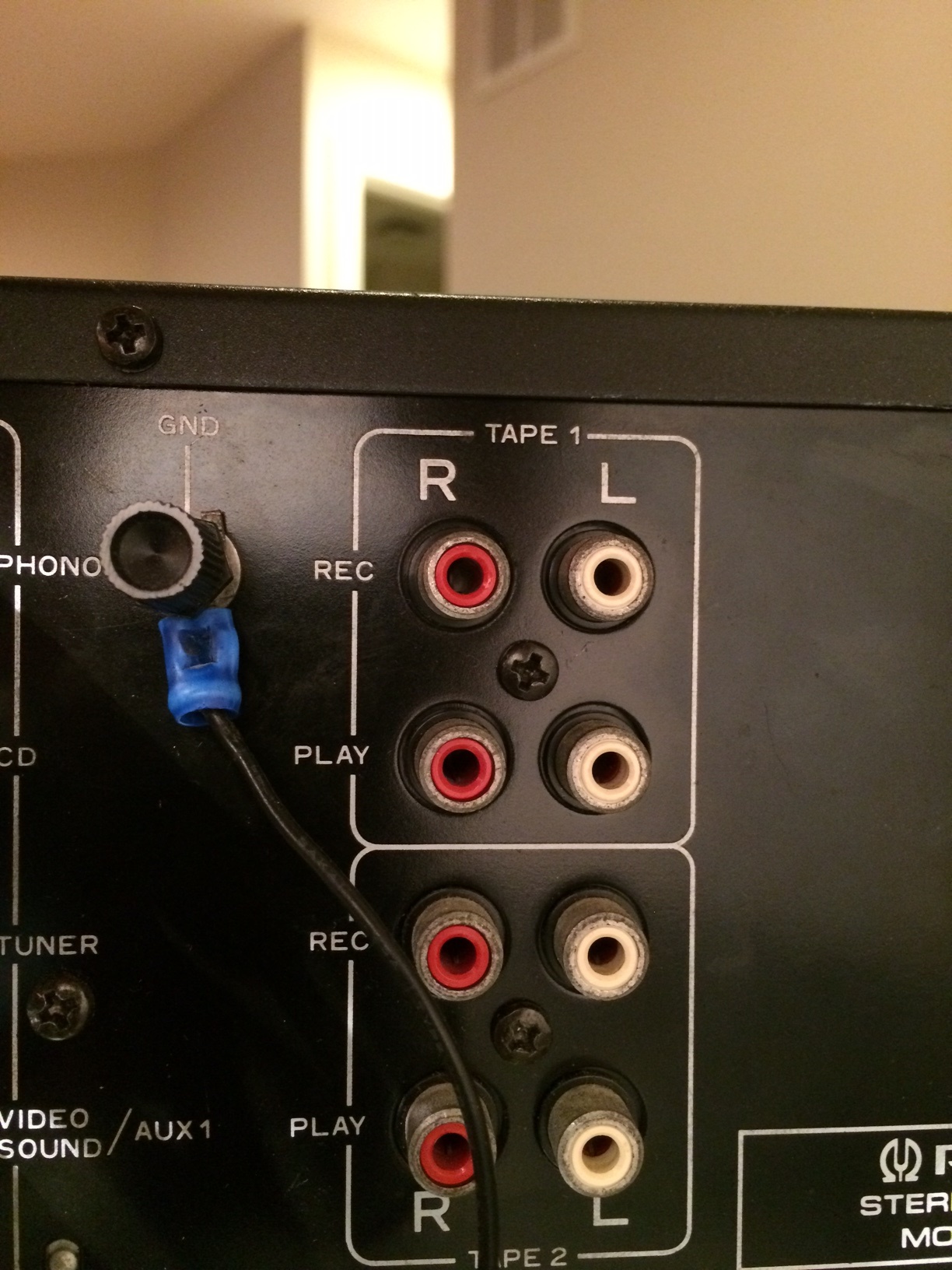

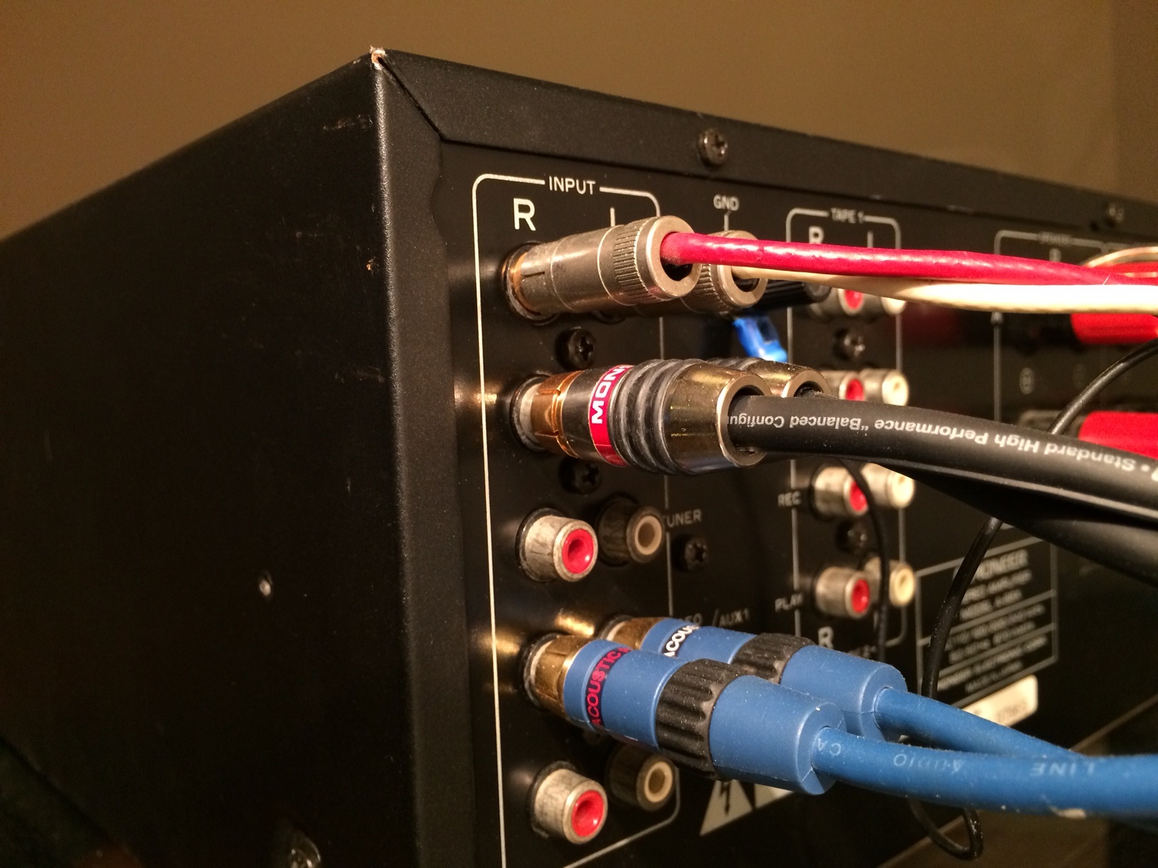

New update/findings
Sunday I moved the amp and entertainment stand as we are painting the basement. Plugged everything back in and went to play a CD and no music. Hear the initial relays click on, and then they clicked again within seconds. WTH? Shut it off and took a look at my connections on the back (RCAs from TT, CD player, Aux/iPod). This was something I noticed when I took the back cover off while working on the Phono/EQ board a few weeks back. The RCA inputs have very small rubber insulators around each jack. Well, when I plugged everything back in, I pushed the connectors on so far that they were coming into contact with the chassis. I pulled them off a bit, and turned things on and music played fine. With newer, heavy duty RCA cables (Monster) it is very easy to push them on too far and have them touch the back of the amp.
So my question is could this grounding of RCA jacks lead to the issues I have been having (bad voltages/oscillation)? This could be why the right channel fixed itself, and the replaced caps fixed the left channel.
I have posted pix of the RCA jacks so you can see there is very little to stop the cable connectors from coming into contact with the chassis.
Its normal for input sockets to be insulated from the chassis because to do otherwise would compromise the grounding and lead to hum/buzzes etc. Each socket has to be grounded to the correct point in the amplifier and not just use a common ground like the chassis.
You can prove the theory by connecting the plug outers to the grounding screw that the turntable uses. I would be very surprised if it caused anything like oscillation.
Sounds like a bad solder joint somewhere. Moving the amp disrupted it bad enough for the problems to come back, and when you fiddled with the amp again it got fixed.
It will probably keep doing this until you fix the amp proper.

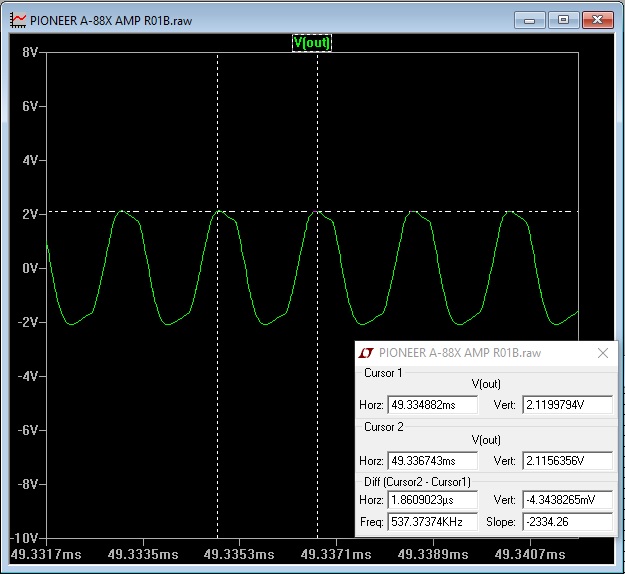

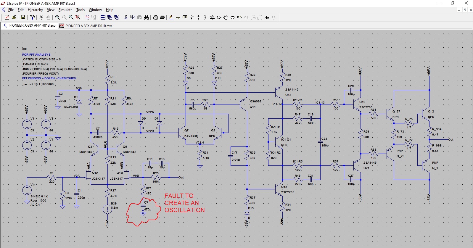

I used LTSpice to simulate the amplifier circuit to see how I could introduce a fault that would lead to an oscillation.
I was expecting to be able to alter the phase shift of the signal around the different circuit stages to get the amplifier to oscillate.
The amplifier is made of multiple stages and I am not familiar with the use of RC filters across the collectors of differential transistor pairs. I wanted to see what could happen if the properties of the RC networks were altered by changing the capacitance value.
RESULTS :
I could not create an oscillation by altering the value of any capacitor.
Altering the RC networks across the differential pairs only affects the frequency response of the amplifier.
From the simulation, it appears that Pioneer have chosen to maintain a flat frequency response. Changes in those RC networks characteristics have a direct impact on the frequency response of the amplifier.
ONE WAIT TO MAKE THE AMP TO OSCILLATE :
The single way that I found to make the amplifier to oscillate is by removing the reference to the common ground from the feedback network. See the jpgs enclosed.
