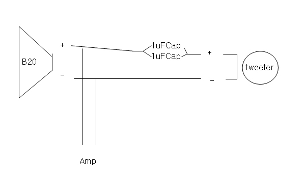

Do u know if I use 1uF what freq am I adding the tweeter in?
This is a set of guidlines i use to estimate XO point...
2 uF on 8 ohms is a 10k XO, Halve the cap value and you double the XO point (ie 1 uF = 20k), Double the cap, halve the XO (ie 4 uF = 5k)
Halve the impedance, you need to double the cap size to maintain the same XO, (ie 4 ohm requires 4 uF to get the 10k XO).
Double the impedance, you need to halve the cap size to maintain the same XO, (ie 16 ohm requires 1 uF to get the 10k XO).
So 1 uF on 6 ohms = 30 kHz. 2 uF = 15k, 4 uF = 7.5 kHz. So i'd start at 2 or 3 uF and add small caps until you start getting too much top, then back off a bit.

gychang said:
Mike and Dave, I have trouble with visualization of what u r suggesting, any photo of the setup?, somewhat reluctant to invade the cone with a scalp knife.

Veil has been lifted, shocking!!
If you have been following the thread, I have been disappoinged with B20 in the Chang cabinet.
I installed the $5 tweeter pictured above, and with help from everyone I installed with 2uF cap, shockingly different sound. Clear and with airiness, can't believe the change in sound. First song was Lee Ritenour, Color Rit. I am sure those are steel wires on his guitar, twinge of high notes are shockingly natural. Truely spine tingling. I now know the other speakers I have been building is not in the same league. Compared to my reference "zigmahornet" with Dave Merrills drivers, it does not place the instruments in the space as well, but overall sounds more full, in particular orchesteral music is much better in the Chang. Without the tweeter, James Taylor had a touch of sinus condition, now he is cured. Do I seem excited??, yes shockingly so. Amazing what science and cheap tweeter can do.
thanks everyone, Scott, Dave, and Ron can be rest assured they have a winner here. Muchos gracias!!.
