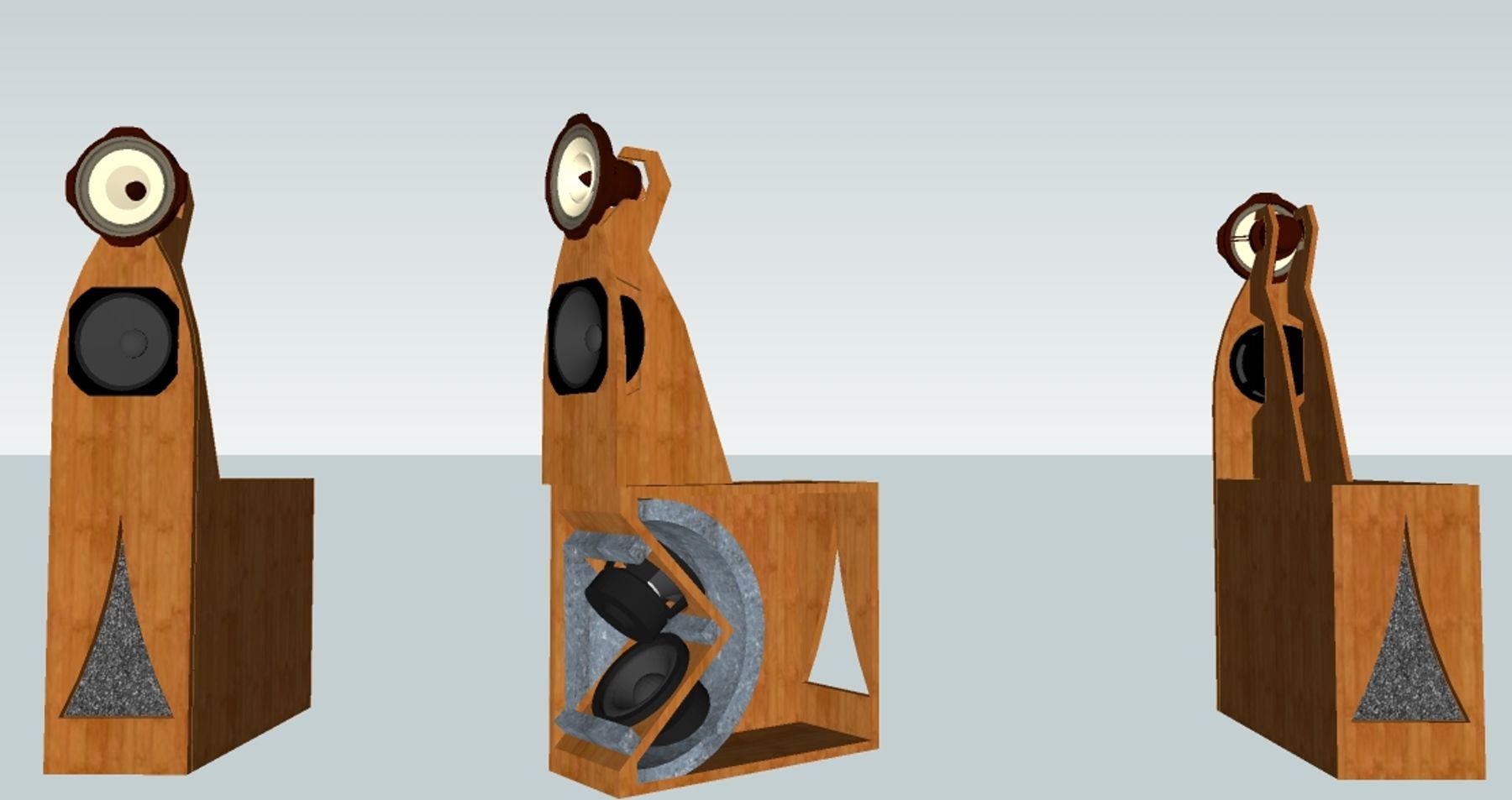

I do have two OB experiments coming up, so I will learn first hand just how much crow I must choke down. Attached is the second of these, utilizing the lovely omni characteristic of the Lowther PM6A.

Dunno, I just responded to a specific situation. A typical dipole has a rear mids/HF output that's lower than the front's, so all else equal, the front radiation ~completely dominates.
My SWAG though is that the 'softer' on-axis resolution of the EnABLed front radiation is being excessively 'modified' when summed with the relatively more harsh/gross out-of-phase rear output. Taking this assumption to an extreme to clearly hear the problem, listen to a mids/HF compression horn, then remove the driver's rear cover to turn it into a seriously misaligned BLH and listen to it facing the exposed diaphragm. 'Musical it ain't'.
Note that a 'nude' driver has very little front/rear delay until it's beaming pretty good at a reflective surface whereas a baffle delays it enough to isolate it to room and baffle reflections.
