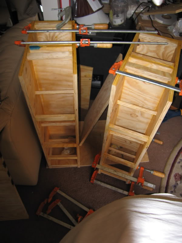

The TL was built with added bracing and a removable bottom, but more importantly, a very mild front horn load
you wouldn't happen to have any pictures of this would you?

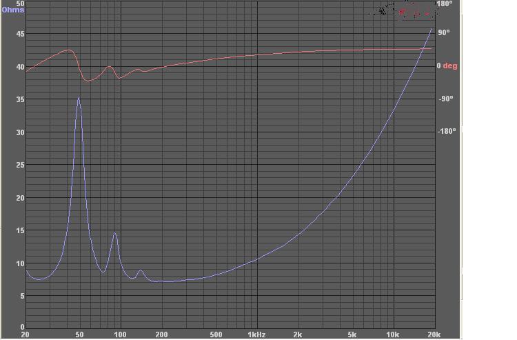

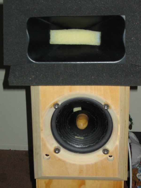

Impedance, bracing, and baffle
3 quick images- impedance sweep, shot of the bracing, and the short horn/waveguide in the baffle. I've since hit the baffle with a coat of black appliance epoxy. It's a lot less fugly now.

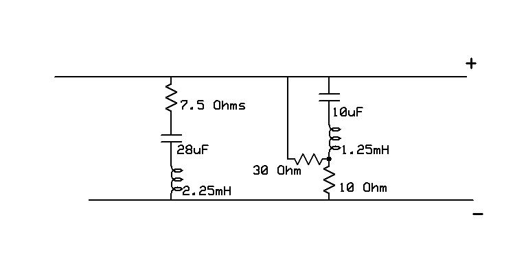

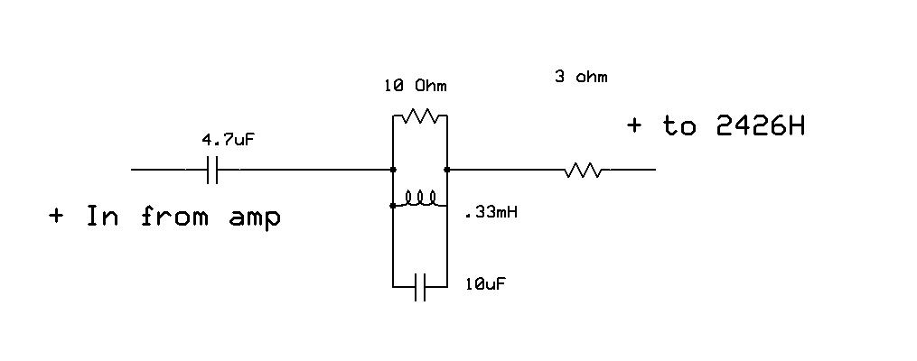

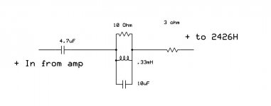

The lowpass was about 1200. The crossover was a simple textbook 2nd order lowpass on the B20 (1.8mH, 10uF IIRC) with the attached as a high pass on the JBL 2426H driver. The lowpass would need additional refinement though. The highpass obviously has a lot of frequency shaping- horns aren't easy for XO design!
The shown XO is for use with a large 15", the version used with the B20 had the 3 ohm swapped for 4, and an l-pad between the notch filter and the series resistor, turned down about 5dB. And for those who aren't clear: The first image is the impedance correction for the 2426h, the second are series components doing the XO/shaping on the 2426. This XO does NOT bring up the >10kHz content, this driver is heavily damped in the top octave.
