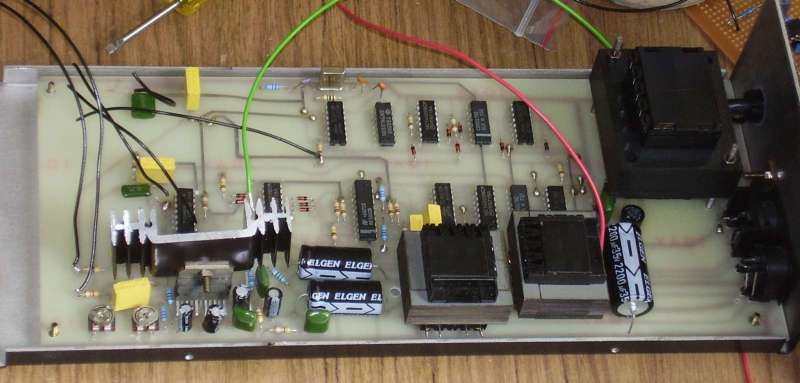

Check whether there are two sine waves at the two resistors on the left of the board (where the two black wires are soldered in in the attached phot). If so the CMOS generator is OK.
Next check whether there are two (higher magnitude) sine waves present on the left side of the two big caps between the TDA 2004s and the output trafos. If so the TDA 2004s are OK. If not the chips themselves are probably toast.
Lastly check whether the same voltages are present on the right side of the caps. If so the caps are OK and only the trafos remain as the source of the problem.

Unfortunately I never finished tracing the PT Too supply circuit out completely. All I needed was to work out where I could take off the various logic levels for the speed control switching and where to cut into the circuit with a new generator module.
The phot I attached to the post above shows the wires attached at these points (plus the 12V PS takeoff).

Hopefully here it is:

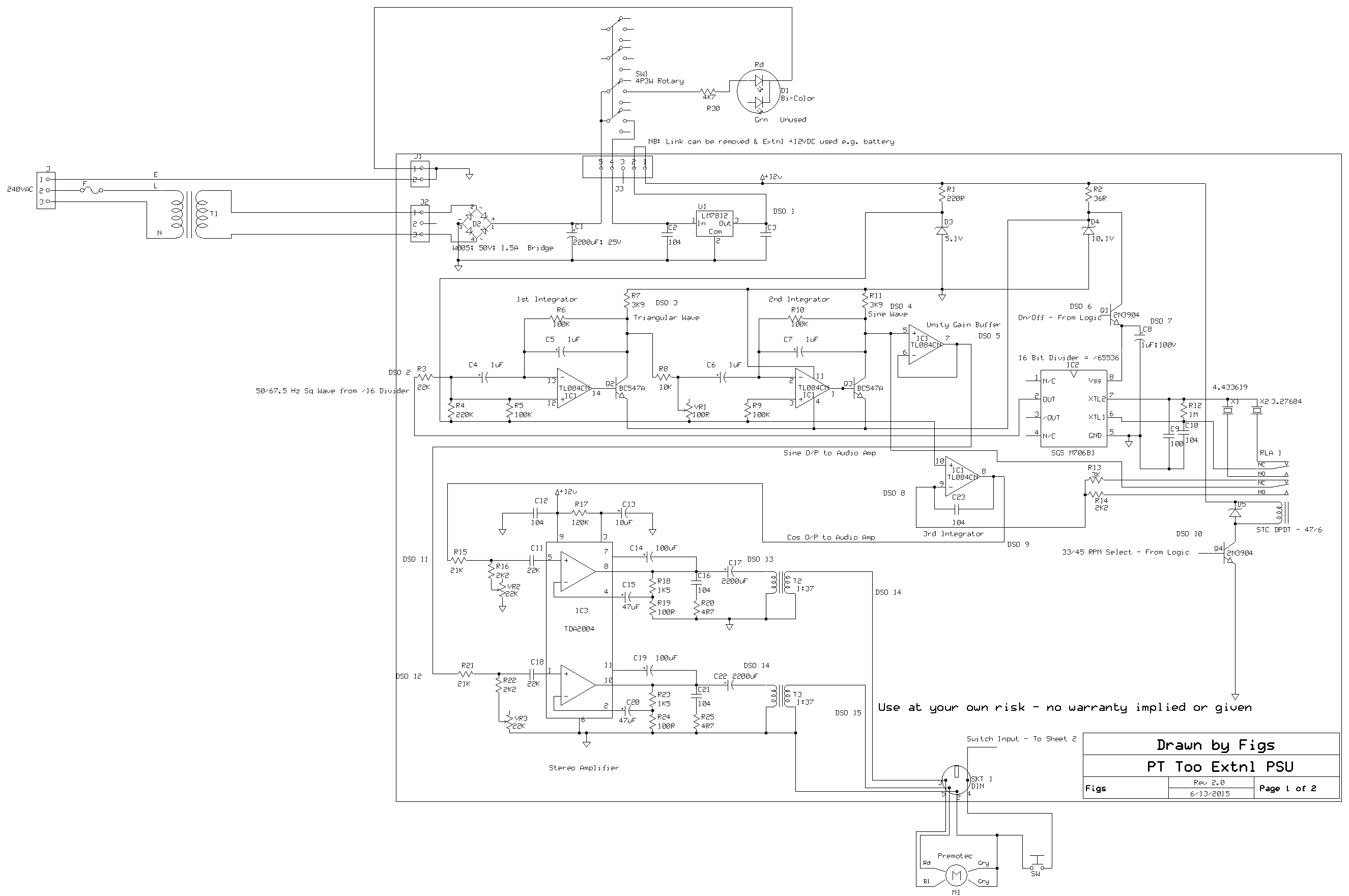

Having scoured the web, for info, I finally decided to sketch out the circuit to help troubleshoot. This is attached in .pdf. Note that it is incomplete - the control logic is not included and frankly I ran out of enthusiasm.
In the end it turned out that the voltages to the motor were severely distorted (yep even bought a scope). Turned out that the distortion was emanating from the 2nd integrator stage. A slight adjustment of VR1 cured this and now everything seems back to normal. I can only guess that VR1 was acting up as adjusting this full seems to create the same effect.

  • ExpressSCH.pdf
    ExpressSCH.pdf

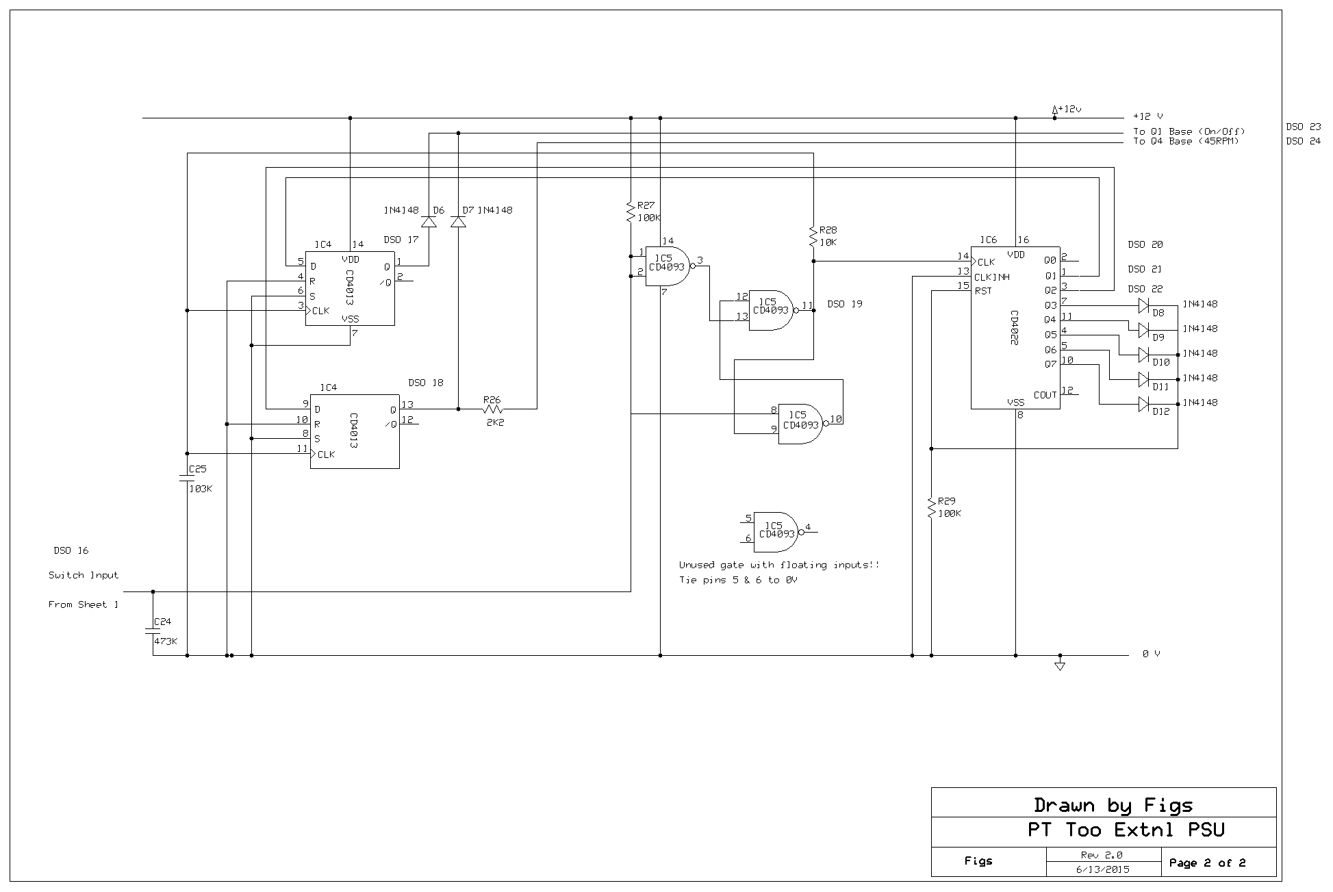

Updated PT Too Circuit Diagram
Had some spare time on my hands :xeye:
Some errors on the original have been corrected and the logic control section has been added.
