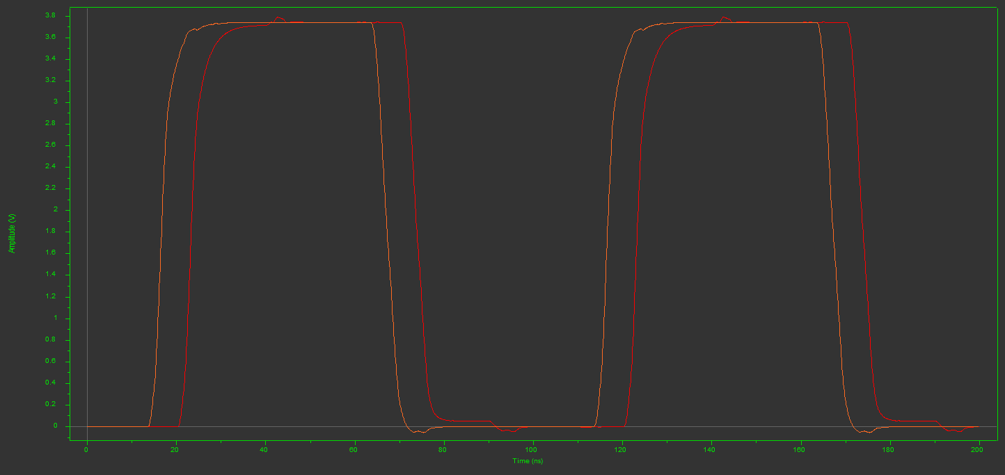

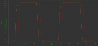

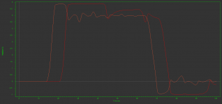

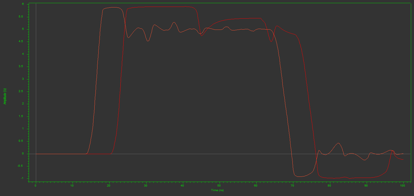

I did a lot of sims on my signal integrity software for SPDIF signals different cable lengths etc., I do know where this idea came from and will try and find the thread where the sims showed cable length is not really a factor and using a long cable is not the best, a 75R resistor at the receiving end does wonders for the waveform though.
A couple of the sim results, for the record both waveforms would be correctly read by the receiver and would not result in a different sound...
The picture on the left is 1500mm cable un-terminated the right cable has a 75R pull down terminating resistor at the receiver end...

Eye diagram basics, I was going to say that the only real effects on ringing and overshoot (as long as the rising and falling edges remain monotonic) is a slight closure of the eye diagram and more stress of the receiver device due to the excess voltage leading to the silicon getting a bit hotter than it would with a nice wave. Dr Howard Johnson devotes a whole chapter in his signal integrity book to termination schemes to reduce and absorb this extra energy.....
