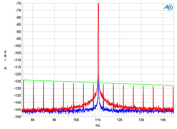

Here is an old Stereophile article from 1993. Old yes, but would it still apply where jitter is concerned?
A Transport of Delight: CD Transport Jitter | Stereophile.com
Lots of measurements and graphs. I am not an expert when it comes to digital by any means. I only know the basics, and what I have learned from reading.
Jim

The only jitter that matters is at the clock pin of the DAC chip. And generally, it is far, far lower than any hearing threshold, which is why jitter "demonstrations" have to be rigged in a very non-physical way.
Reading is a good thing; trying to learn about technology from a comic book isn't.

1992 called and wants its boogyman back. See the green line? Below that is where you want to be. Oddly all competent DACs are. If you spend a lot you can get crappy performance
