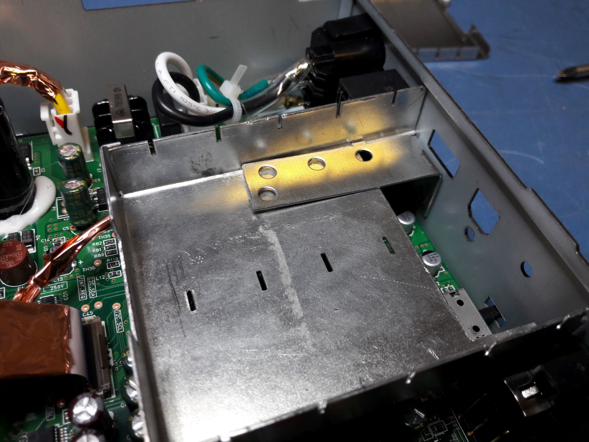

Step 1 is finished
Hi

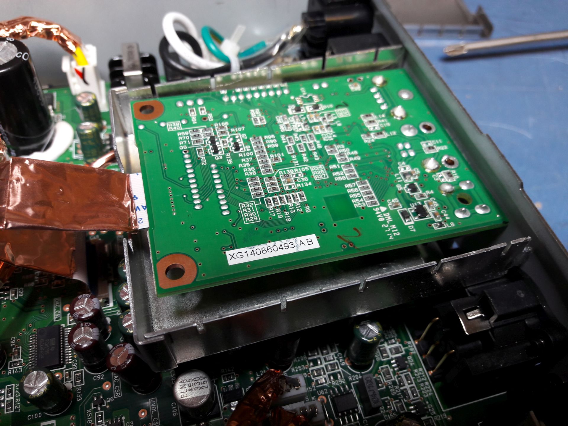

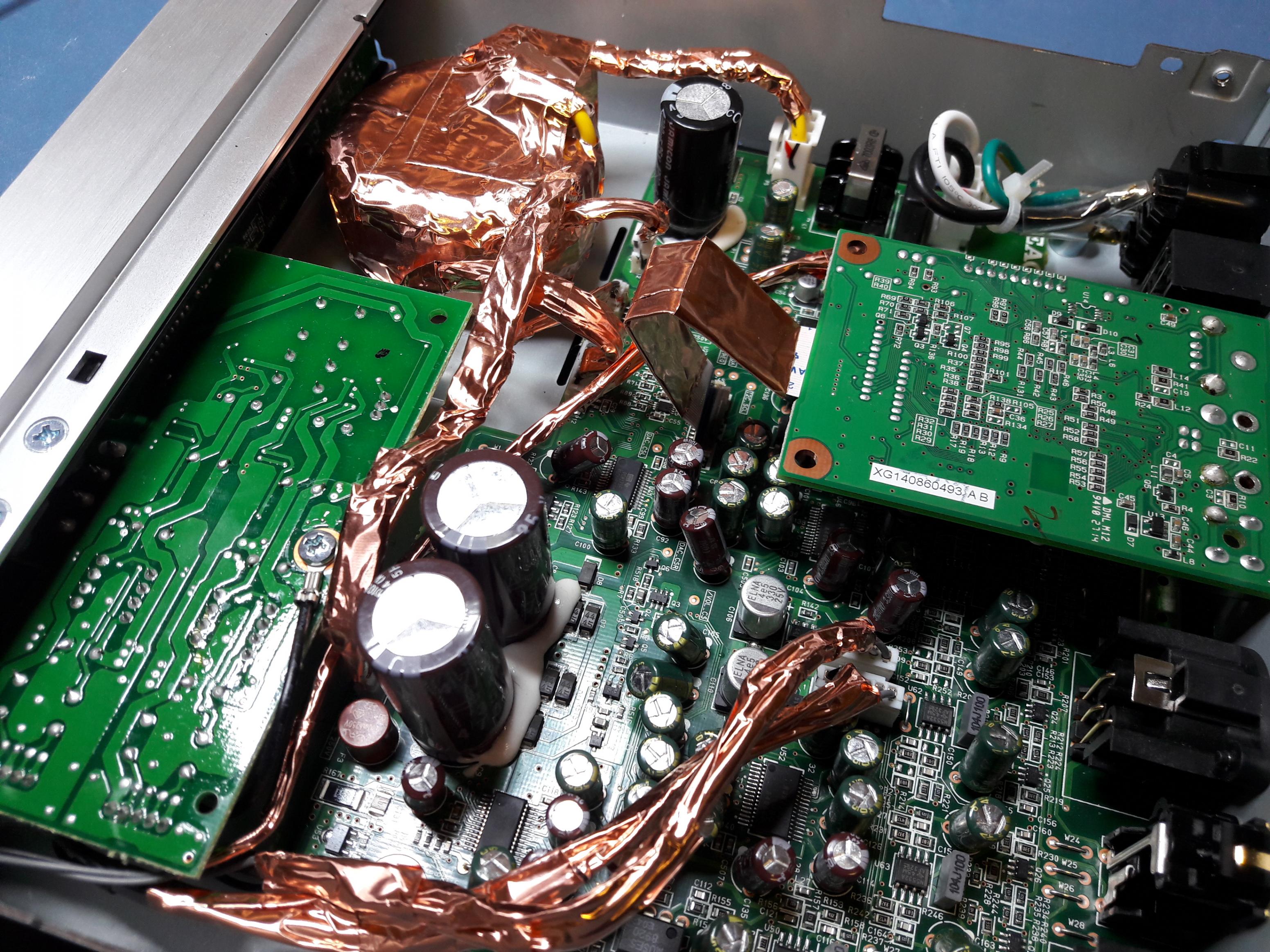

first of all i am really a noob. this is my first audio project. After 25 without school i have to restart all my things in my head...
After more changes than planned the first step is for me done.
i want to keep the time and cost as low as possible.
for every hint i am really happy
I changed the 4x bigger Caps becuae the device was bought second hand i recognize that the owner use it all day long and since 5 month for TV and music and DVD,etc....so i decided to chnage the KMG, Jamocin 4700µF and the smal 470µ from jamicon. The 60pcs green suncon and red KMG i keep.

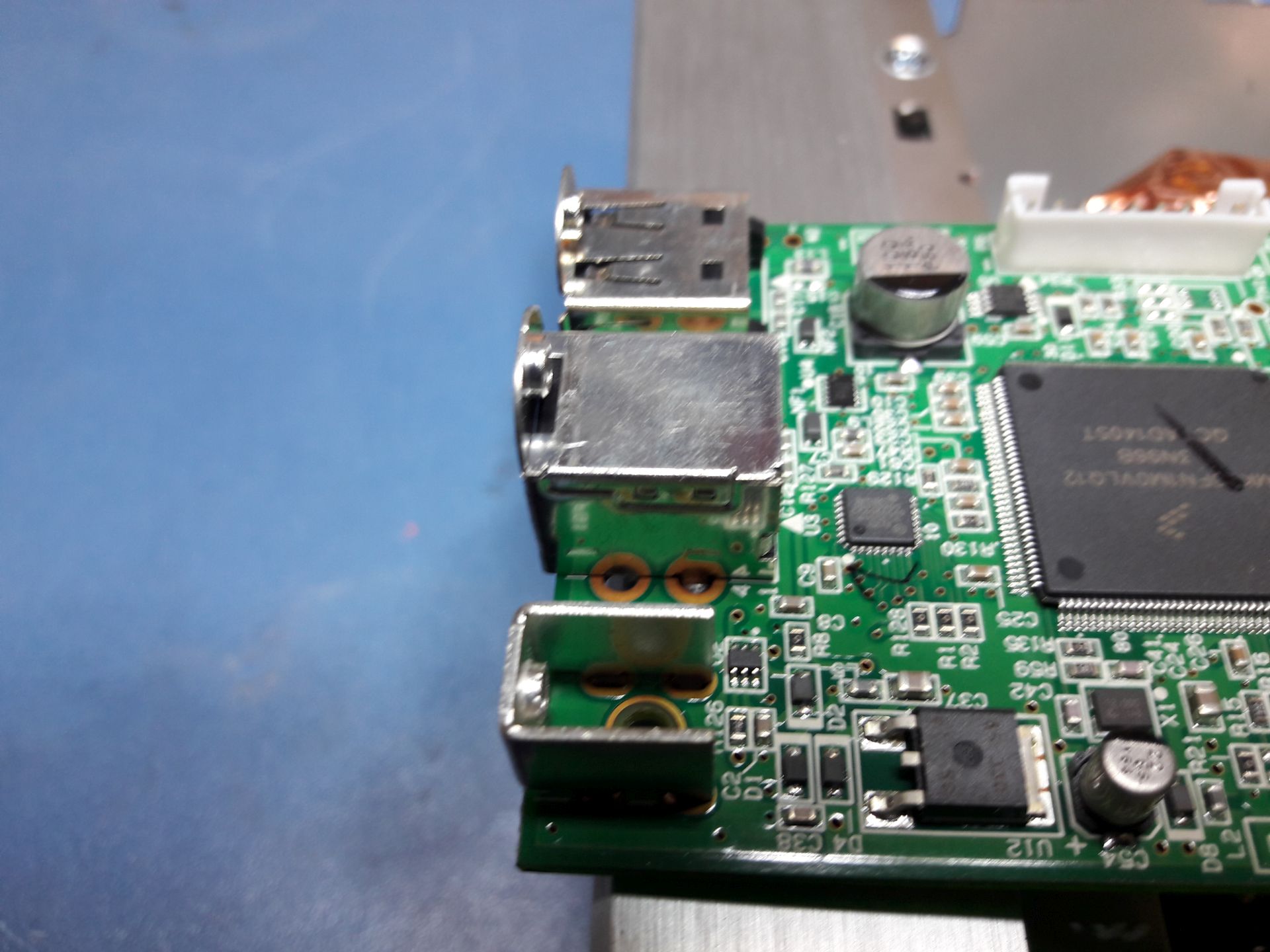

XLR connectors i use a similar product from Neutrik. the gold material is little big thicker and ith weight the same (7g the old and 7g the new)
The RCA connectors i don not change - i prefere xlr
the housing was really terrible to build because the top deck of the DAC has some aluminium fins in the inner side.
The SPDIF
now i go directly to SPDIF not to USB because i am using the mutec as DDC. up to now i have the best result with this device - its always better on every DAC i tested.
To change the SPDIF connector i have to throw out the toslink - and i have to connect with some cable directly on the pcb - maybe in the next step - step 2

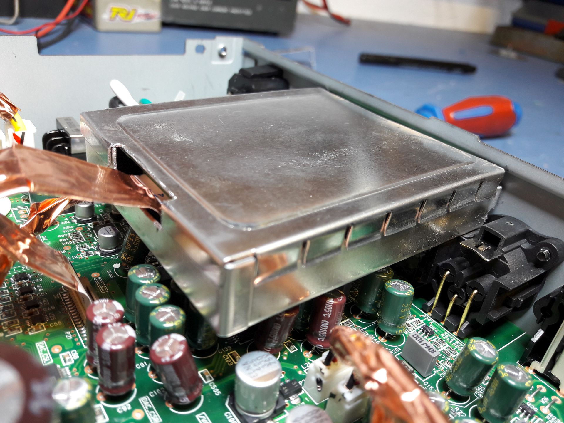

finally i connect all foild covers to ground.

Glad to hear it's better now. I'll bet the numbers are the same, but better parts nearly always perform better.
Have you considered snubber capacitors/resistor on the rectifier diodes?
Also, if you can identify the capacitors that decouple the digital supplies, the solid polymer capacitors work great there. I am not sure if the supplies are shared between analog and digital on that unit however, in which case it will be better to leave it.
Also, if any solid polymer capacitors are used, the small ceramic caps will need to go, since they can resonate with the new parts.

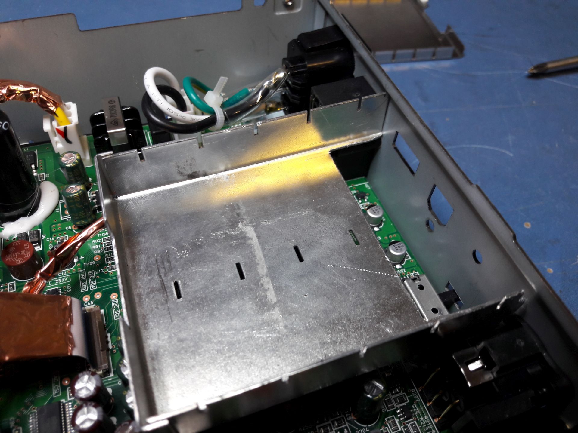

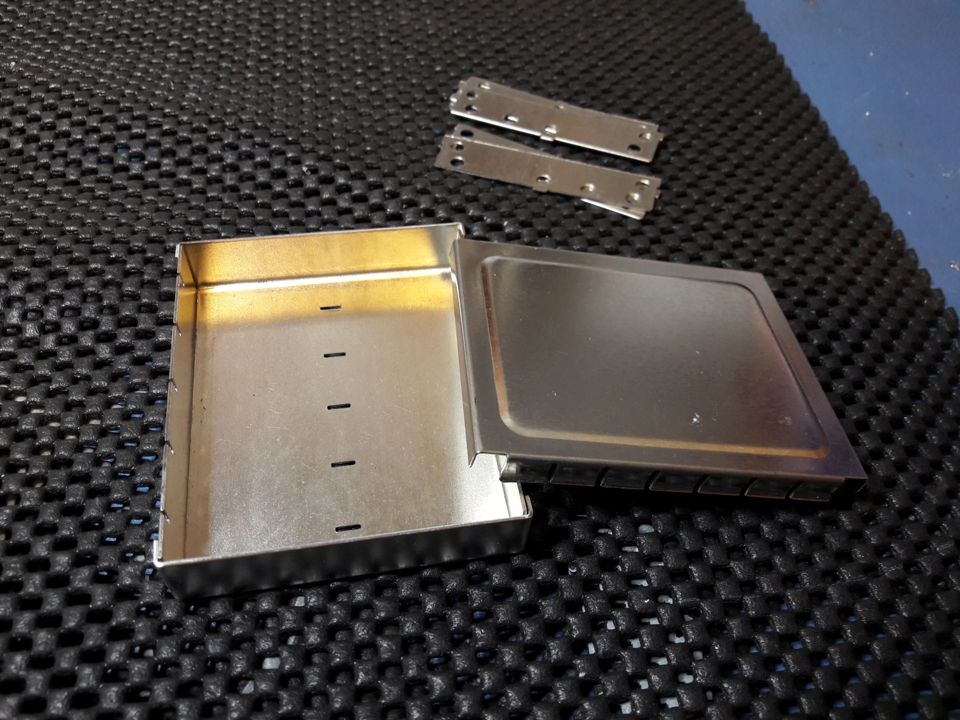

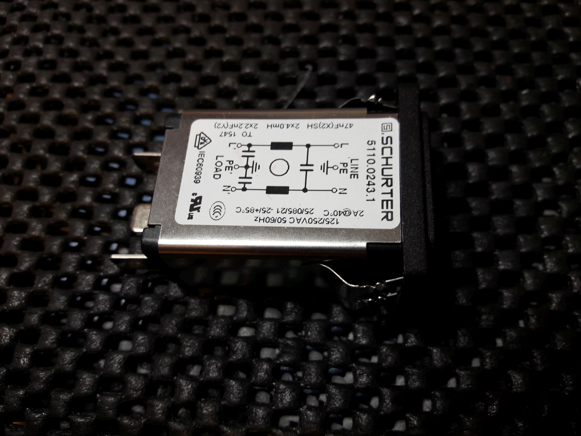

In a german forum i get the advice to move the toroidal transformer 90° away because of lackage where the cables come out . he prefere for digital circuits EI trafos or put the trafo out of the DAC. Also the foil over the cable are not always good he mentioned- e.g. over the protection housing i got some peaks! - so the interference of the trafo goes over the foil to the cable where the USB case is???!!!
look at that, i made some measurements:
Whats a snubber cap?
No, i did no additionally changes now.

Shielding is all about slots and seams, any slot in shielding can make matters worse not better as they can act as a waveguide.
yes i think so, you are right.
but it sounds better, never the less i have to try out without shielding once again.
with one device its not easy to compare.
Try to make wires that are connect to yours copper shields shorter and compact.Or u can tray connect shields directly to chaisis.yes i think so, you are right.
