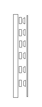

Optic, be aware from here on in. I have thought about this long and hard and have not convinced myself that I have the answers.
Your panel will need to be held to it's frame by all four corners (including the top - most importantly!)and probably two sides as well. What to use?.........read on>>>>
There was a link from someone a while back on ''grounding'' the exciters - an article by TYMPHANY I think?(it is important that you read this).
Here they use a silicone rubber to firstly apply to the exciter and then position the backing plate on to the back of the exciter, creating a compliant coupling for the actual exciter's magnet which was previously moving back and forth in it's ''free mounting'' method(not really ideal for long term).
I think this method will ensure that any drop in panel level due to gravity will be taken up by the elasticity of the panel mounting and exciter backing material(which is the same).
To me, this would suggest that the panel is firstly mounted to the frame with this silicone rubber substance, then the whole assembly placed face down on the floor.
Then,the back of each exciter receives a blob of the same silicone and the holding rod or suspension bar is secured to the back of all the exciters .
This then makes contact with the exciter, gluing it to the suspension bar, brace or whatever you'd like to call it.
In theory, when everything is dry, lifting up the panel in it's vertical position, any vertical drop of the panel itself and the attached exciters,due to gravity,will do so EQUALLY due to the silicone elasticity of the panel coupling and the exciter/brace coupling if you know what I mean?
I am open to other's thoughts on this.

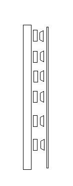

NXT have mentioned that leaving the exciters ''free'' (not grounded) will eventually cause ''voice coil creep''. No need to guess what that means

greenvalve, you don't need any impedence matching transformers for the sound pads.
The links you have provided are correct. The Dayton soundpads are basically the same as the Sonic Impact ones but cheaper(?).The Gatorfoam I used was the 5mm thick black with black core.
The piezo transformer is only for use of a piezo as a DML transducer. But, it will need a woofer to fill in the lower frequencies - the sound pads are full range.
Ed, the panels present a calculated 6 ohm load to the amplifier. This seems to make a big difference with the Pioneer (I had to change the speaker impedence setting from 8 ohms to 6 ohms due to the PTC resistors on the exciters kicking in at higher levels at the 8 ohm setting only
I would say that with 6 exciters wired for 6 ohms impedence roughly, an amplifier power of around 10 watts minimum is required. As the 845 was only 4 watts, I would estimate that at 2 watts the panels revealed the amp's weakness without mercy.
The panels are indeed fussy beasts. They will reveal low power valves in an instant. If you like your music played at soft levels with an active preamplifier, you'll be o.k.
However, if you're in the mood to blast the paint off your walls, higher power, most likely in the form of solid state is the way to go. High powered valve amps will of course do as well but to me it seems like S.S. is a better partner in this revealing set up?It's just my opinion and observations though......don't take this as gospel
Another thing my ''Ziggyplanars'' love 16 guage vintage magnet wire as speaker cables. When I say vintage, I mean 40 years old with a coating that is orange and WILL NOT BURN with a naked flame what the hell would that coating be? You can only scrape it off with a scalpel!
Anyway, it sounds FANTASTIC!!....best cable ever....and I have a few expensive ones.
