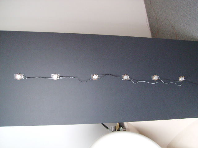

Changed the speaker impedance setting on my amplifier to 6 ohms (didn't realise it had that option), so I wired up the panels for 5.4 ohms total impedance. A multimeter reading shows each panel at a DCR of 4.4 ohms, so I would presume that this is pretty close to 6 ohms as required.
RESULTS ON SOUND QUALITY? : after some sound pressure level readings compared directly to my two way horn system that are 103 db, I have approximately (this is with simple equipment and judgment by ear) 92db efficiency from the panels. Not bad at all.
The output is naturally much louder than my wiring mistake disaster previously.
Bass output has entered a new level - even deeper, richer and makes the overall sound fuller than they were (and that was fine already!).
So, I guess that's it. I have succeeded😉 😀 😀 . The horns will be sold off from here on.
Basic summary of this whole experience and my recommendations and advice :
Don't disregard the NXT technology.........you will be very foolish to do so.
You MUST have a VERY LARGE suitable material as panels to obtain impressive bass, mids and highs.This is CRITICAL!
You MUST have multiple exciters(vertically and evenly spaced) to drive this size of panel and obtain the efficiency and reasonable power handling.
You MUST remove the exciters from their casings if you buy the ''Soundpads'' as your source for the exciters.
You MUST use the correct double sided adhesive tape to secure the exciter to your panel : 3M Adhesive Transfer Tape F9473PC.
APi said:

Ziggy,
Some problems I see.....
The exciters act much like a traditional point source at high frequencies. Since you have basically created a line source, the large spacing between the exciters is sure to create some combing effect.
You should really attach the back of the exciters to a solid object. This will help greatly in the lower frequencies. Not only will it help limit over-excursion, but it will also turn the panel into a more traditional linear driver at lower frequencies.
The plastic housing of the soundpads act as a mechanical high pass filter to limit low frequency excursion.
theAnonymous1, yes, you are quite right and the rear brace will be used in the final assembly/frame.
Ran some test frequencies last night from 20hz - 20k and observed levels and panel behaviour.
Here are my findings :
The response at the low end of the scale before ''grounding the exciters'' as theAnonymous1 has stated, is approximately 3db down at 40hz. At the top end, I can hear the 16k cut off and then nothing at 20k (not bad for 52 years of age, eh?).
At 50hz, there is a strong vibrational rattle which I initially thought was an exciter problem or wire touching the panel. It's actually the panel itself and will cease rattling the moment both sides are gripped lightly with my fingers, or touched at the back near the middle exciter. Interesingly, I only notice this on one panel and not the other.
Then again, the two panels do not have their exciters mounted in exactly the same positions - quite the opposite in fact - they were just placed anywhere that looked like a straight line and roughly spaced away from each other as a quick test and have remained there since.
I would presume that this resonance is pretty close to the panel's actual resonant frequency at this point in time, and I expect it to shift or hopefully be a non issue once everything is mounted and suspended in a frame with rear bracing against the exciters.
I have received the adhesive mounting rings from NXT yesterday, so it's all accurate measuring and positioning from here on in.

NXT definately recommends grounding the exciters for a'' more durable system''. So, the back spine will hold the exciters up against the rear panel with silicone rubber acting as a form of ''compliance'' 😉
