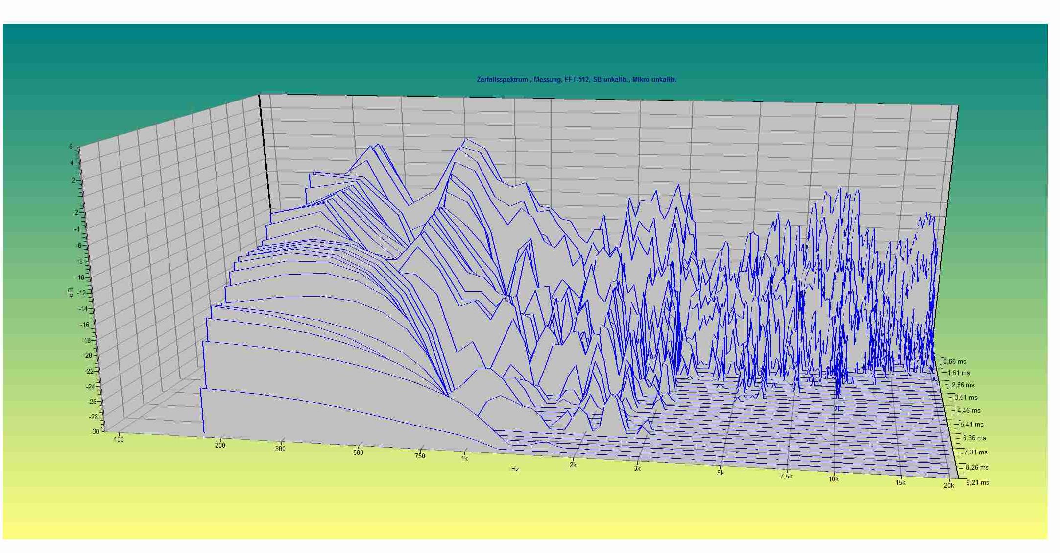

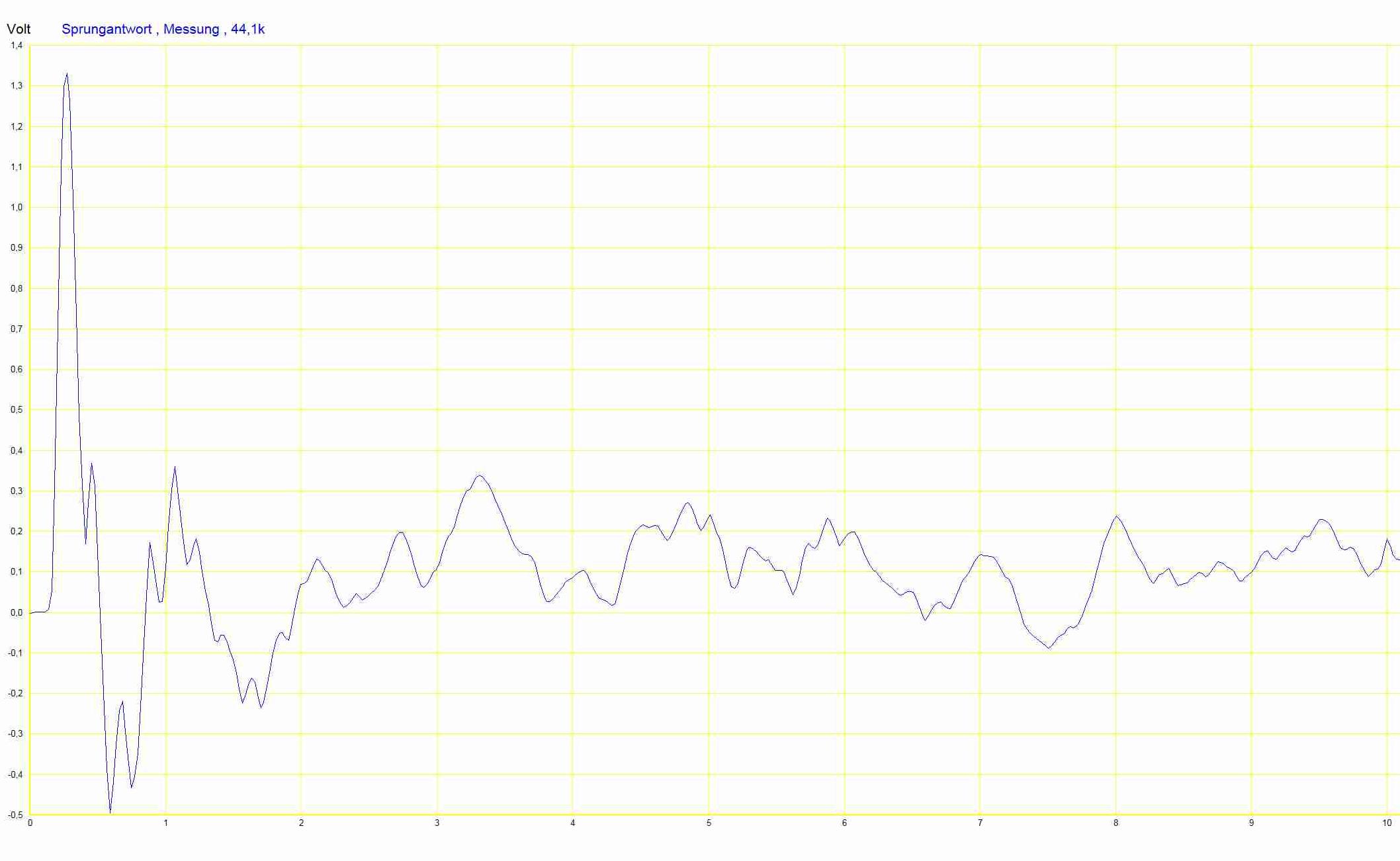

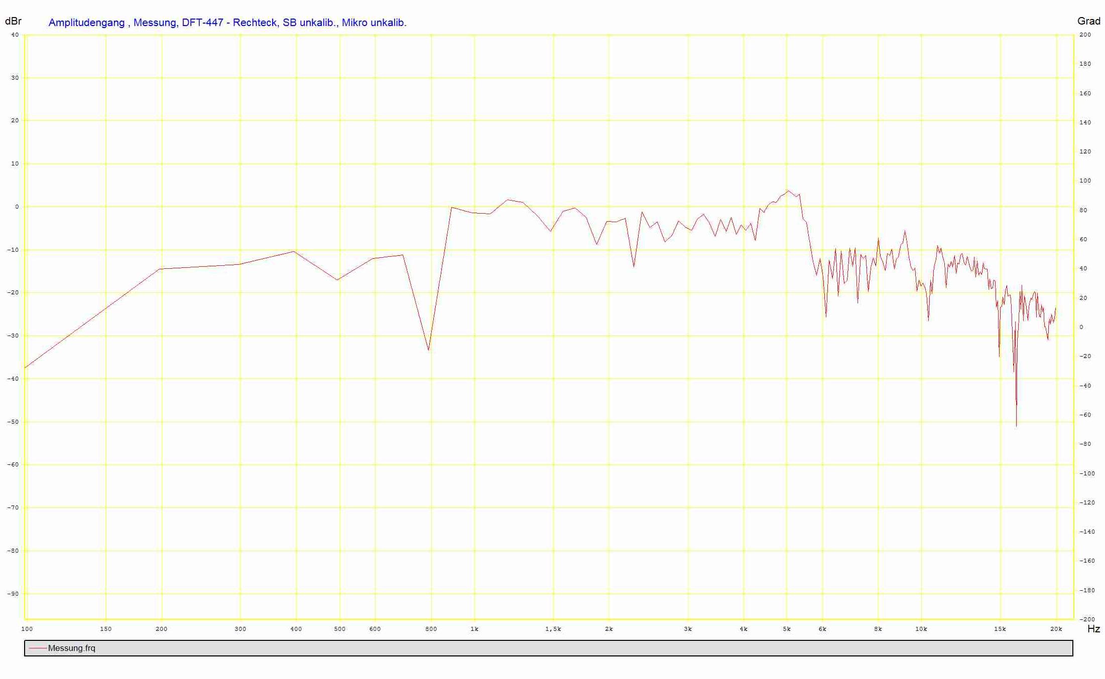

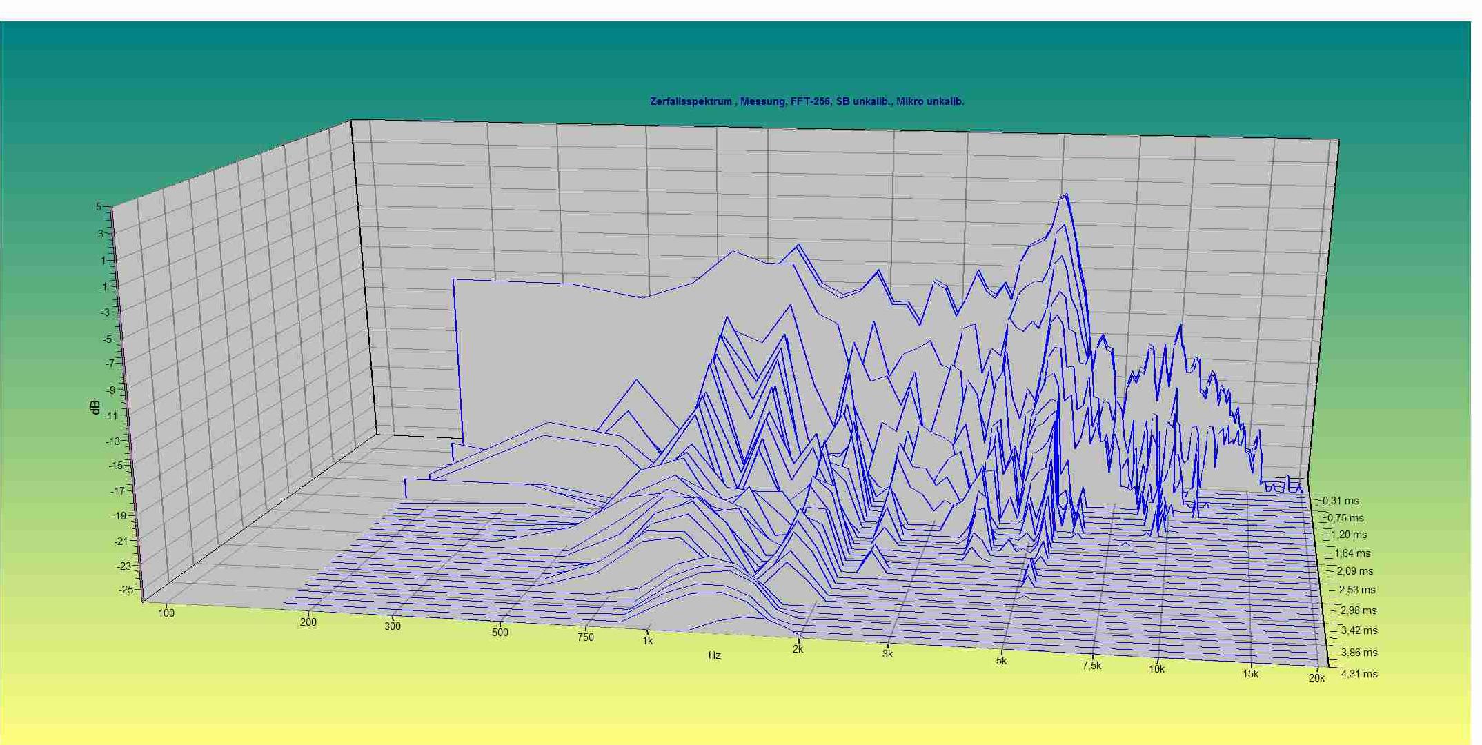

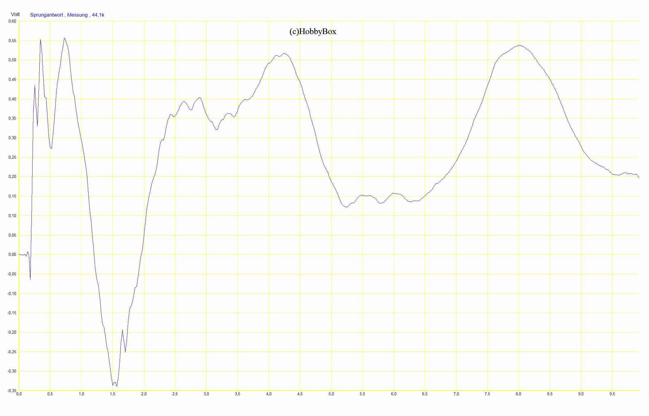

I do not have systematic measurements on different materials
under same conditions.
But the following called "A1" is from stamped aluminium sheet-
quite similar pattern like your prototype ...
And the one called "B1" is balsa wood.
As i said mounting conditions and measurement conditions are
not comparable, but may give a tendency.

Interesting graphs!
I would not have guessed such a nice frequency response from both materials. Especially the aluminium looks nicer then expected.

Interesting graphs!
Hi mikesbmw,
that ALU prototype must also be burried somewhere in here ...
The AL sheet had little patterns like pyramids stamped on it, so it
does not sound like a flat sheet. Sonically it was OK up to the midrange
region. But it had rather sharp lobing, which caused severe changes in
presence and brillance region when you moved your head a little.
I tried to heal that with some kind of "phase plug" or diffuser. That
helped but the underlying problem remained.
The problem might have been, that the wave propagation on the
material is very fast at high freqiencies (large bending wavelength) and
the sheet was rather small (approx DIN A4). With smaller bending
wavelengths on slower materials the lobes get finer distributed over
listening angle, so they are in best case not detectable - auditively -
anymore as you move around.
As you can see, there is ringing even at the high frequencies, although
the sheet was clamped at its edges using highly damping materials.
So: The graph looks better than it sounded actually !
(And i bet, in that case the problem was even unhealable with DSP ...)
