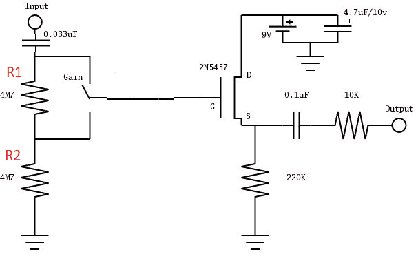

I am looking to build this piezo buffer circuit. The designer has advised me: 'The usual input impedance of my circuit is about 4.8Mohm. It would be possible to increase the value of the 4.7M and 10M resistors if you need higher - mostly they are there to bleed off any DC offset.'
From this, I have determined I need to change the resistors marked below.
I'm hoping anyone here can tell me what resistor values I should use for R1, R2, R3 for an input impedance of 10Mohm.
The above circuit will cause exposion sounds if sensitivity is adjusted mid-performance.
Remove R1-R2 and both input caps and connect pickup straight to R3.
You can also lower 220k source resistor to, say, 47k or so, even replace the series output 10k by a 1k.
You don´t "need" attenuation, your pickup is not that loud.
If possible, build preamp in a small metal box, Altoid tins are fine, and mount it on your Bass.
Is this referring to my original circuit or the one proposed by PRR?
Yeah, I'm considering removing R1, R2 all together, but I will build it to suit whatever the pickup needs. The output is surprisingly hot for a passive pickup.
What is the benefit to changing the 220k and 10k?
Will removing caps influence reactance and change the sound in any way?
They are needlessly high and remember you will drive a longish cable after that, the values I suggest will make that easier, as in having a little more current available and lower effective output impedance.
Current consumption will still be very low, any 9V alkaline will last a couple years, basically "shelf life".
And given the impedances at play, input capacitors are "transparent", so no audible difference.

Are the caps here really only for DC filtering or do they serve another purpose?
I can't seem to get hold of the 20pF specified by the designer. I can get 18 or 22pF. Will those values make a significant different to the circuit? Would too high or too low be a better choice?
Yes, such low values "do not do much"
A few pF across the input are generally used for RF protection, but typical value is 100pF or so.
In any case, a Piezo pickup is a capacitor, so it does the RF killing function on its own.
100pF across Pre input could protect it if Bass Pickup were unplugged, but in that case lots of hum will bethe problem.
You should use a shorting jack at the input, like all Guitar amps, so when nothing is plugged in, input is automatically shorted.
You short the "Switch" and the "ground" terminals with a piece of wire.
Notice Tip and Switch flexible terminals touch each other when nothing is plugged in so Tip - Switch - Ground terminals are joined together, so shorting preamp input to ground: no buzz - hum - only a little residual hiss. (nothing is perfect).
When you insert a plug, its head pushes the hook shaped terminal away from switch contact and input works as normal.

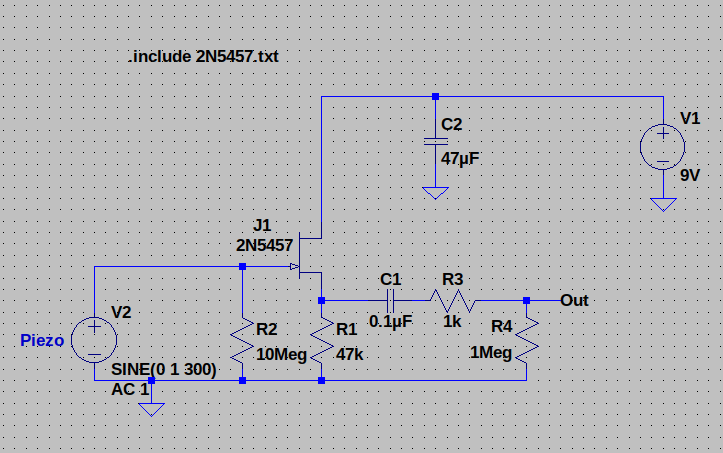

Here's a cleaned up circuit, stripped of the stuff you don't need.
A few points not mentioned yet:
1) If you add a 100pF cap across the input, it will reduce the output voltage from your piezo pickup. Unfortunately, the manufacturer of your Copperhead does not seem to provide the one specification we need: the actual capacitance of the pickup. Lacking this, I can't tell you exactly how much the output will be reduced by adding the 100pF cap.
2) Since your pickup is already "hot", try connecting a 4.7 nF (same as 4700 pF) capacitor between pickup output and ground; it will reduce the output signal, but it will also make the pickup compatible with a 1-megohm amplifier input impedance. If you still have enough signal level with the added cap, you don't need to build a preamp at all!
3) If adding a 4.7 nF cap kills signal too much, and you do build the preamp, it's important to add an additional resistor from output to ground (R4 in the schematic attached to this post). This will reduce thumps and bangs if you plug your preamp into the input of an amplifier that's already turned on.
(But be kind to your amp and speakers - plug in everything, keep the amp off, power up the preamp, wait a few seconds, then turn on the amp.)
4) I increased the preamps power supply filter cap to 47uF. The original value of 4.7uF is a bit stingy, and a 47uF cap is still very cheap. It needs to be rated for well over 9 volts. Doesn't matter if it's considerably more than 9V, i.e. a 25V part is perfectly fine.
5) This particular preamp (an FET source follower) can handle quite a big signal without distorting, so it shouldn't be bothered by the fact that your pickup is "hot".
-Gnobuddy
-Gnobuddy
