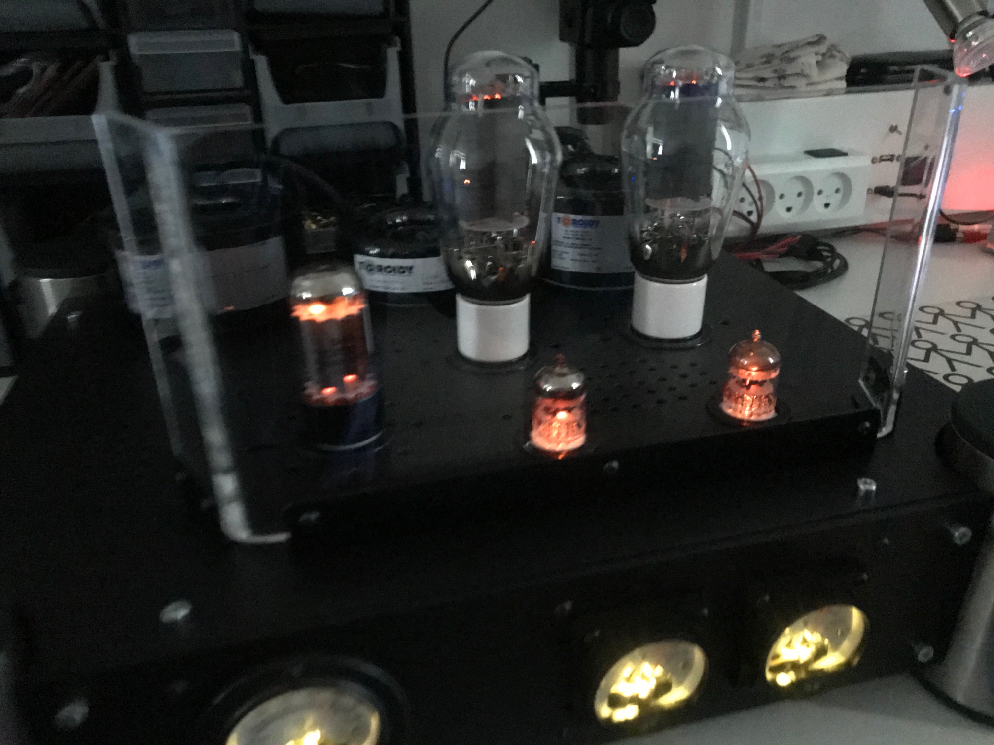

Here my TSEII 300B....
Br
Goran

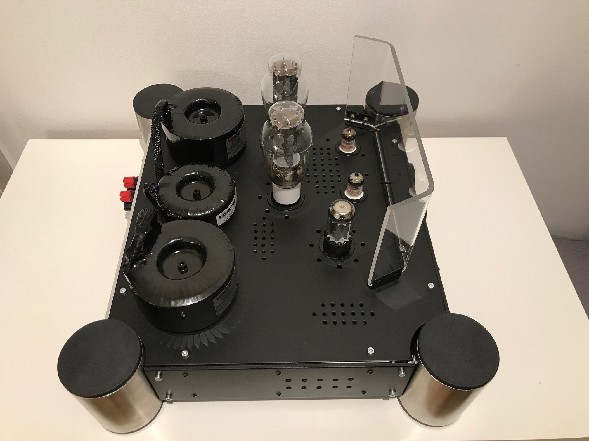

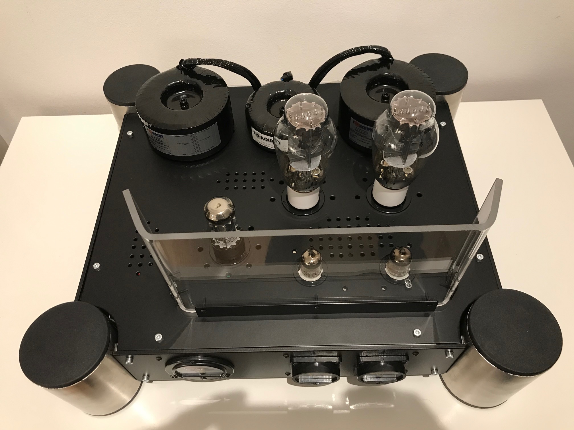

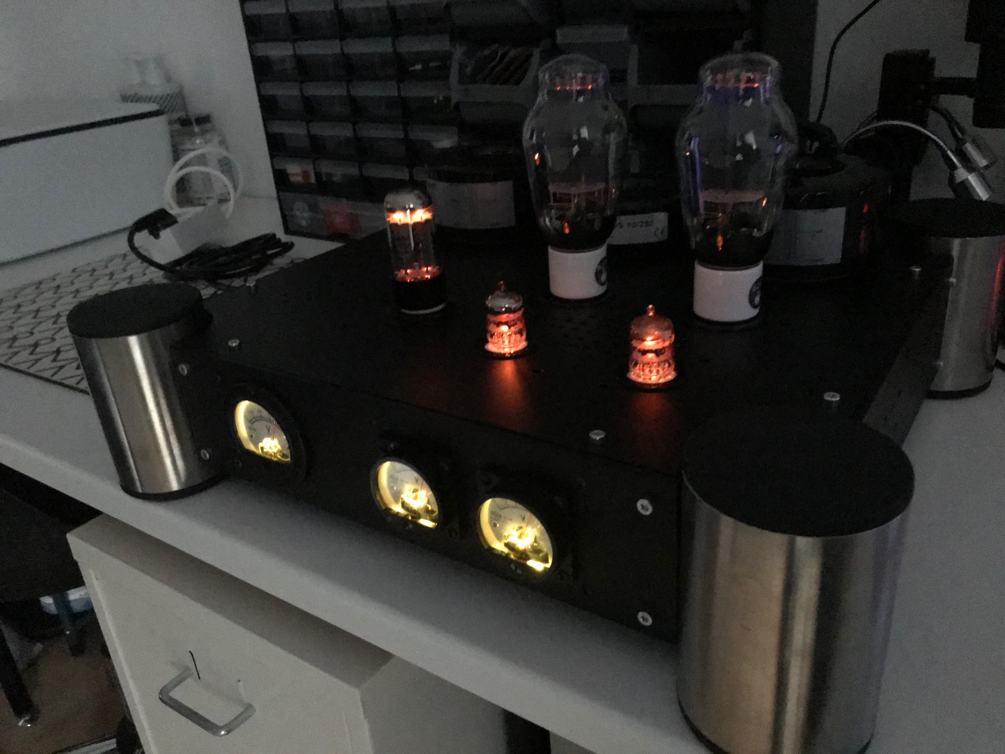

Hi here.
Finally i finished my amp. up.
Sound is brilliant, and everything is superB. 🙂
I ended up with B+@365vdc / bias at 75mA.
Very good and stable.
Last picture was before finishing it all up, but only one i got right now when tube's are ON!
Jesper.

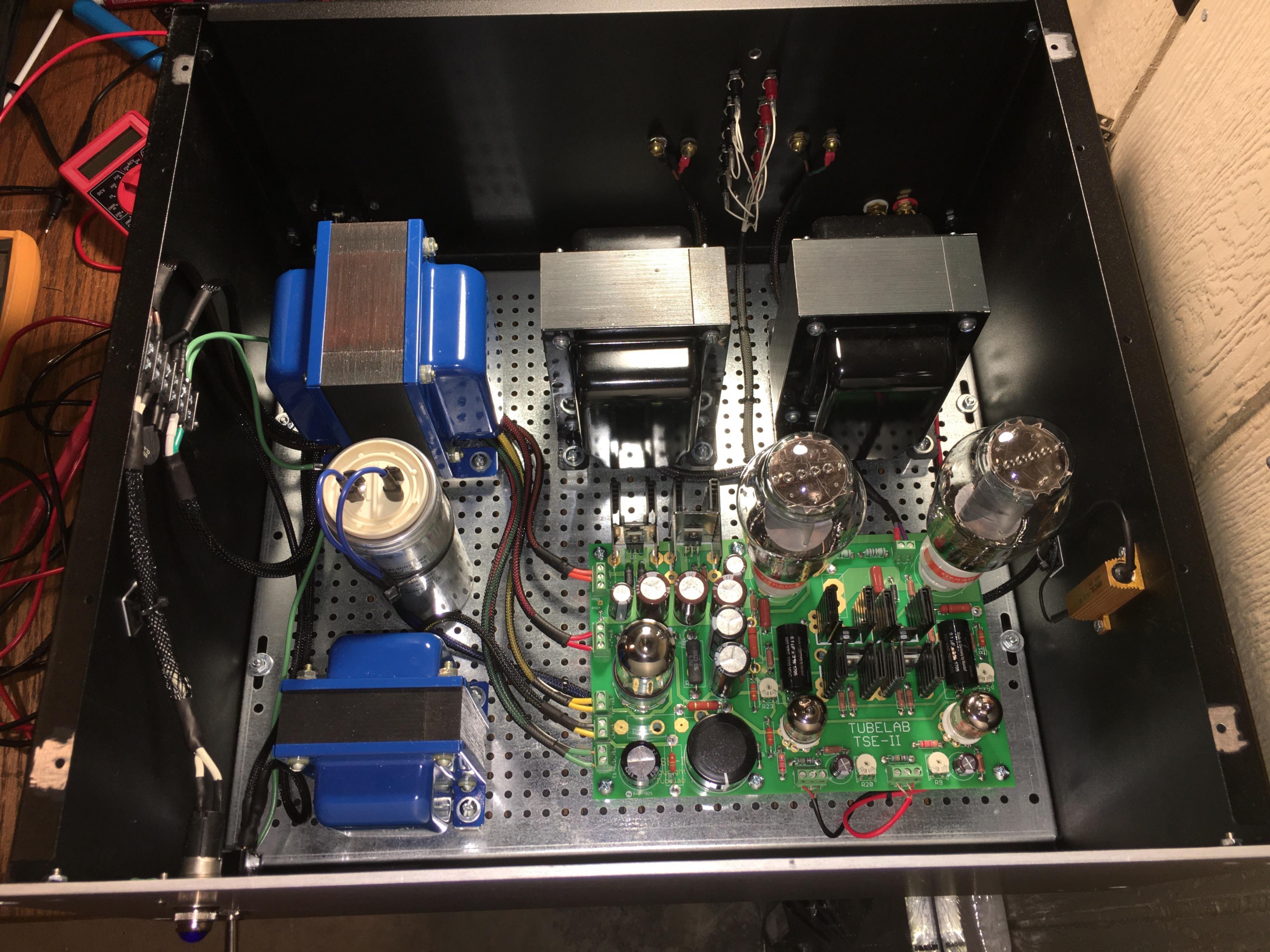

Here is my TSE II 300B amp... for this one, I was in audiophoolery mood and mixed it up a little from standard BOM.
Parts selection include:
- ISO transformers iron -- FC-20S opt, LC-10-200DII choke, custom PT.
- ClarityCap TC 85uF 600V Polypropylene PS cap
- Mundorf Silver, Gold & Oil 0.1uF coupling caps.
- Resistors are mostly Takman MF but also some Takman CF, Kiwame CF in less crucial places.
- Mills MRA-10 non-inductive for the high wattage resistors.
- WBT NextGen binding posts.
- Mogami W2546 coaxial input wiring.
- Kimber TCSS 19ga wiring.
- Chassis by Landfall Systems
B+ is around 385V, bias at 80mA.
Currently using the 5K:8R tap, there is also a 3.5K tap.
Tubes are Gold Lion PX300B, Raytheon 5842 and Amperex Bugle Boy 5AR4.
Regarding the sound... I'm still looking for proper speakers... 🙂

The Maida Reg was used on the TSE-II 45 that I built for headphones.
The hum there was in issue because my headphones are about 103db sensitivity and the driver is right on your ear. Additionally, I needed to use a 4.7uF filter cap to bring B+ down for the 45's, which increases ripple quite alot.
On this 300B, my speakers are not as sensitive and the first filter cap is 47uF. Additionally, the ISO choke is massive and I'm sure that helps.
I dont hear any hum from my listening position, maybe if I put my ear right on the driver.
BTW, your build looks great. I especially like the additional of relay input selection and volume control.

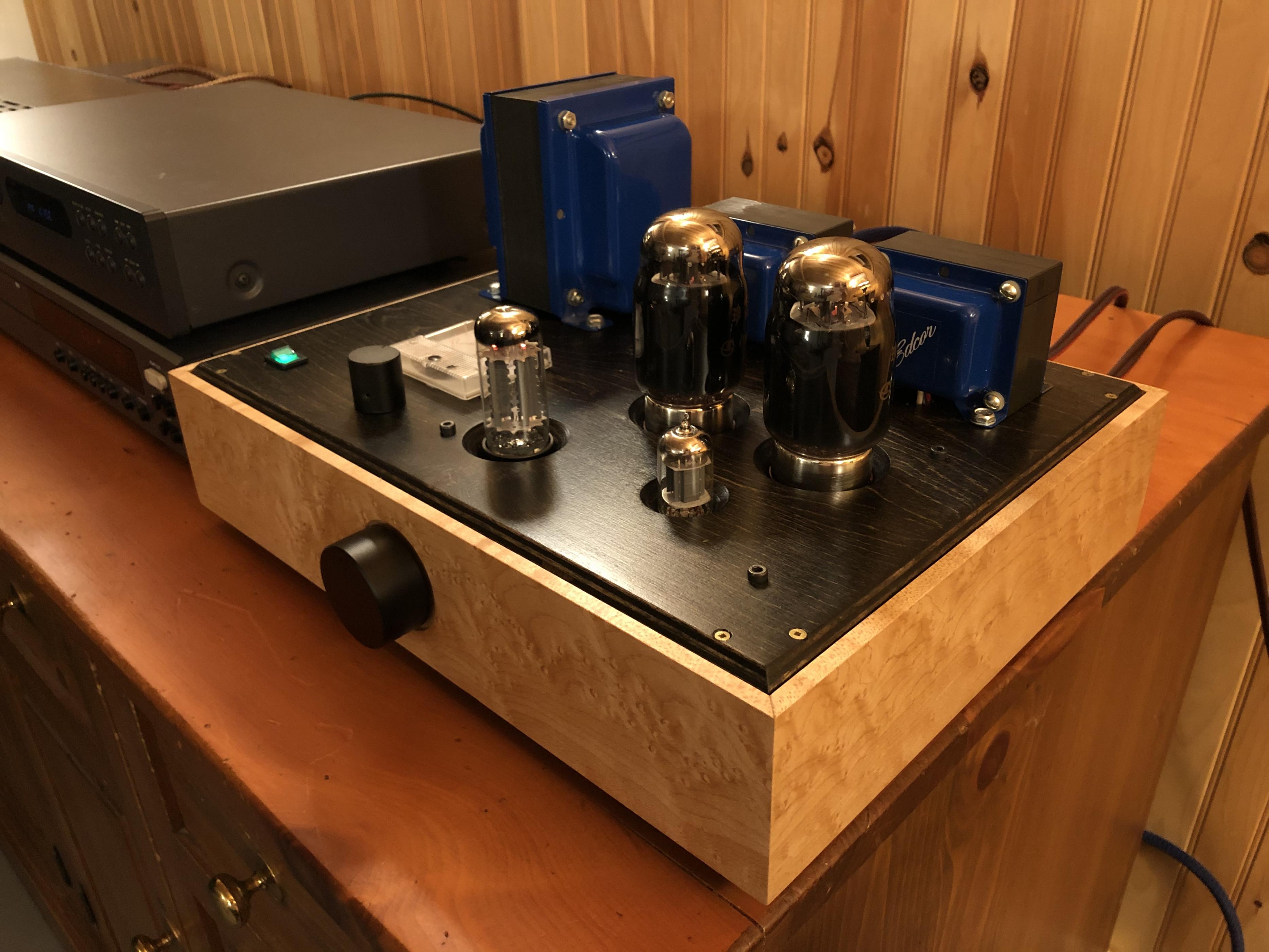

I liked my original enclosure but there were some issues with layout and size that just didn’t sit well with me. So with my newfound social isolation I spent two days making this. Bird’s eye maple frame, simple volume and source selectors with a current meter. Running shuguang kt88’s, new Russian Mullard GZ34 and NOS mullard 12at7. It’s about an inch narrower and 3 inches shallower, with a few more details than originally. Also really happy with the central volume and how it looks.
