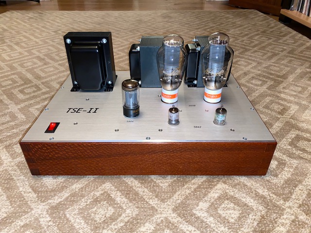

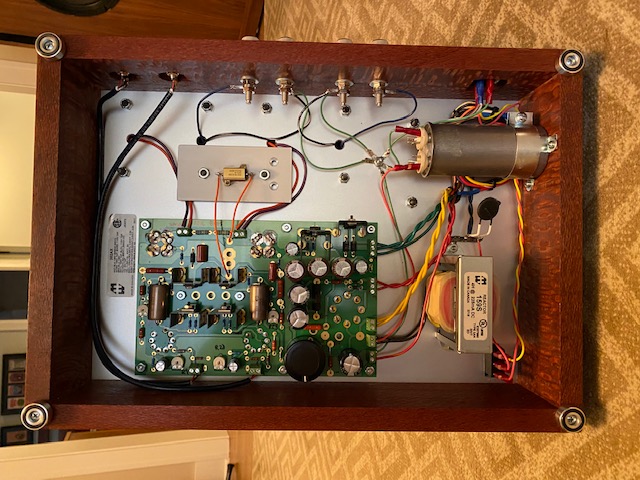

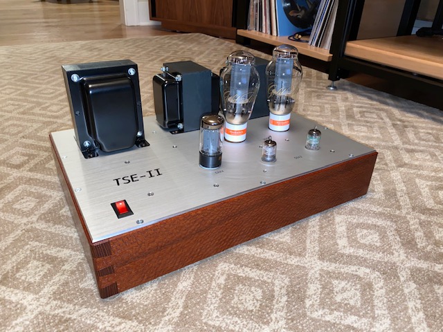

Here is my TSE II 300B amp... for this one, I was in audiophoolery mood and mixed it up a little from standard BOM.
Parts selection include:
- ISO transformers iron -- FC-20S opt, LC-10-200DII choke, custom PT.
- ClarityCap TC 85uF 600V Polypropylene PS cap
- Mundorf Silver, Gold & Oil 0.1uF coupling caps.
- Resistors are mostly Takman MF but also some Takman CF, Kiwame CF in less crucial places.
- Mills MRA-10 non-inductive for the high wattage resistors.
- WBT NextGen binding posts.
- Mogami W2546 coaxial input wiring.
- Kimber TCSS 19ga wiring.
- Chassis by Landfall Systems
B+ is around 385V, bias at 80mA.
Currently using the 5K:8R tap, there is also a 3.5K tap.
Tubes are Gold Lion PX300B, Raytheon 5842 and Amperex Bugle Boy 5AR4.
Regarding the sound... I'm still looking for proper speakers... :)

Whoow :) Impressive build!
You seem to have parts in control itsikhefez.
I see that the choke you use is 10H / 120 Ohm / 250mA
I myself am thinking about replacing the Triad C14X i have now (6H / 150 ohm) with an toroidal one :
Core type toroidal
Inductance L 10H
DC Resistance 45Ω
Nominal DC Current 250mA
Nominal voltage 400V
But i don't know yet if the low resistance on that coil is good or not good in THIS build?
Contgrat's again with your'e SuperB build :up:
Rgds; Jesper.

Thank you very much! The ISO choke is heavy and does an excellent job. The amp is black silent there is zero hum or noise on the output. I have to put my ear literally on the tweeter to hear that the amp is on.
Re: the choke you're looking at, trying putting the data in PSUD and see how B+ changes with the lower resistance. I assume that 10H should filter better than 6H but make sure B+ is not too high.

Beautiful build, itsikhefez! That's one to be proud of. Front Panel Express top plate I assume? The fit and finish look great!
Thank you very much, much appreciated! I used the FPD software but Landfall made the entire chassis, including CNC the top plate.

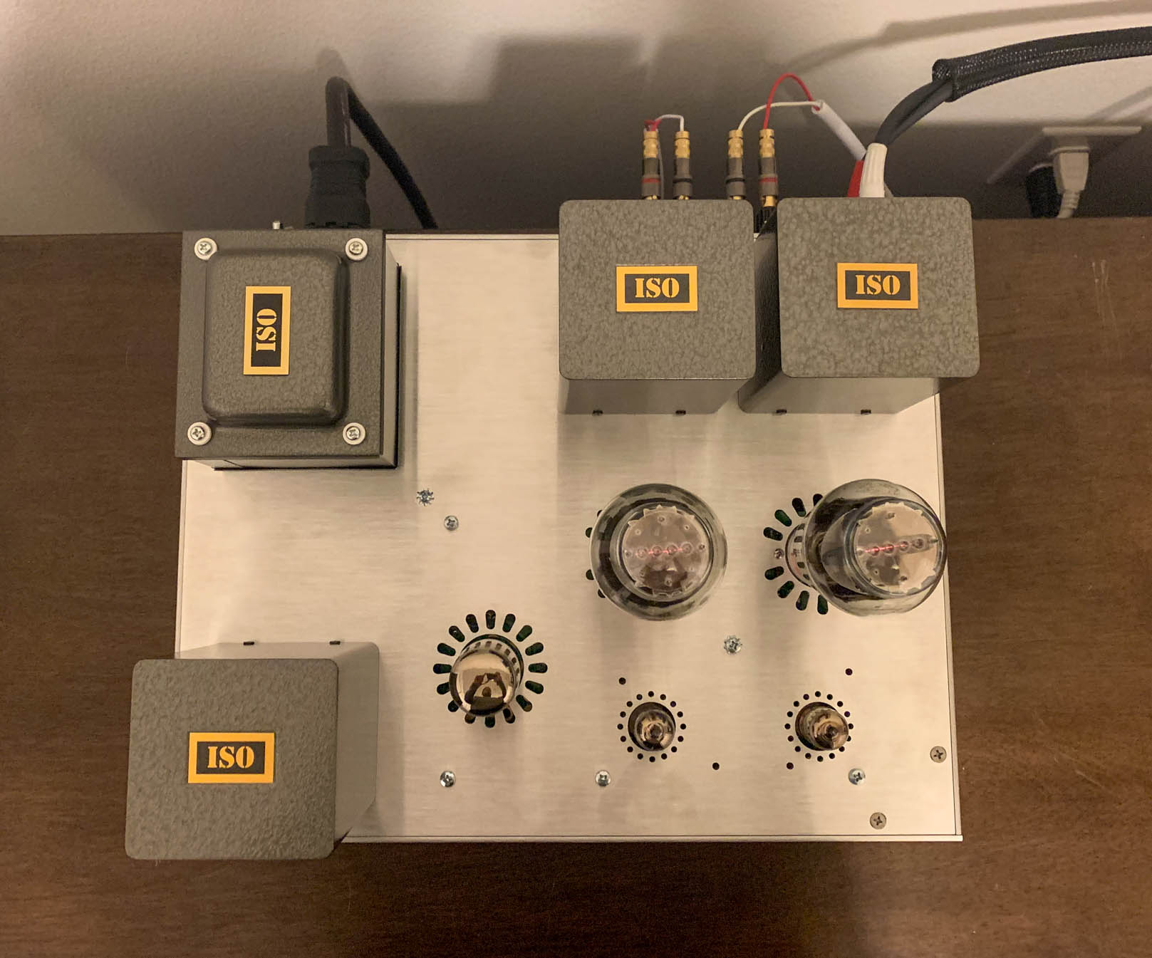

Another succesful TSE-II
Finished up my 300B TSE-II build a few weeks ago. Lucky for me, it fired up on the first try. I have about 50 hours on it and it simply sounds fantastic.
I'm running Gold Lion 300B's. The OTs are Electraprint 5K primaries. My B+ is about 390 volts and I have the bias set at 65mA per tube. Nothing exotic on the component side, K40 coupling caps. I'm using Amperex JAN 5842 drivers and an RCA branded Mullard 5AR4.
The top plate is from Front Panel Express and the chassis is made from leopardwood with a tung oil finish.
Just a marvelous sounding amplifier playing thru my Franken-Altec speakers.
Thanks to George for a great design and to all the forum members that posted helpful information on their builds. Reading every post sure helped me to be successful on my build.

I'm also designing a top plate for a TSE-II. Would your share your design file?
Thanks, Jacques

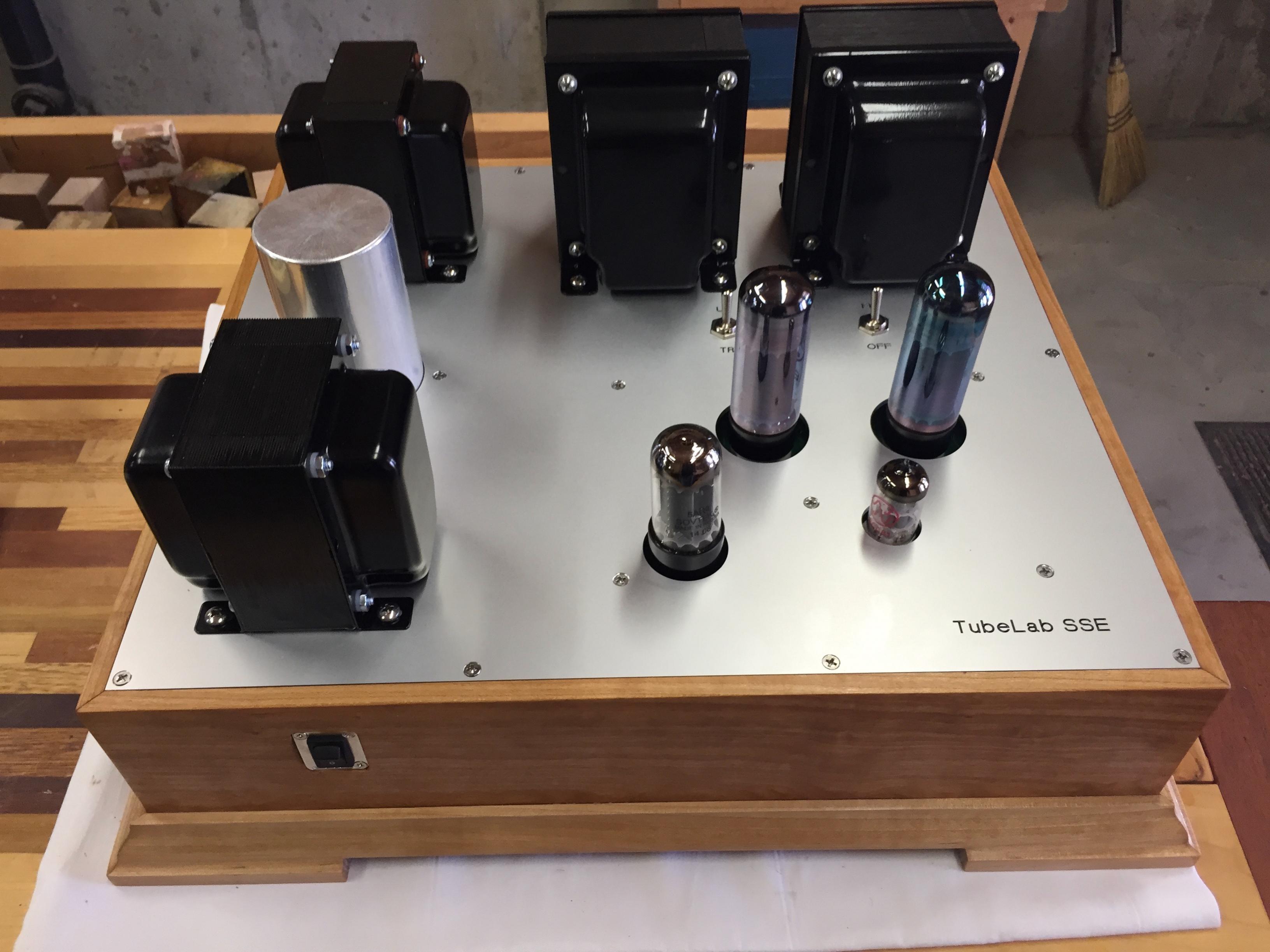

Another FPD for SSE
Here is another SSE build, I did it a few years back. Jacques you asked about a Front Panel Design file for the top plate. I've attached a ZIP of FPD design along with the backplate design
Michael
