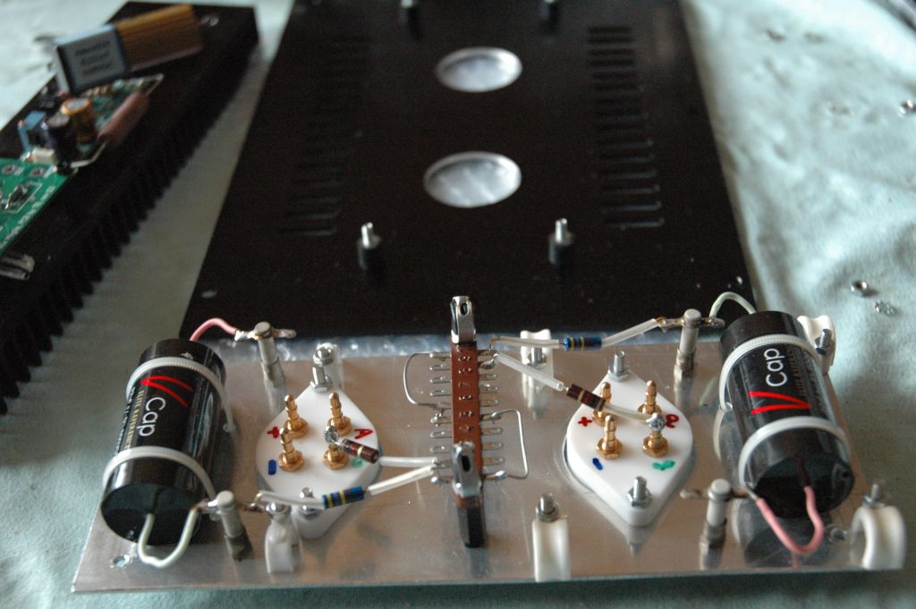

Here is an idea many you could try using mostly off the shelf parts. The springs are Latrax #7666 with a rate of .314 - these are used in RC car suspensions. The rest of the hardware is 10-24 threaded standoffs, and screws. Mass of the sub chassis is about 1kg, there is a step machined into the mounting holes to receive the springs - self centers nicely. Resonant frequency seems to be in the range of a couple of Hz, no idea of Q and no plans to measure it unless there is a problem.
Dave at Landfall gets credit for the idea.
