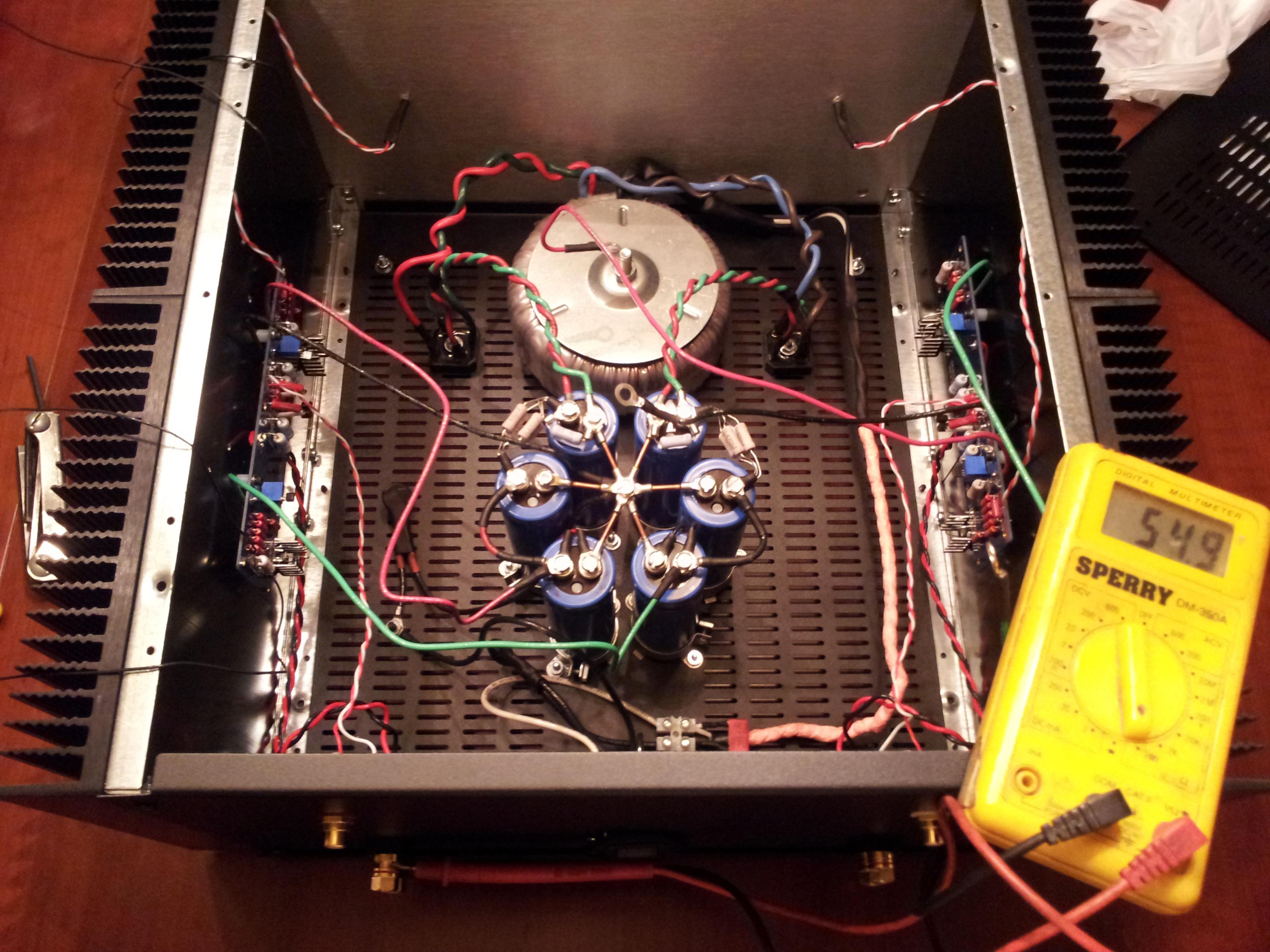

Awesone cap arrangement. 😀

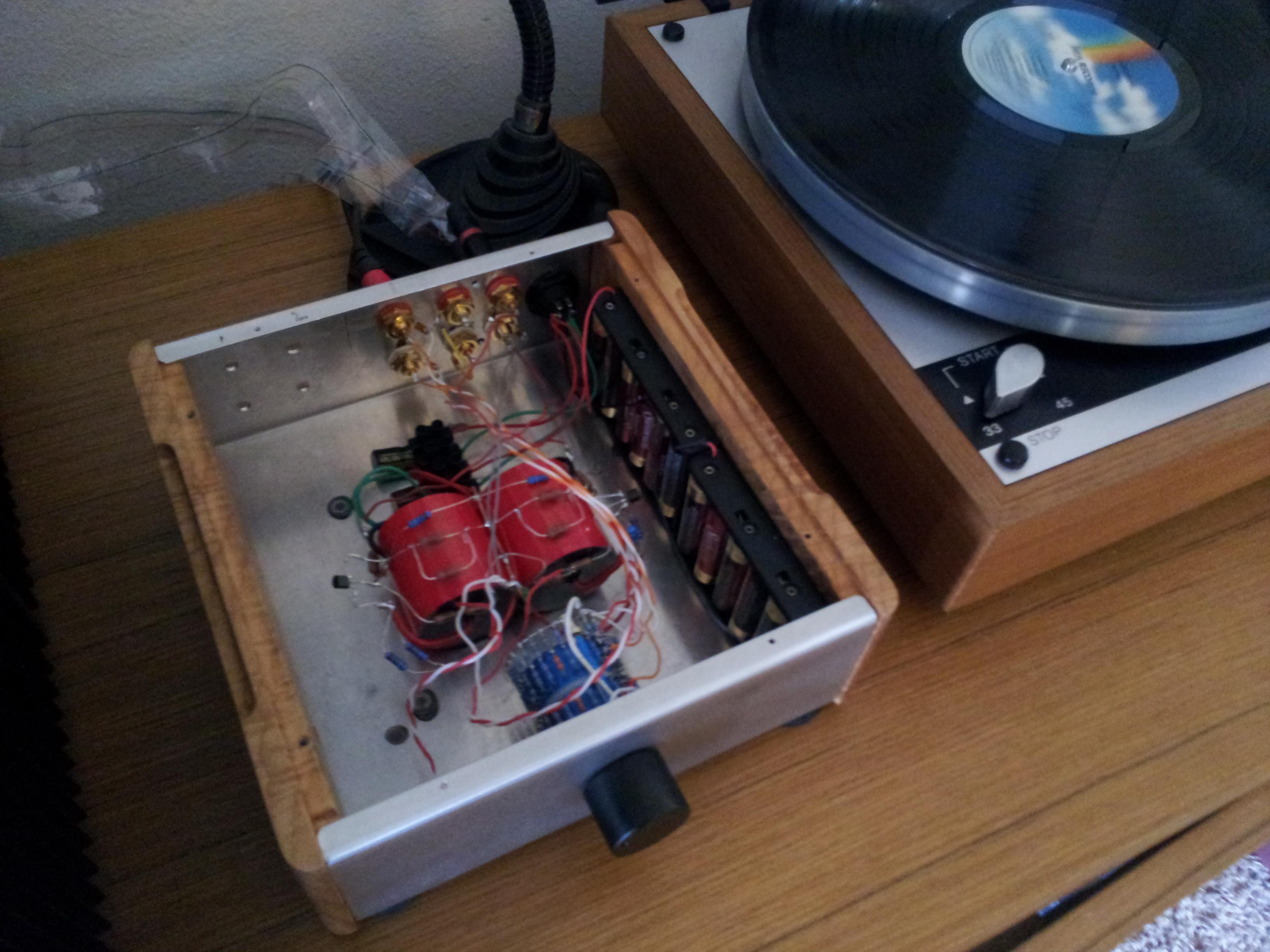

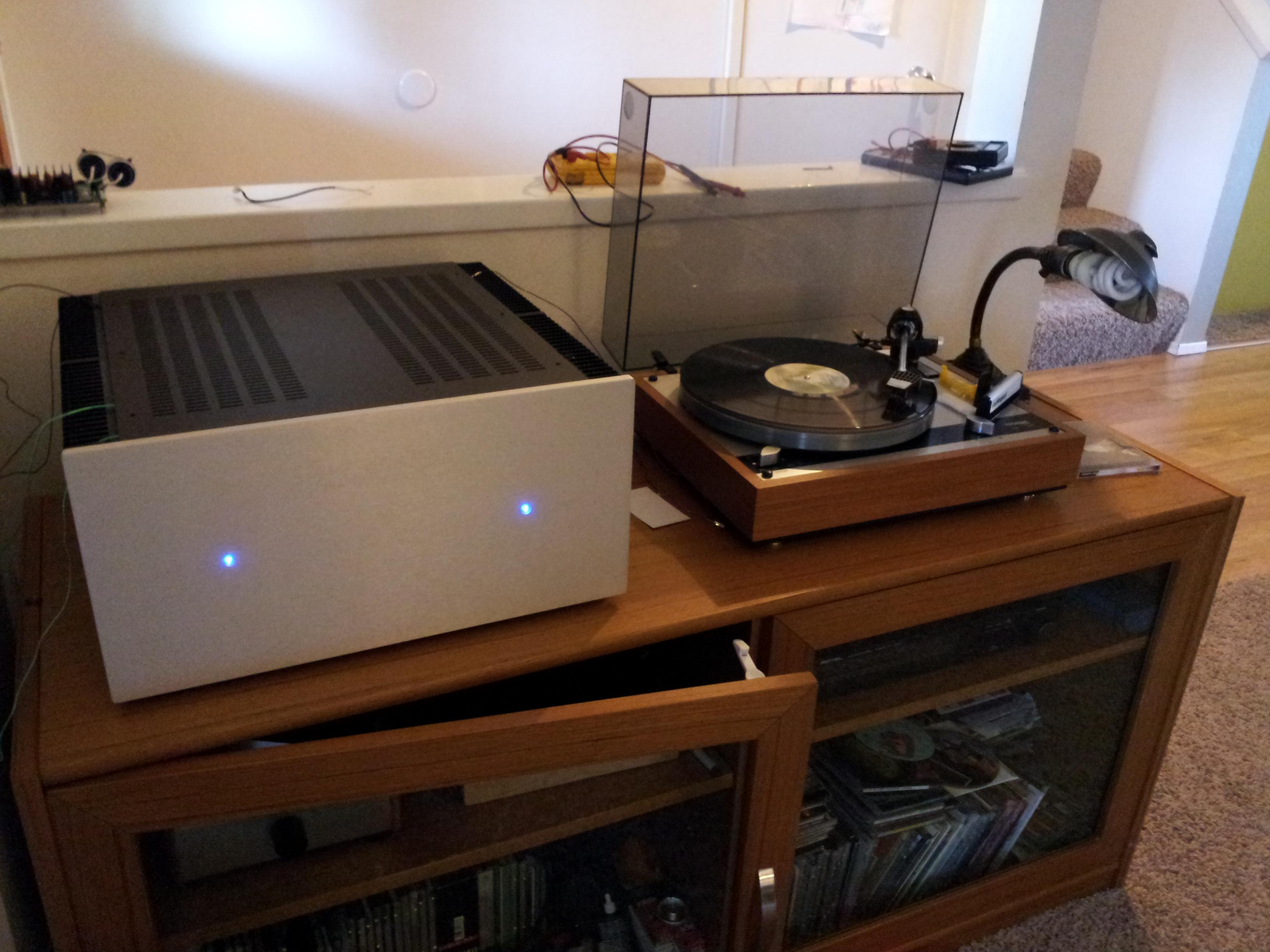

F5 and jfet boz
Nice combo.
But the loop area of the charging circuit could be very much smaller if that silly 6legged star ground was removed.How much did you pay for this panel?

Yep, Also nice big sinks for a normal F5, I guess you can bias them real high...
The sheriff's badge could use semicircles.
Nice idea. I'll get some sheriff's stars for my next PSU. 😀
