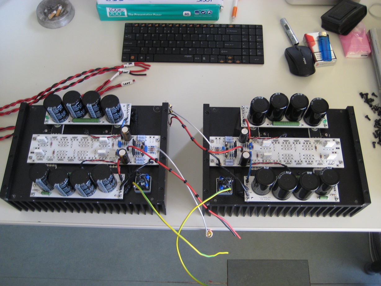

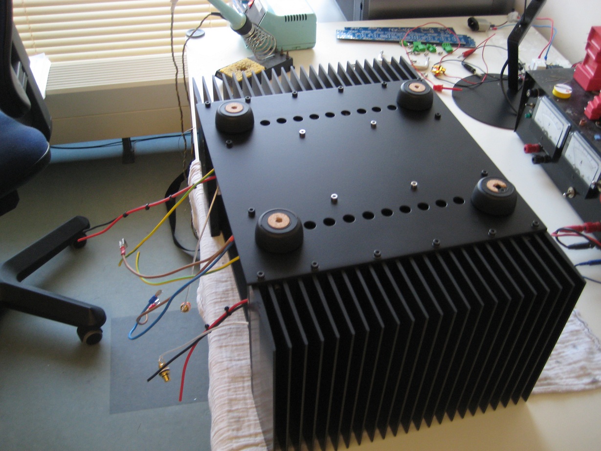

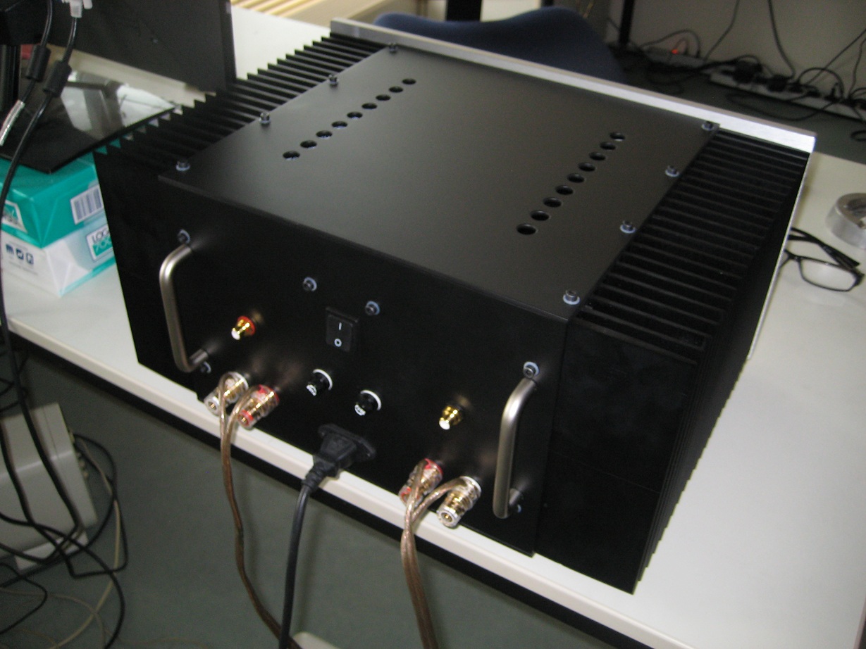

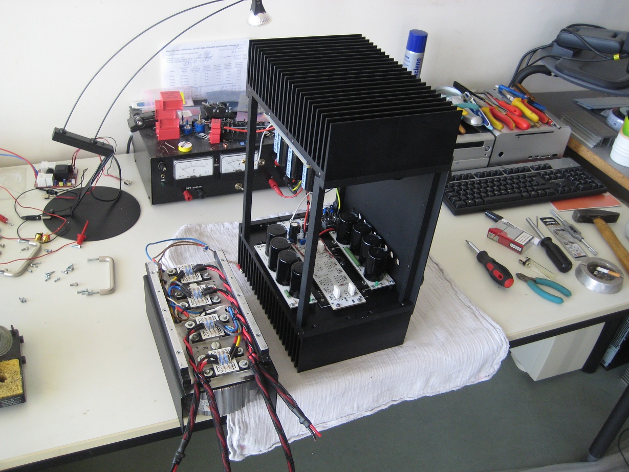

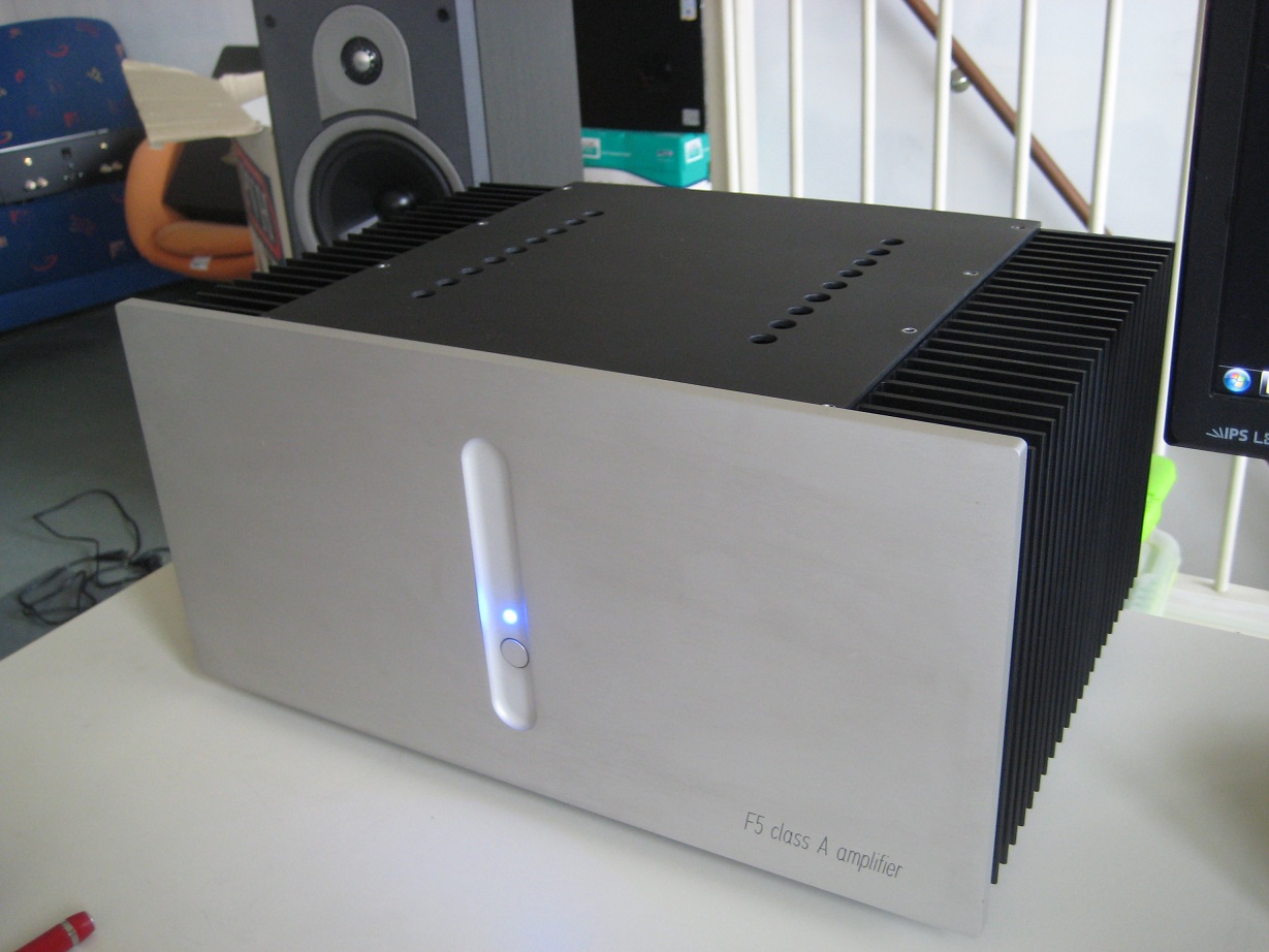

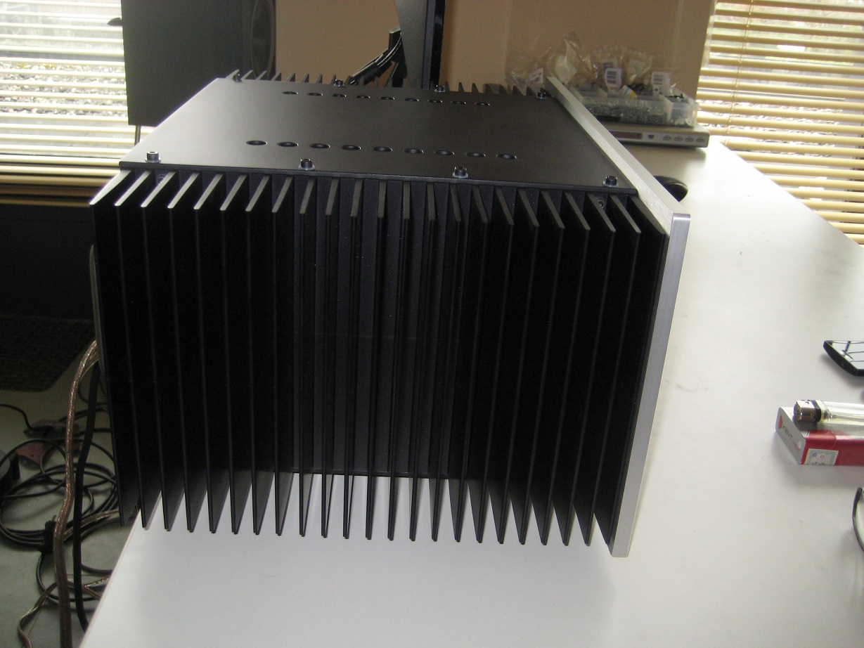

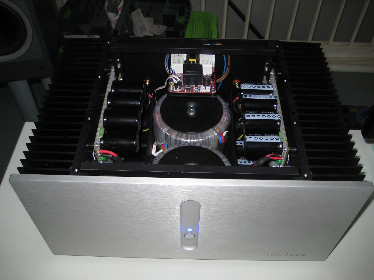

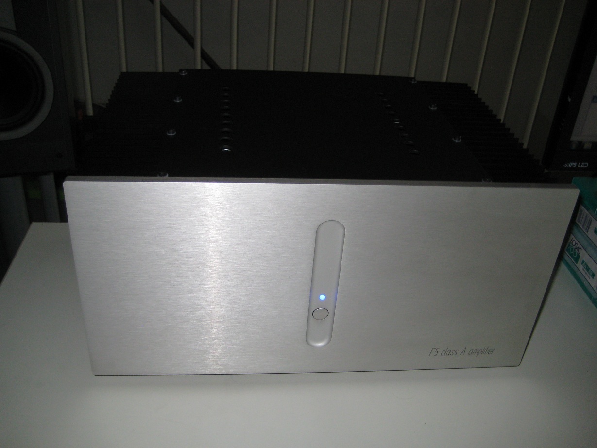

Finally ready!

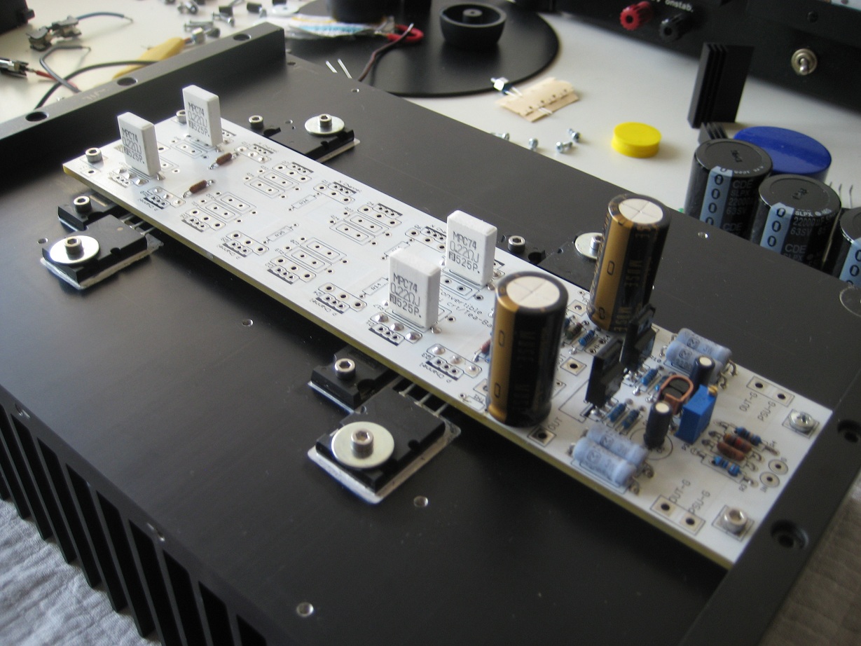

Here are the latest pictures of my completed F5Turbo v2 with cascoding, with 2sj201/2sk1530 output MOSFETs and the diodes MUR3020W mounted on the heatsinks. I'm not a ''fraidy-cat" 😉 but hey, my sourceresistors are only 0.22 Ohm...

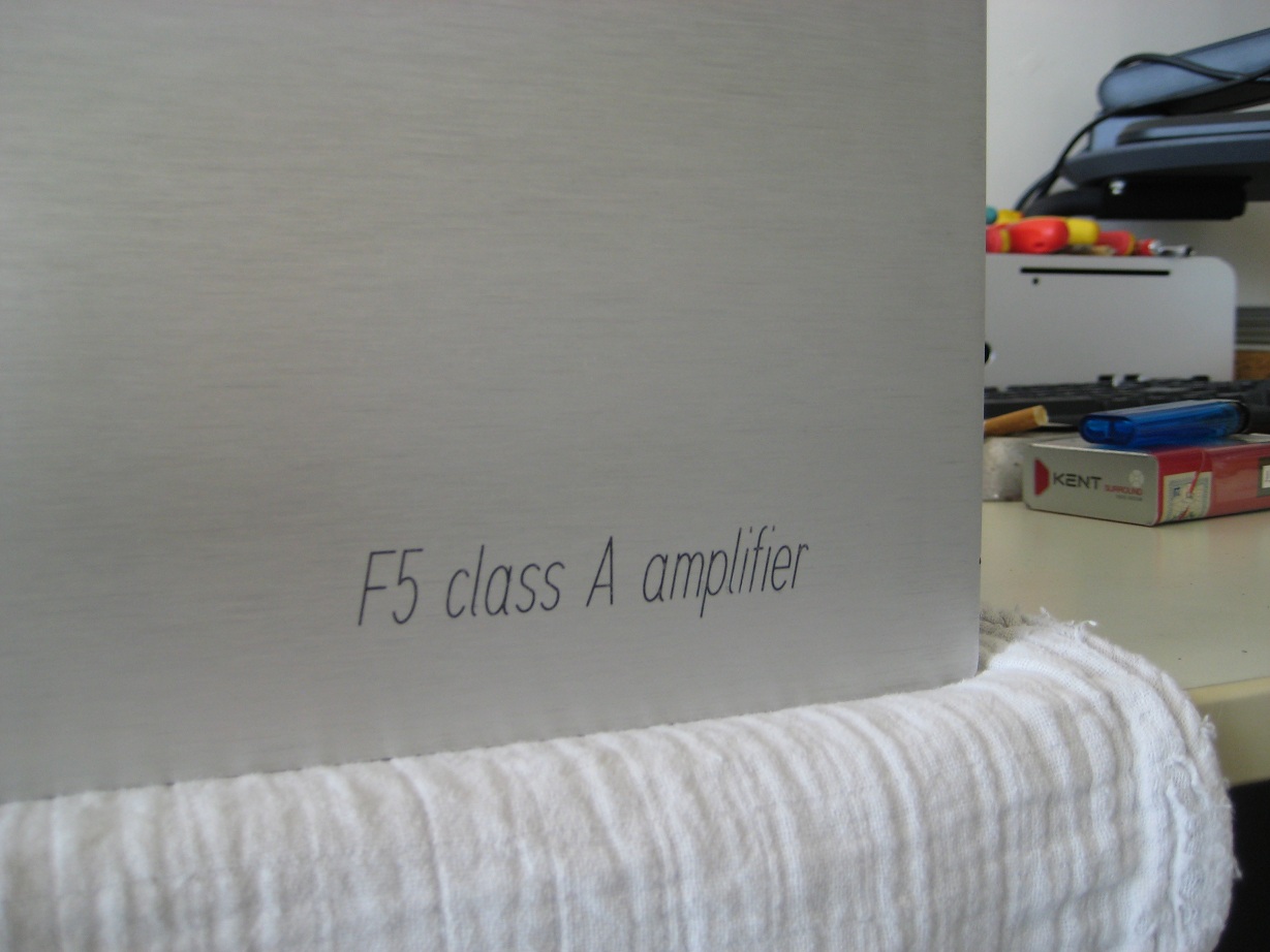

The frontpanel is wonderful made by Andrea of hifi2000.

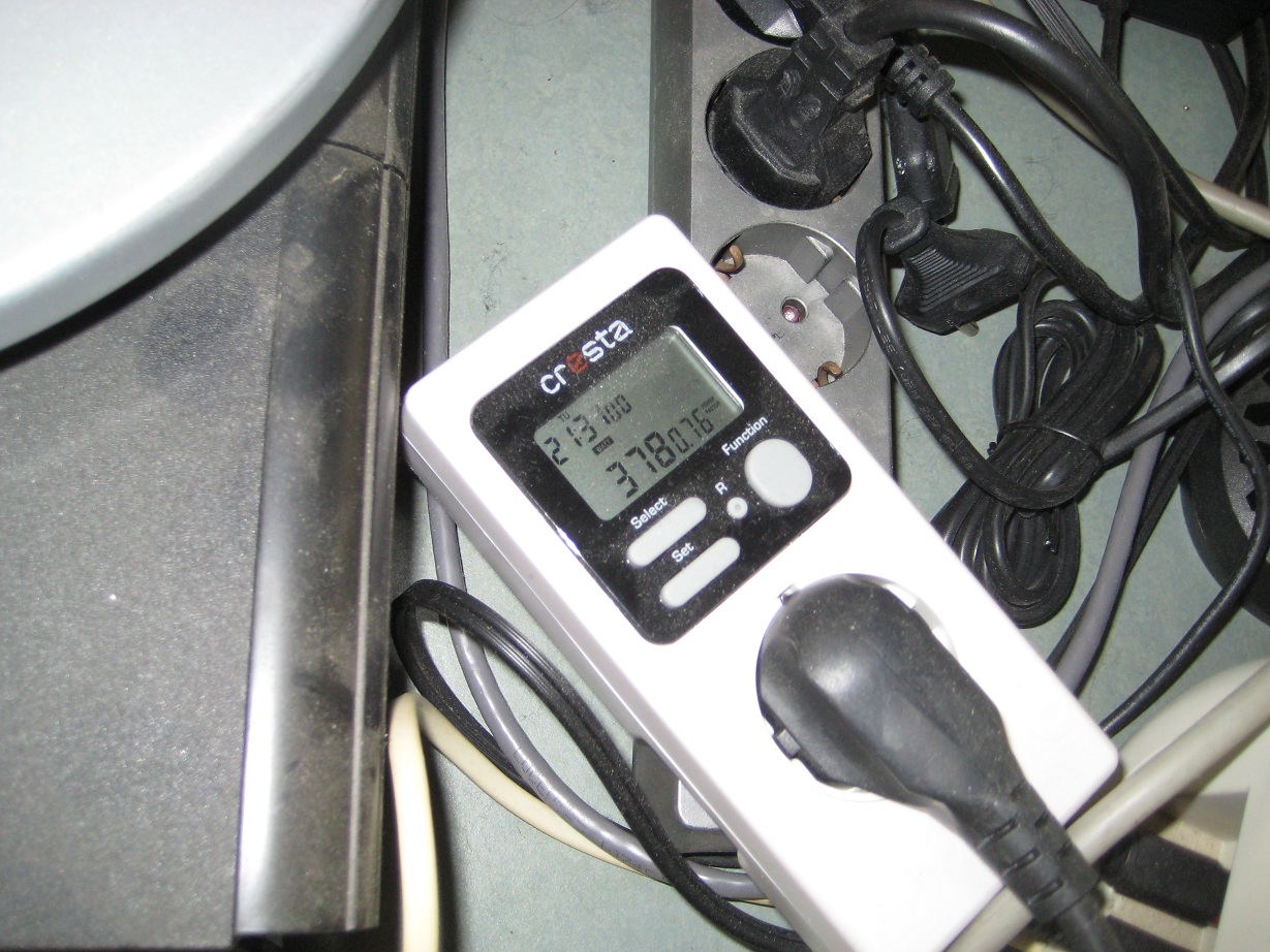

The MOSFETs are biased at 1.25 A each at 33.2 volts so 40 Watts each.
Total power consumption is around 350 Watt, with max temp on the heatsinks of 52.3 degrees Celsius.
I first biased it around 380 Watt put the lid on the amp and I almost had a thermal meltdown 😀
Took me hundreds of hours to complete....
Hope you like the pictures...

Fugly!
put 5mm spacers between heatsinks and both bottom and top plate , to have opening all around circumference ; that way it will have more air for inside cooling
help..I can't breathe..it's hot...and tight...man, that thing will be boiling hot like a vulcano 😀
Thanks!
Ofcourse thanks to Papa Pass for this wonderful design and sharing it with the DIYaudio community!
The first music I listened to was a SACD from the Dire Straits, Brothers in Arms...your latest trick...WOW
Hi ZM, I think that's a good idea, cause the components inside are measured around 45 degrees Celsius... 😀
Haha, thanks...yes it's a beast! And it sounds like it!
forgot to mention..... it's 30,3 KG 🙂🙂
Light version 😉
Regards zeoN_Rider

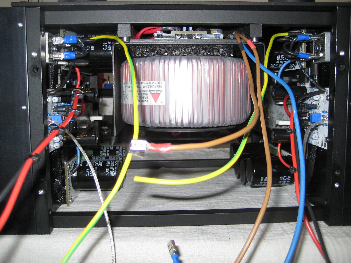

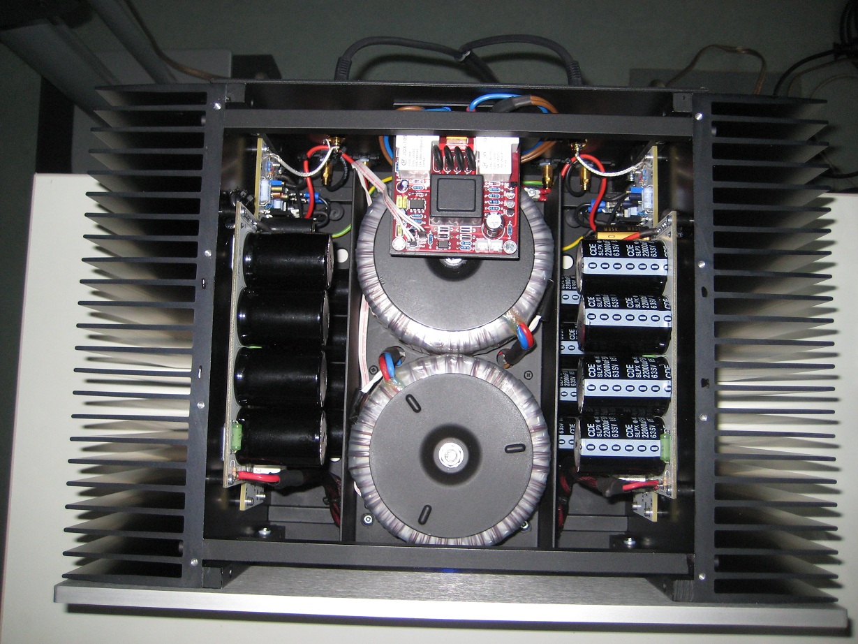

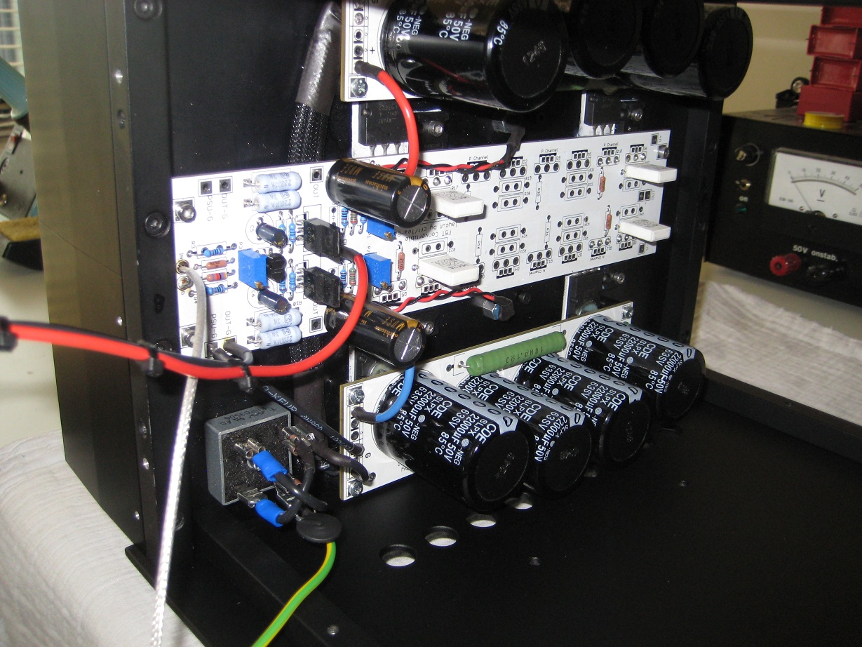

Great build WaterW!

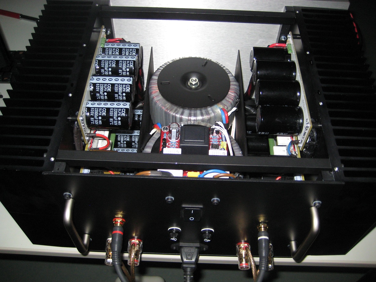

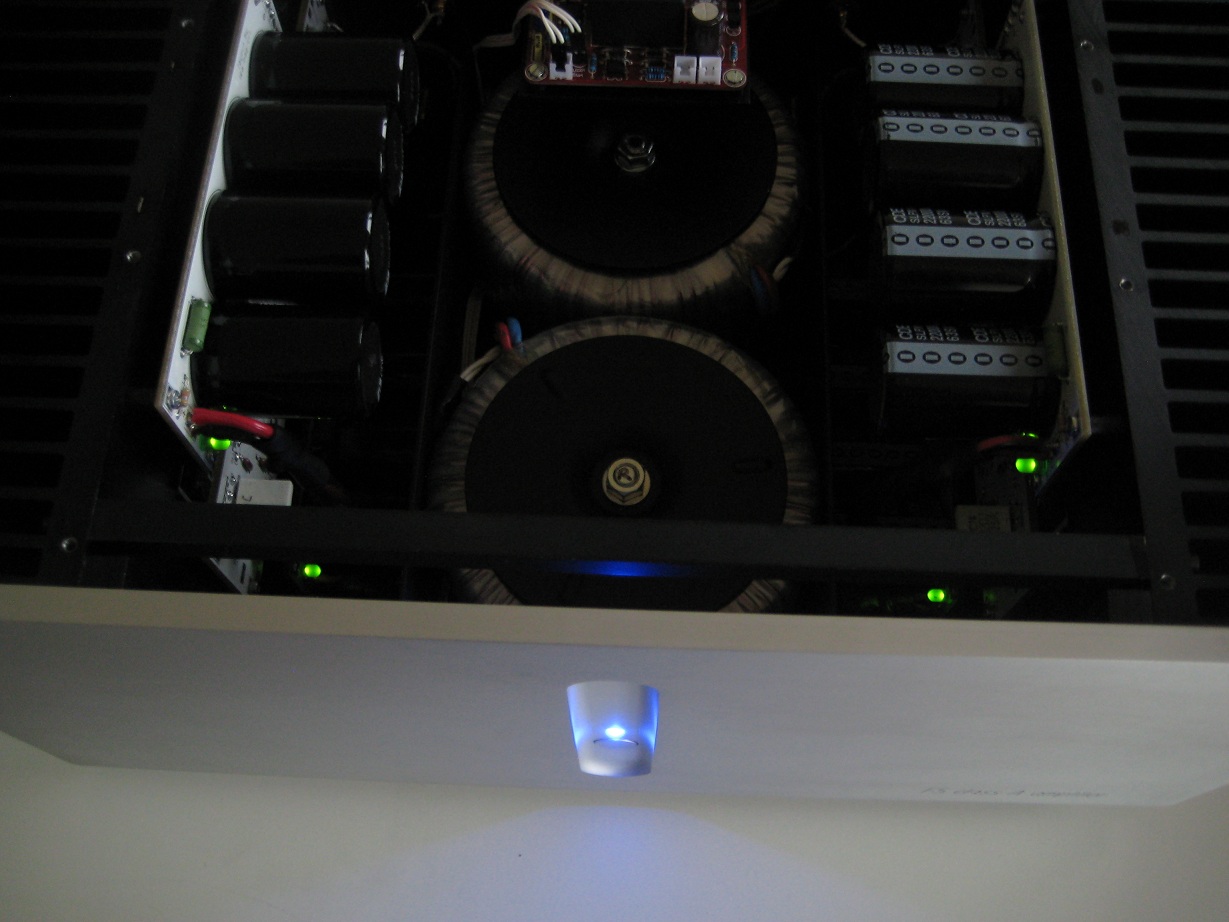

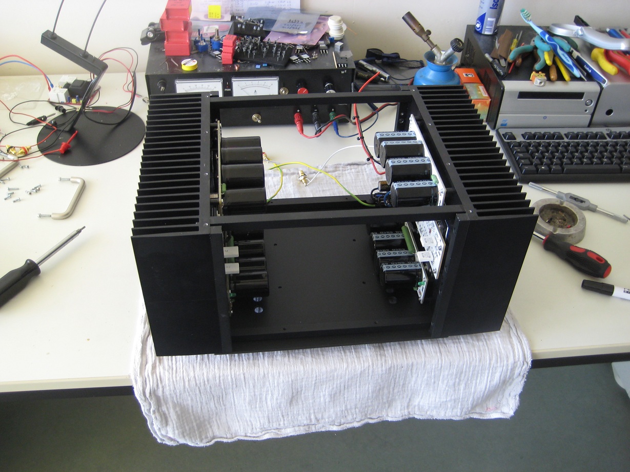

Mounting power supply including caps on heatsink just above amp board, how good is this?
Great build WaterW!
It's not my idea, I saw it in the F5X thread from EUVL.
I liked it cause you have very short wires, low induction, low resistance from your PSU to your AMPboard.
And... I had almost no place left in the case, because of the big transformers. 😀
Downside is the caps are getting pretty hot, around 45degrees Celsius.
