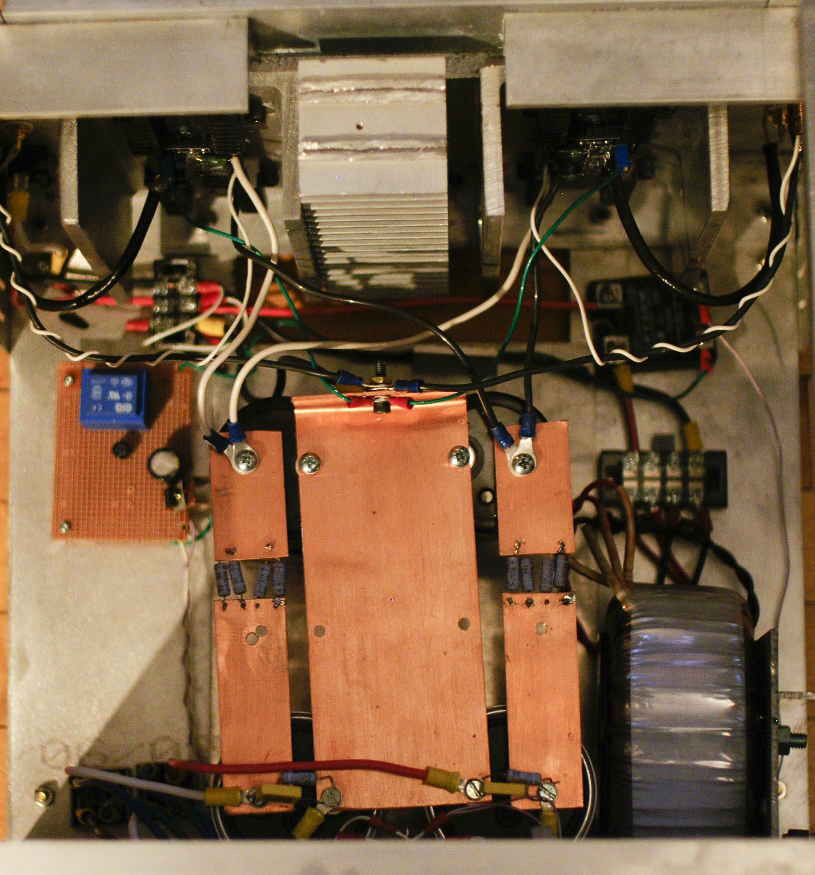

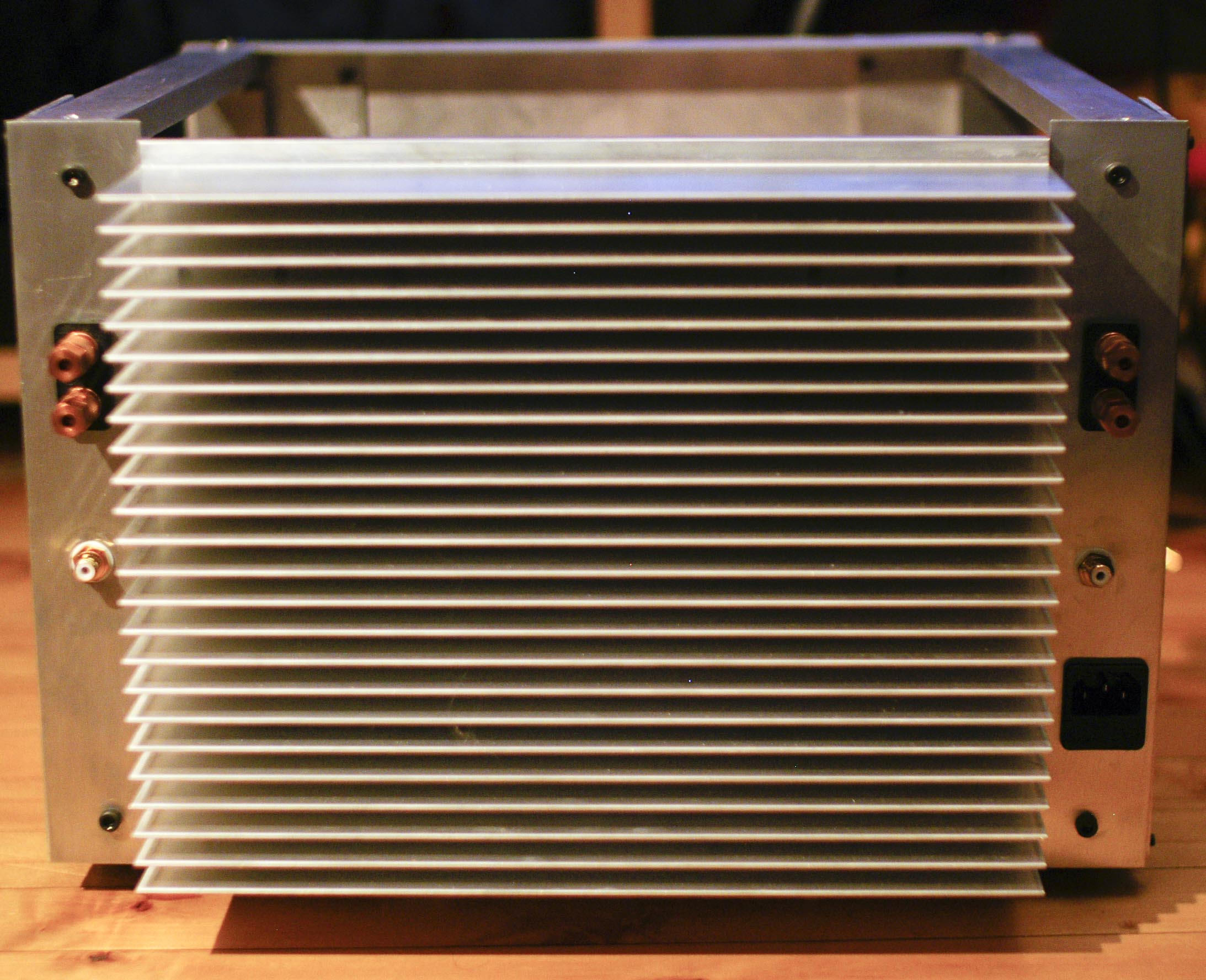

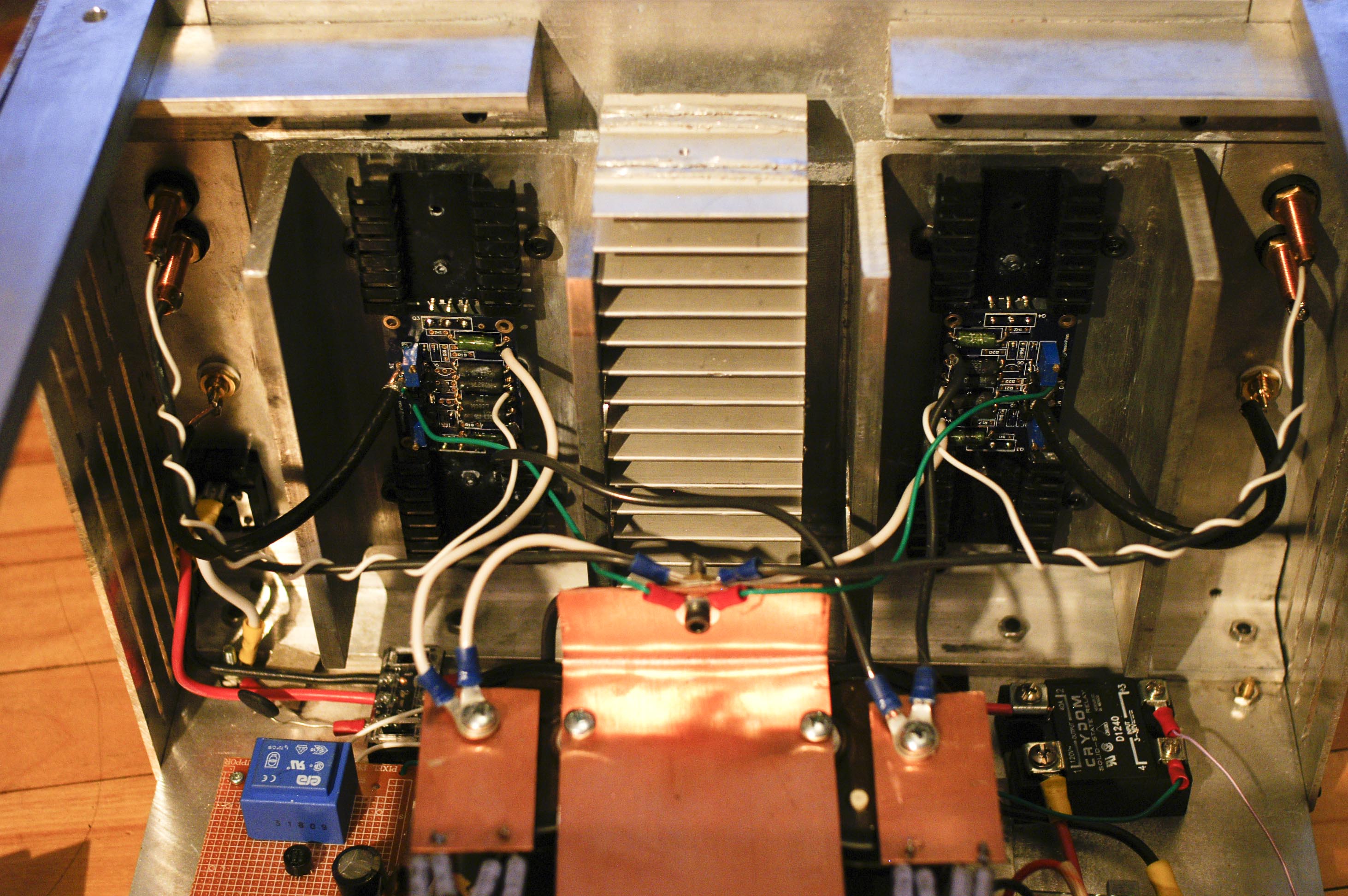

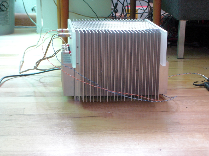

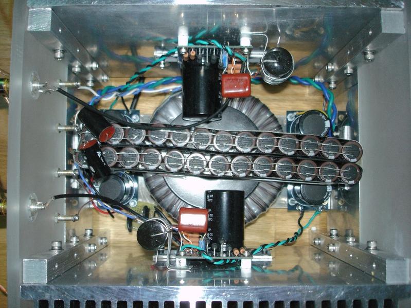

Here's the inside after a ton of wiring--yes, it's a bit busy.

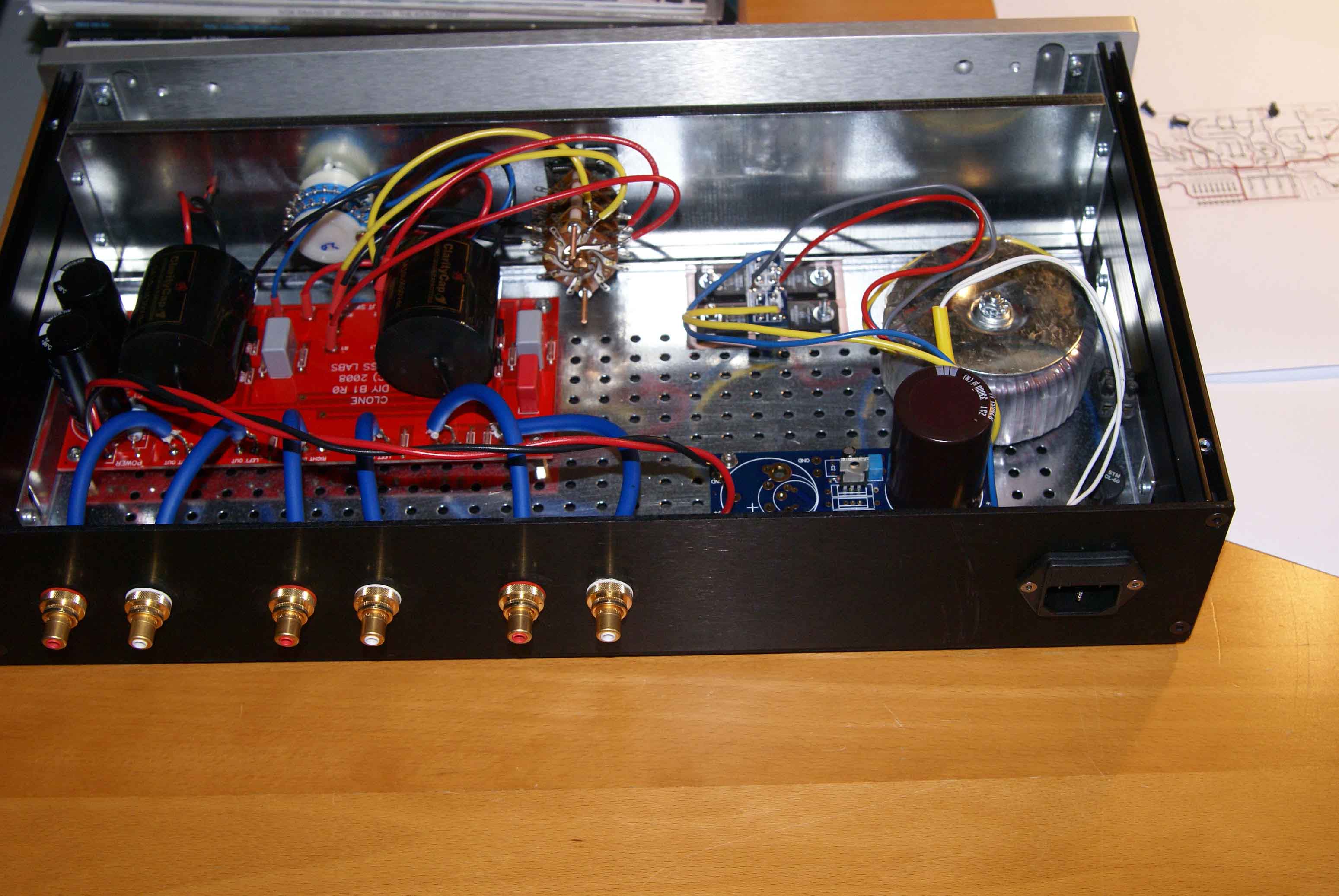

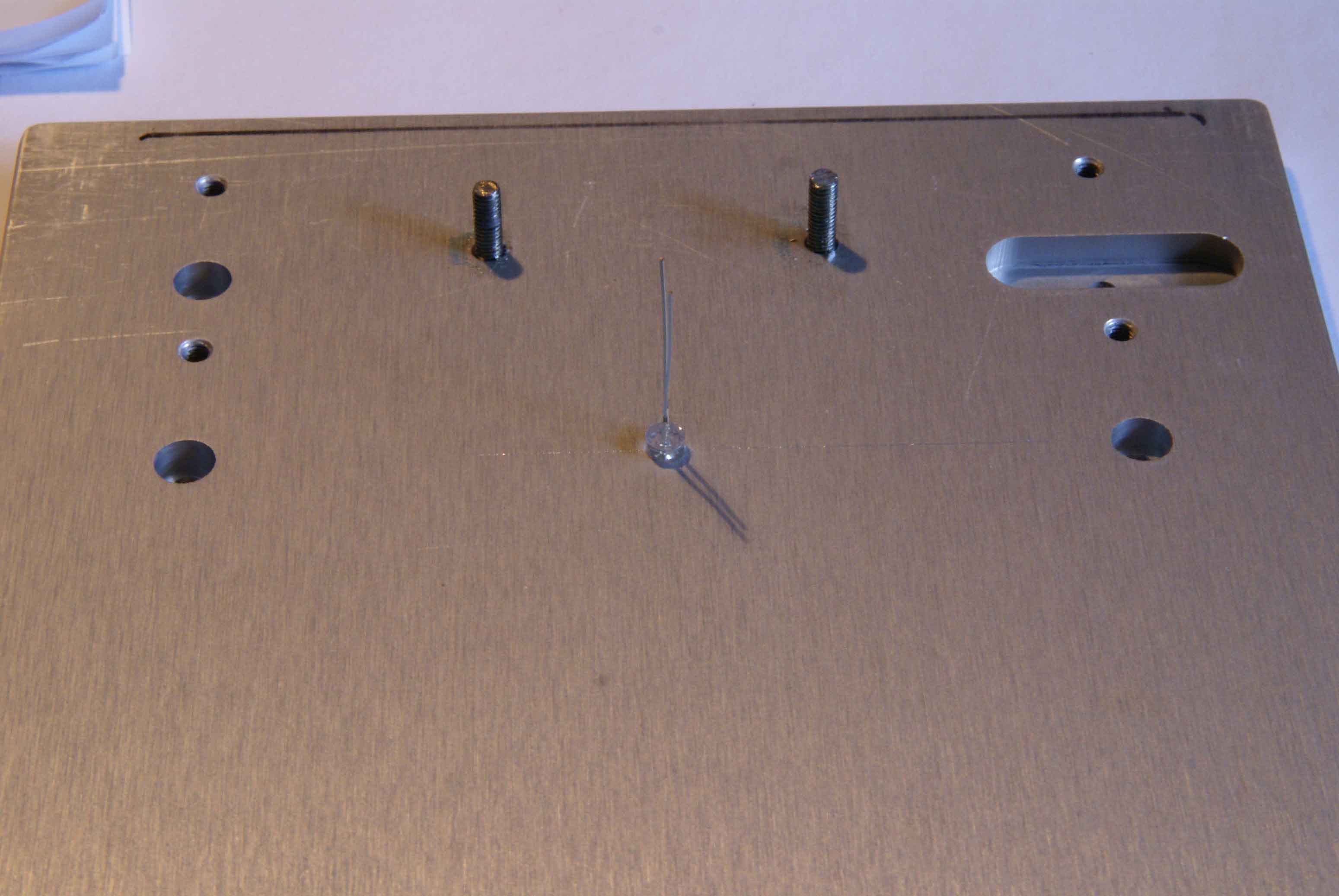

What are you using 6mm Al plate?
Stateside, it is 1/8" plate for the back, bottom, front sub-panel and the same for the B1. The faceplates are 3/8" 6061 for the F5 and 1/4" for the B1. The B1 sides are 3" extruded aluminum T-track.

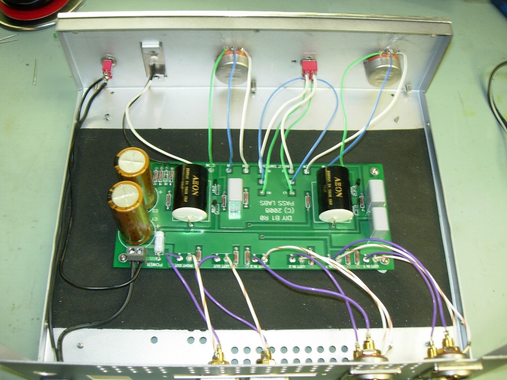

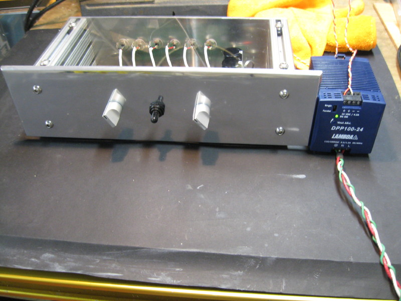

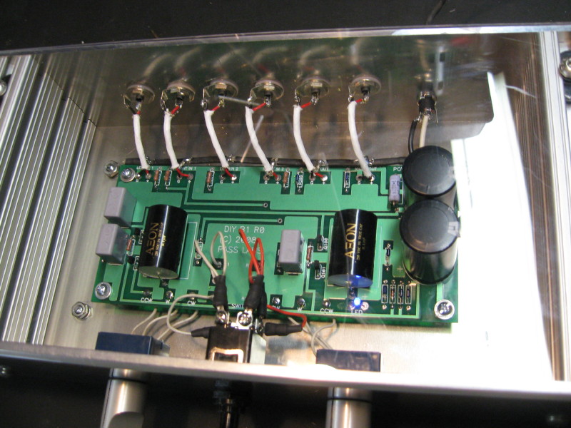

Got the B1 populated and wired. The little 24v. supply needs it's own little box and that will be next.

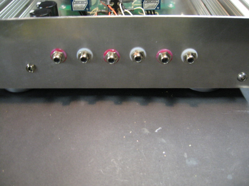

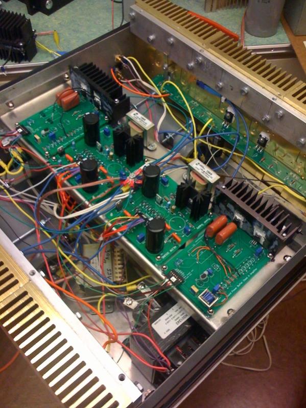

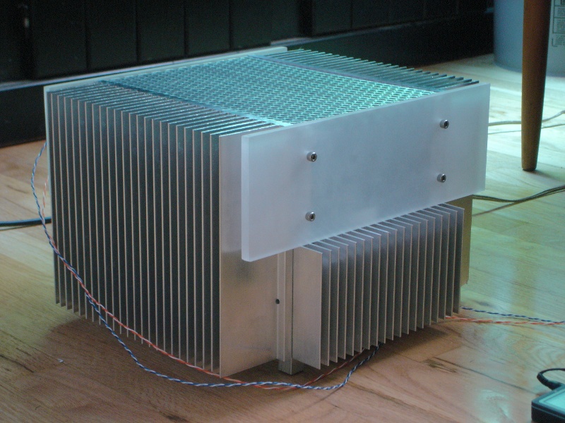

My F5
I take a guess and construct my f5 with one heatsink and a bunch of spare aluminium pieces and small heatsinks. I can bias it up to 1.3 amp, the mosffet is about 60 c.

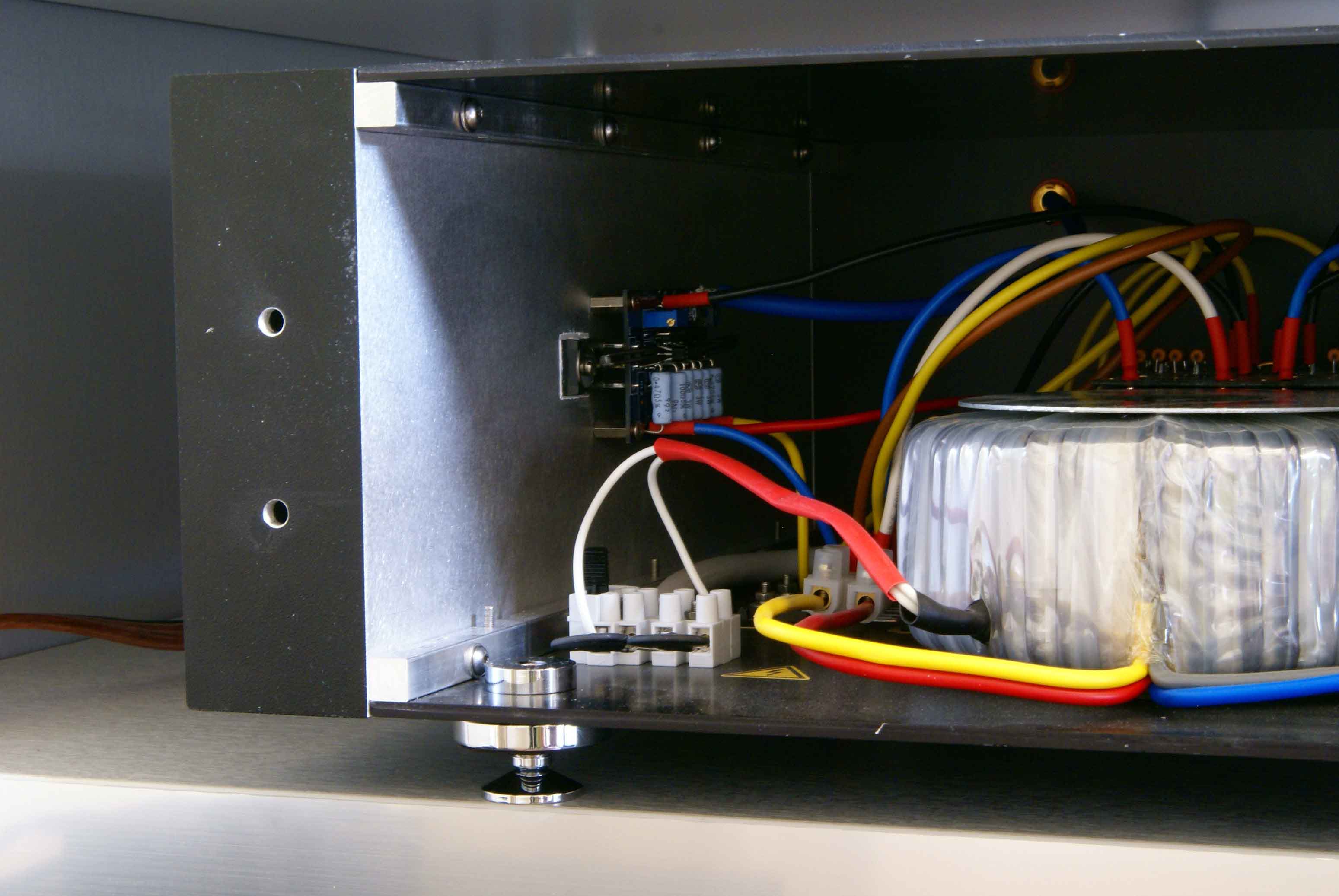

An other B1 and F5
After some months of building is this the result.
At a diy audio day in the Netherlands there were enthusiast comments.
Some has already started building 😀

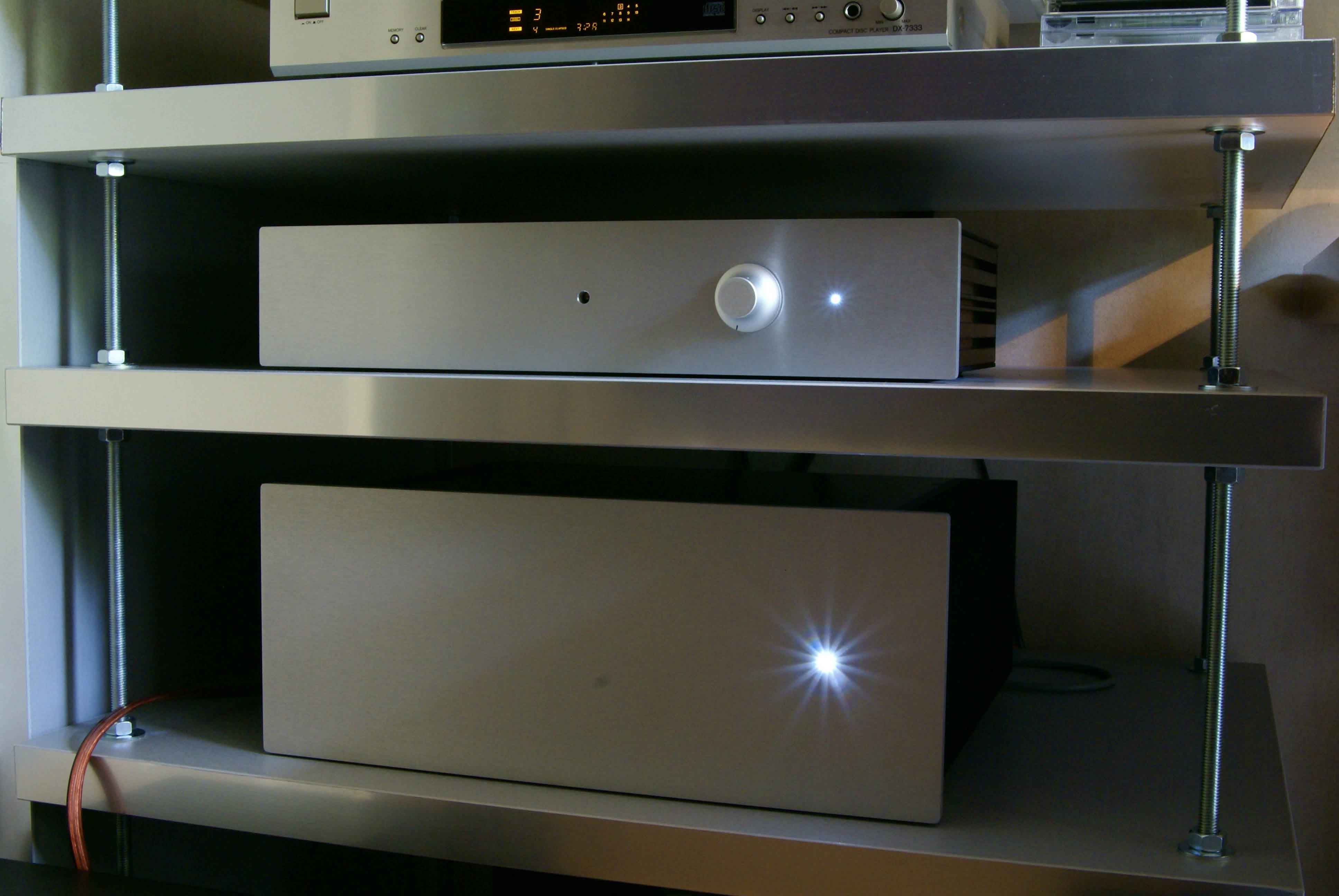

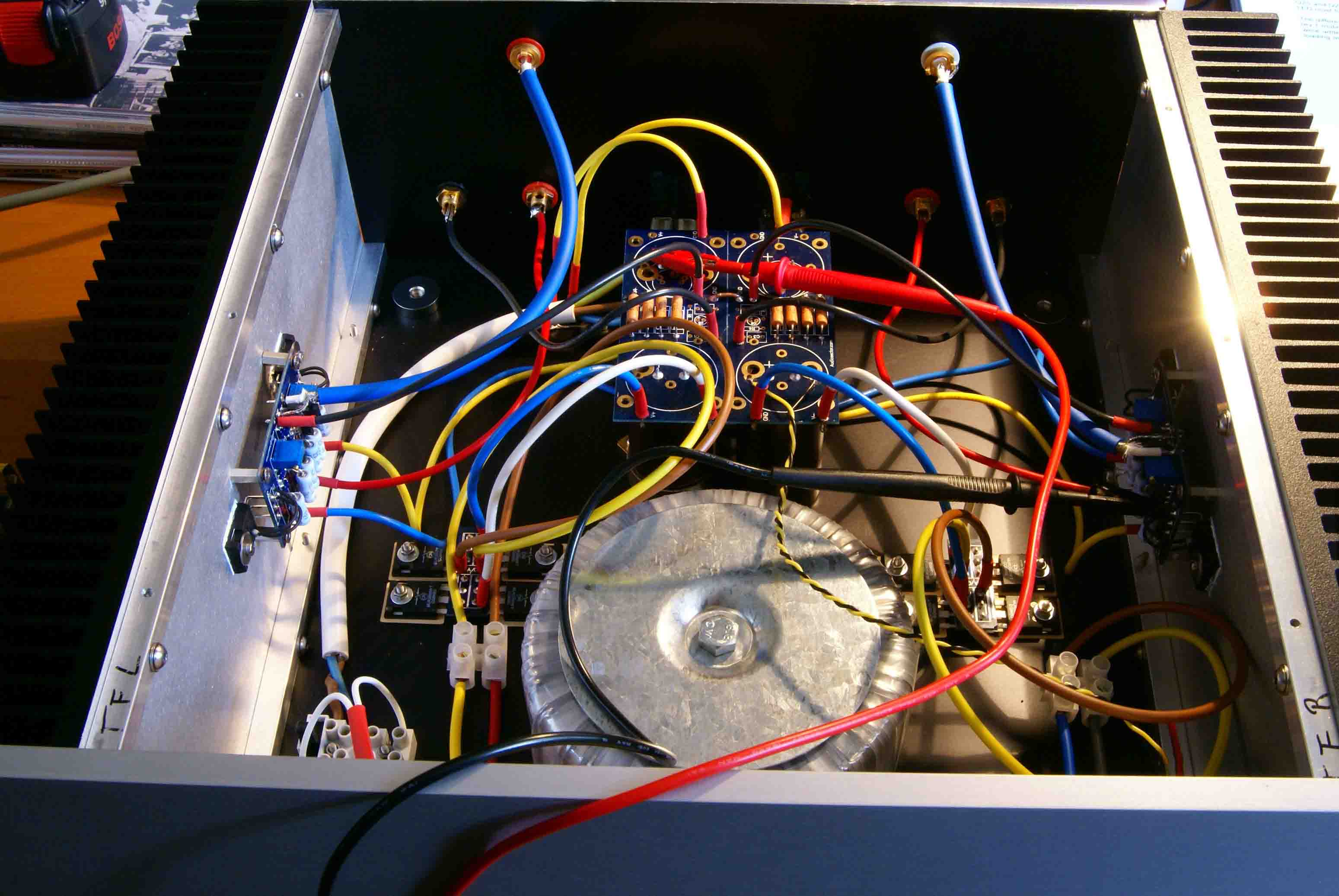

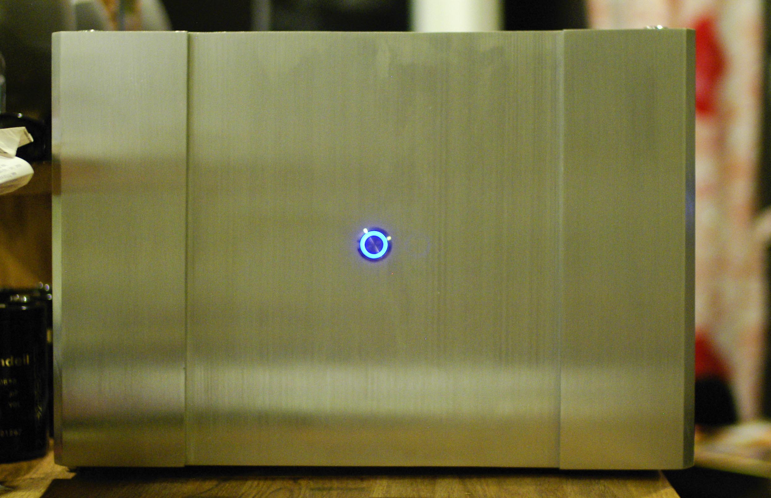

An other B1 and F5
And a wonderfull sounding B1 an F5 working together.
I am not shure wich selector switch I will use so I leave open for now.

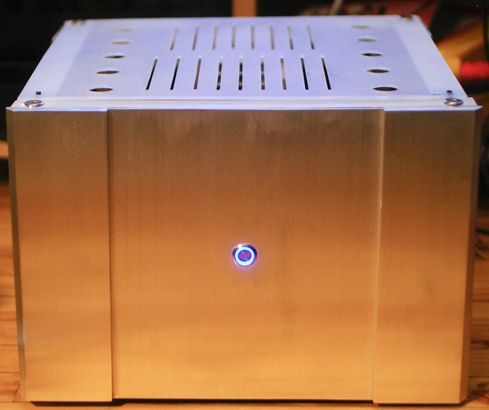

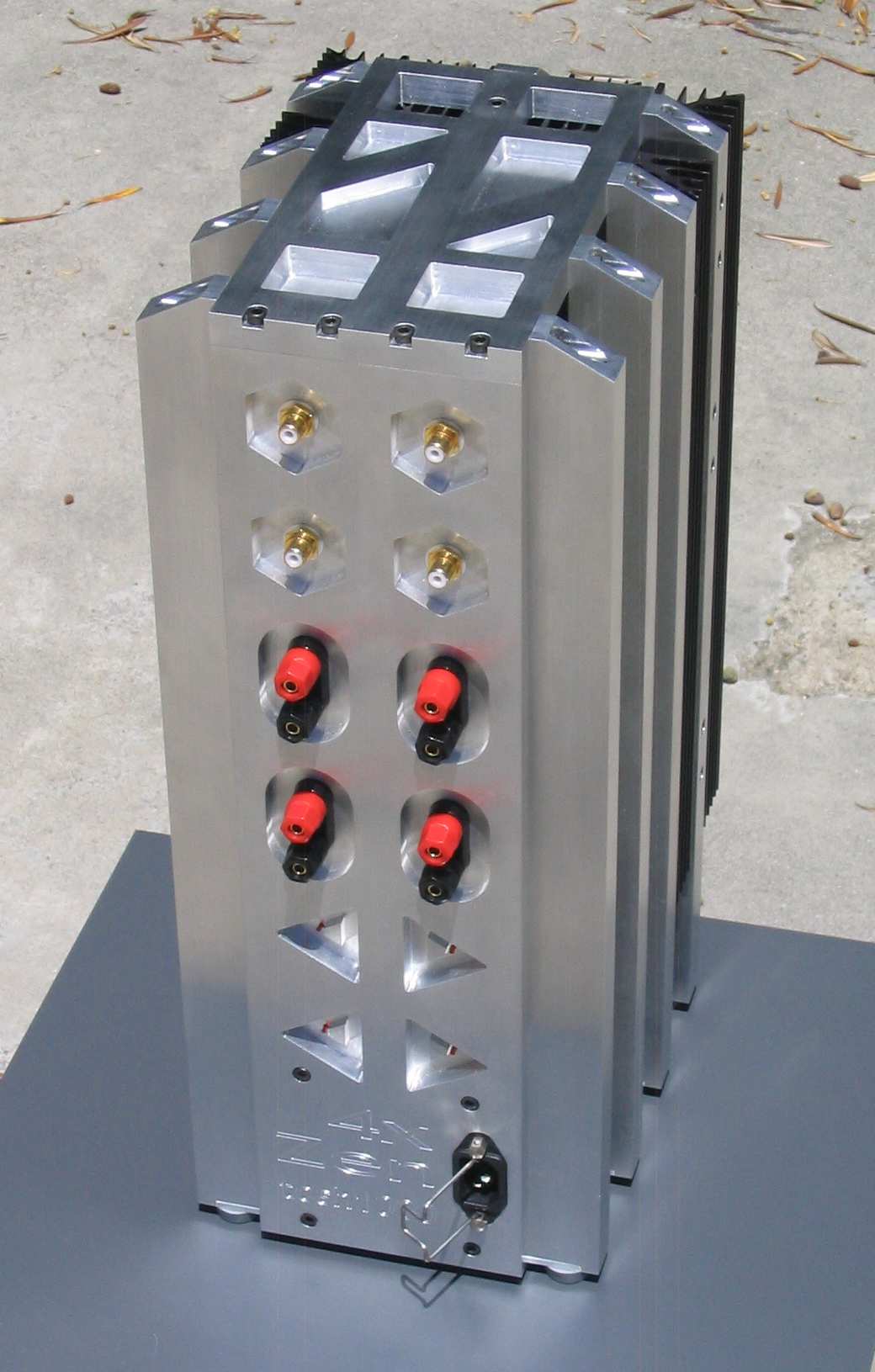

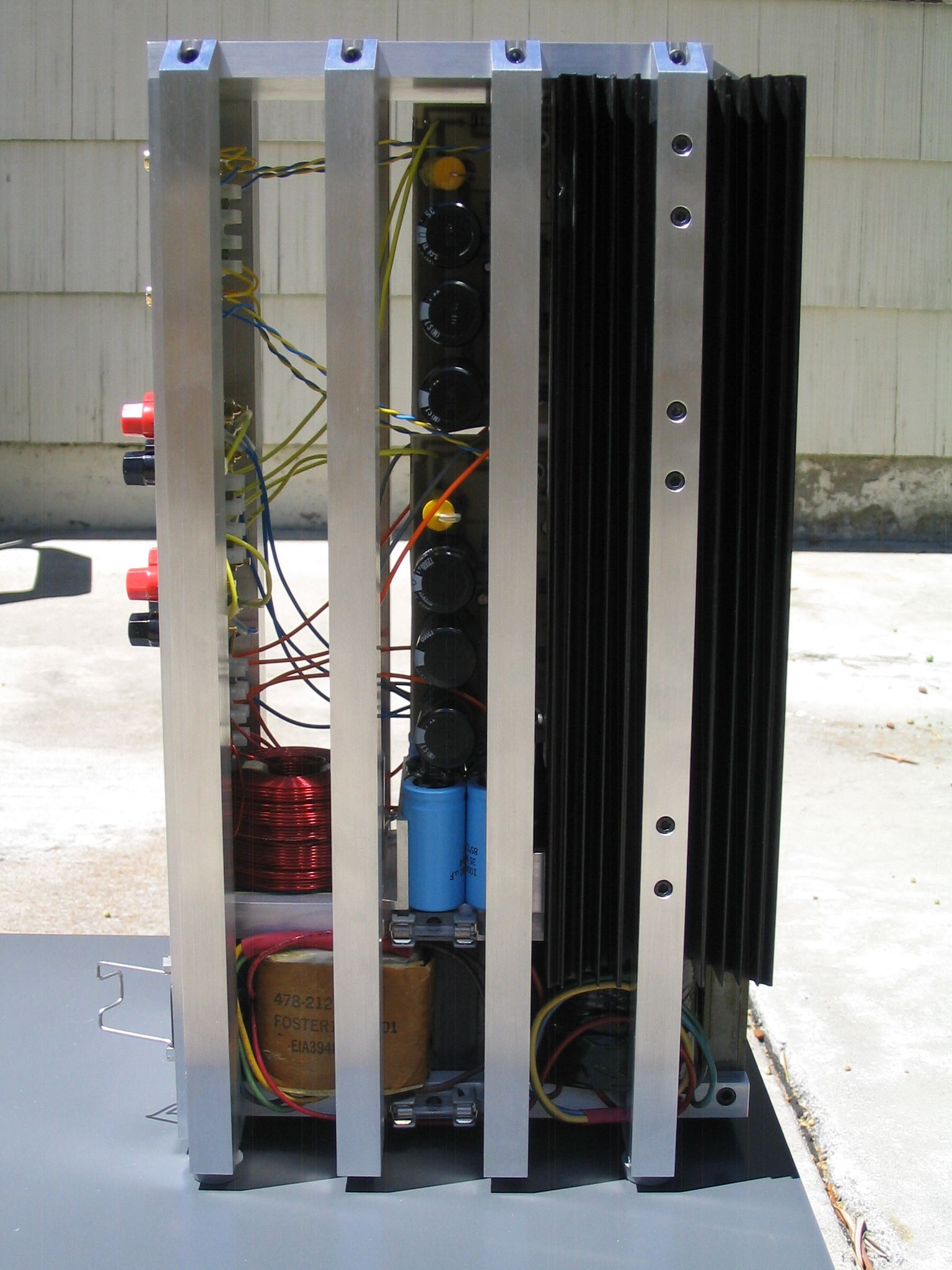

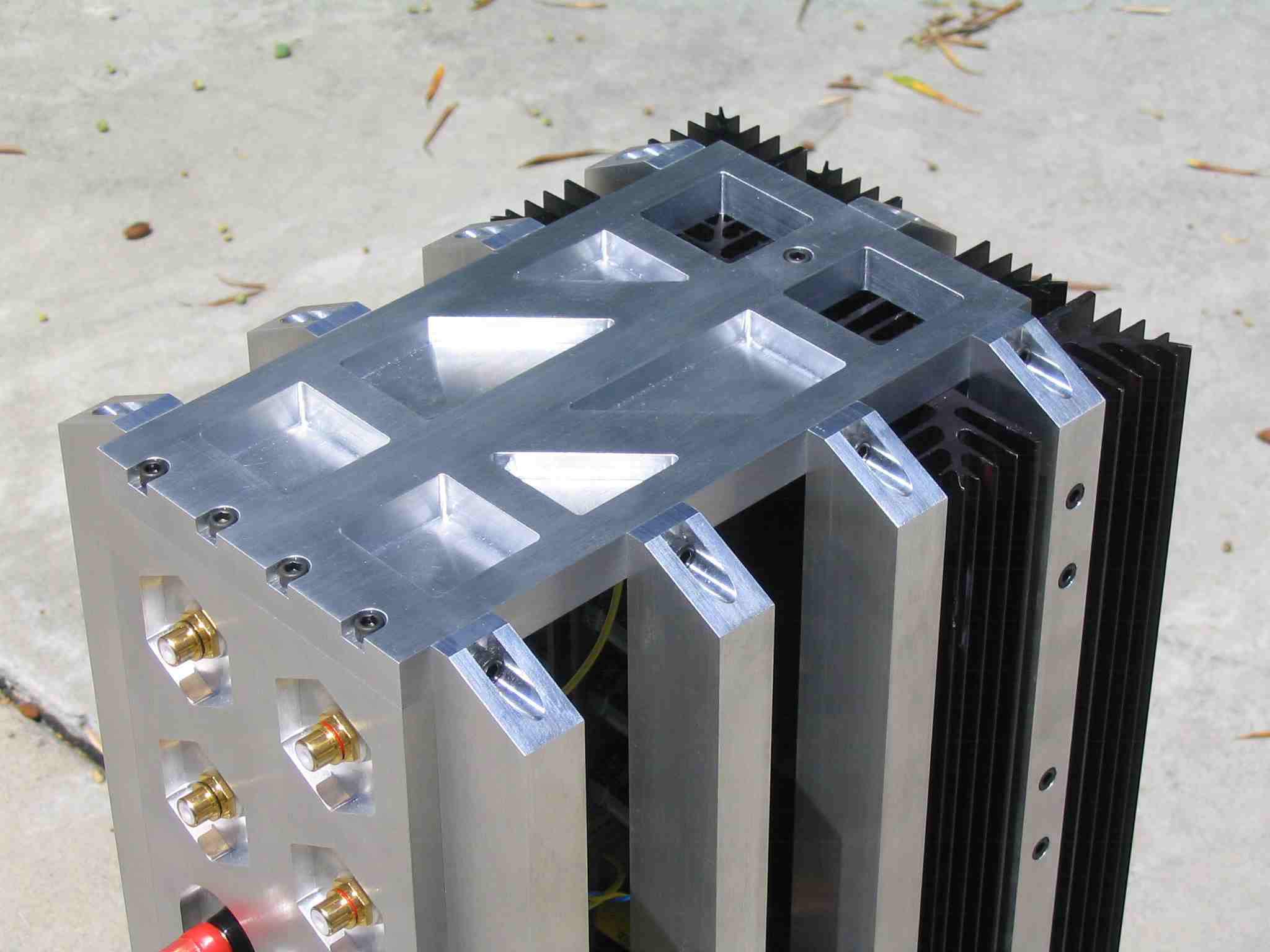

4x Zen: Designed in SolidWorks and made on CNC mills at De Anza College, Cupertino in 2007.
