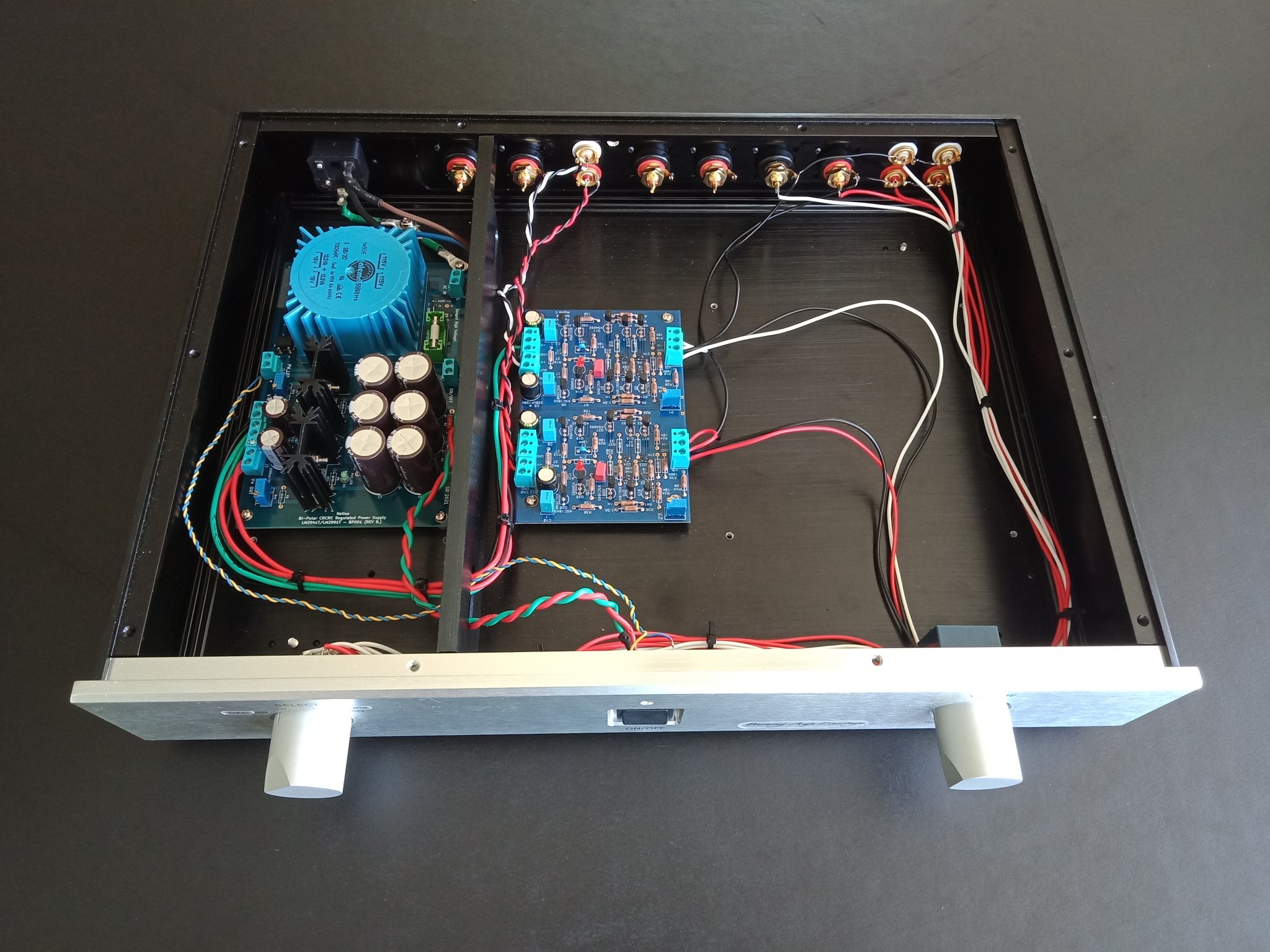

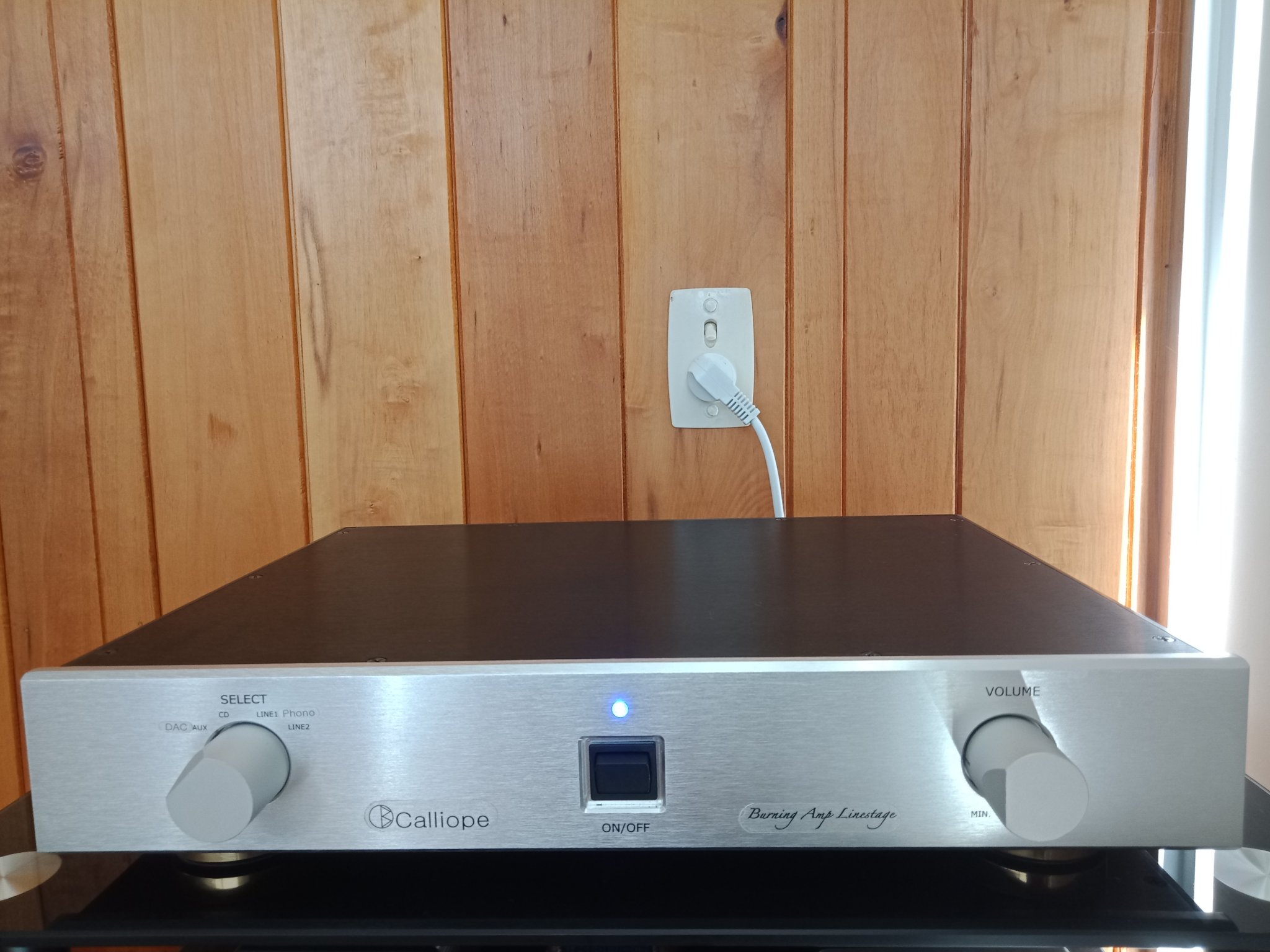

Is there an advantage of running these balanced outside of the xls? That looks really nice! Where did you get the Chassis? Are you happy with the quality?
In terms of sound, I don't think there is (single ended = 2nd order harmonic, balanced = 3rd order harmonic I believe). The main reason was that originally I was using an ACA (originally) and 86dB drivers, and I wasn't sure if I'd have enough puff. Going balanced would mean higher output. But with the Aleph J I have way more volume than I need, so for now I'll stick to single ended.Is there an advantage of running these balanced outside of the xls? That looks really nice! Where did you get the Chassis? Are you happy with the quality?
It's a cheap(ish) Chinese chassis off eBay. They always have quirks (this one had a front panel power switch that didn't fit, and unusual XLR mounting hole spacing), but the quality is fine.
Thanks!Nice name for your builds, Καλλιόπη, muse of poetry, with "beautiful voice" 🙂
Thanks. I am getting a DAC (D90) today with some balanced inputs and had thought about going down the XLR road. From what I understand, it is a good idea to have the preamp far away from the power supply section. However, if you're not getting any noise, I suspect it isn't a problem.
Cool! I covet the D90... looks like a really nice DAC. I'd be interested in how you find it.Thanks. I am getting a DAC (D90) today with some balanced inputs and had thought about going down the XLR road. From what I understand, it is a good idea to have the preamp far away from the power supply section. However, if you're not getting any noise, I suspect it isn't a problem.
You can't really see it in the pictures, but there's a 5mm thick wall between the power supply and the preamp board (it came with the enclosure). I think that might be taking care of any power supply interference noise? Anyway, it's quiet enough for me.

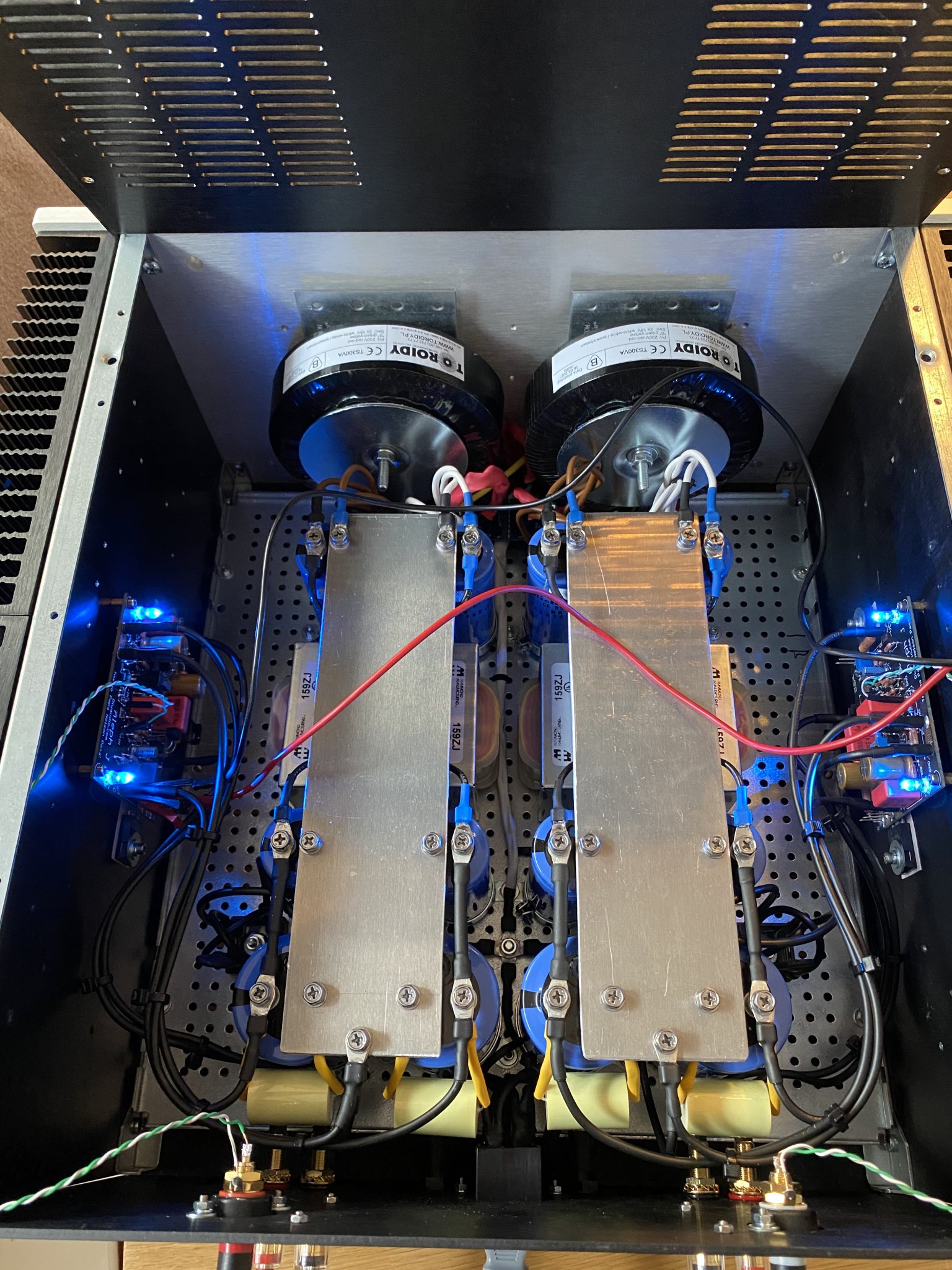

Probably a specialty of the alepgh, but—what are those wires (1 black, 1 red) going from left to right channel?

I use the PSU to power my workshop too, so I am tapping off the source resistors
Just measurement wires. Will do some clean photos.
